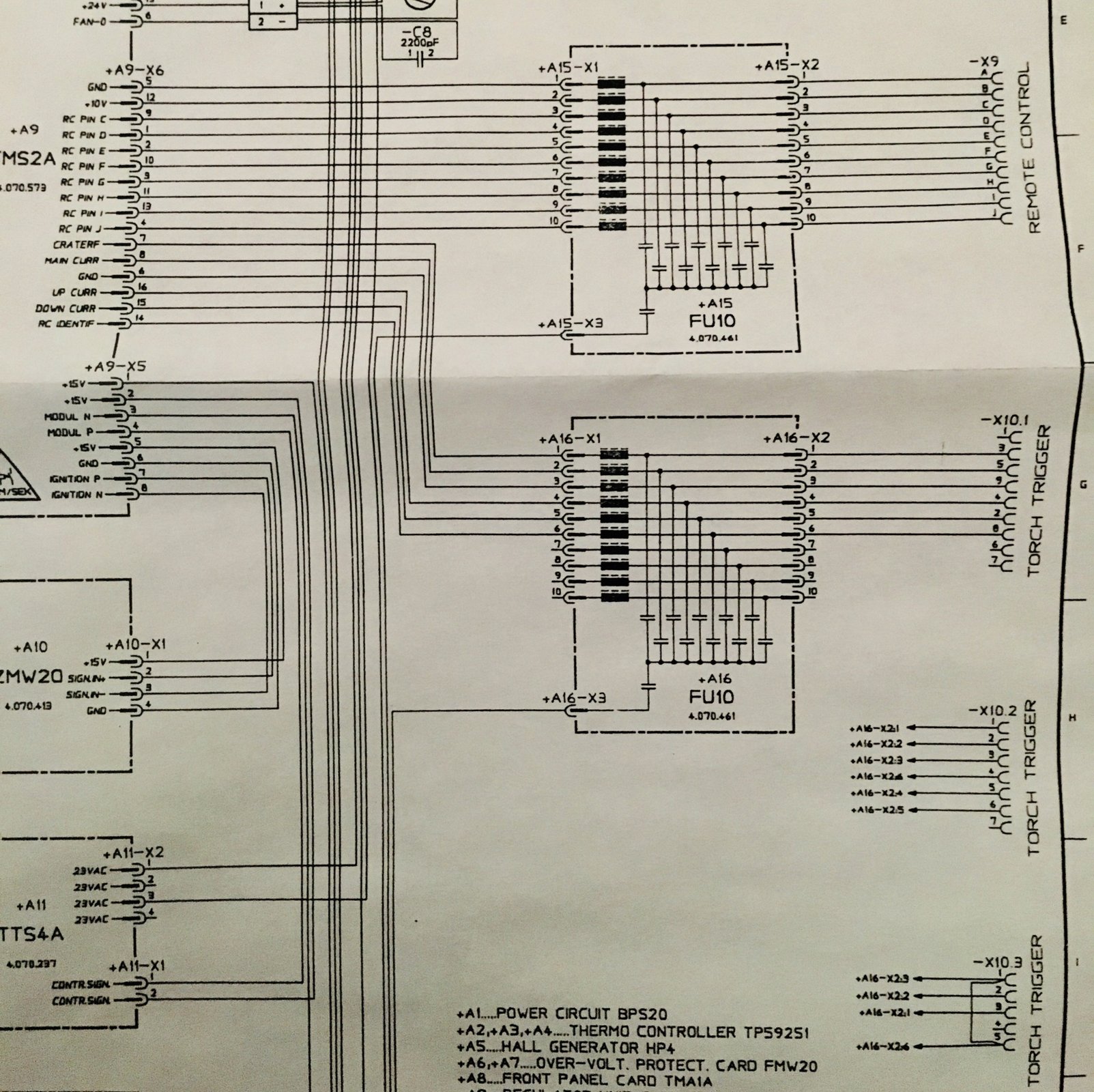

On the standard Fronius cable all 10 pins are connected both endsCan't get that to work, when I switch the machine on the HF starts with the plug connected and there is no response from the machine when the pedal is pressed, do you know if there are any links inside the plug on the machine end of the Pedal cable??
Rgds
Alex
It’s a 10 core cable no pins linked out. It only uses 5 for the pedal but it’s used for other remotes so all pins are connected. Sounds to me like the pedal might be faulty.
If the hf starts then it sounds like the switch is stuck on or shorted.
