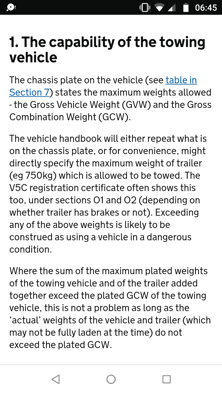

It is a minefield and info on official websites doesn't appear that clear, especially the maximum allowable mass thing, but the following page (section 1, last paragraph) clearly states your fine as long as the actual weights don't exceed the gross train weight ie actual mass is to be used, not MAM. There are other factors such as manufacturers specs, and towing vehicle/trailer weight ratios to consider too though before you go yoking a triple axle ifor to your Micra! It does mean that, if all other conditions are met, a 2 ton car with a 1.5 ton towing capacity and 3.5 ton GTW can pull a 3.5 ton plated trailer as long as it doesn't actually weigh more than 1.5 ton.
https://www.gov.uk/government/publi...towing-a-trailer-with-a-car-or-van-the-basics

1, IF you have a Cat B licence (post 01-01-97 & not taken BE test) you are limited by individual & combined plate weights even if empty & not be over loaded.
With this licence you are more likely to be held back by the sub 3500kg combined plate weights issue.
Licence Limits with B:-
Vehicle 3500kg
Trailer 750kg
OR
Combined plate weight of 3500kg IF the trailer is over 750kg
2, IF you have a Cat BE licence (pre 01-01-97 or taken BE test) you are limited by individual plate weights (but higher limits) & not be over loaded.
With this licence you are more likely to be held back by the real weights (unless towing say a farm trailer with a landrover).
Licence Limits with BE (excluding the C1 / C1E section):-
Vehicle 3500kg
Trailer 3500kg
3, there is a third type if you have a pre 19-01-2013 BE (free or took test) licence where the limits are different.
Vehicle 3500kg
Trailer unlimited
In case 1 you can not tow a trailer even if both are empty if the combined plate weight of vehicle & trailer total more than 3500kg unless the trailer is plated to 750kg then the total can be 4250kg.
In case 2 & 3 you can tow a 3500kg trailer with a vehicle that is only able to tow 1200kg as longs as the trailers real weight & vehicles real weight is under the vehicles GTW / GCW.
In case 3 you can tow any plated weight trailer as long as the real weight is within the vehicles GTW / GCW.
The biggest issue here is the braking system must not be over run type if trailer over 3500kg plate weight.
People are confusing LICENCE law & C&U Law.
You have to comply with both with both types of licence.
Vehicle capacities use REAL weights
Licence capacity uses PLATED weights.
This is 100% correct.

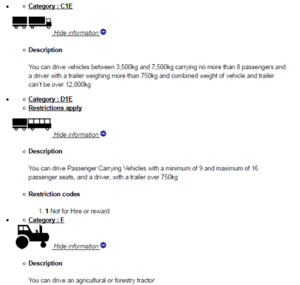

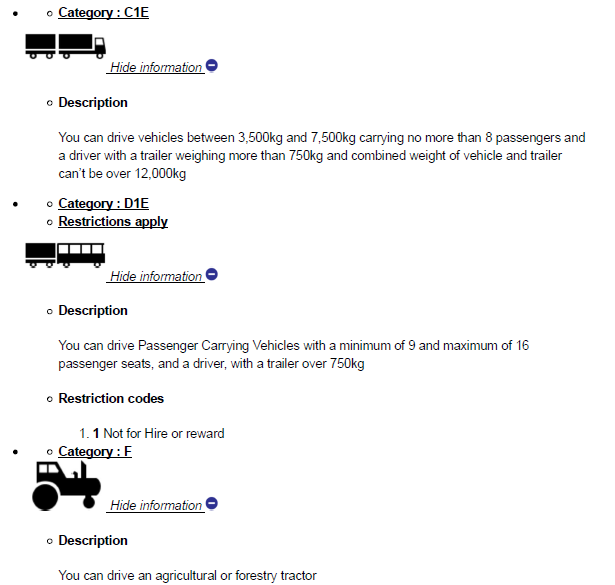

I'm pretty sure that on a pre 97 licence you can actually have a MAM of 8250kg whereas on the post 97' B+E it is 3500 + 3500
That is an often misquoted reply.
The 8250kg is actually for the C1E 107 restriction part of the licence. It only applies IF the vehicle is over 3500kg.
On your pre 97 no test BE & pre 19-01-2013 BE with test the regs are a vehicle up to 3500kg & an UNLIMITED trailer plate weight.
The reality is that very few sub 3500kg vehicles are rated for over 3500kg & if the trailer is over 3500kg then the brakes must be of an active type like air brakes not over run.
The most common combo is an older landy that can tow up to 4000kg with active brakes.[/QUOTE
