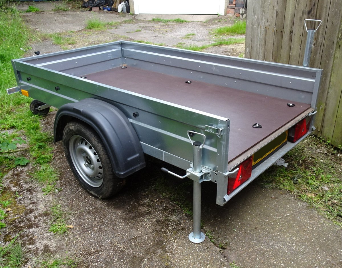

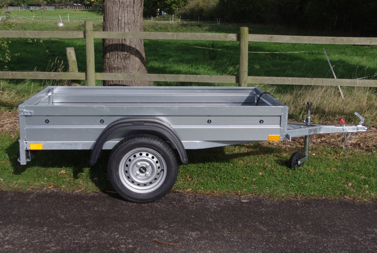

I bought a 7' x 5' trailer to move my engines about as I could only get one in my little Erde trailer
Trailer as bought

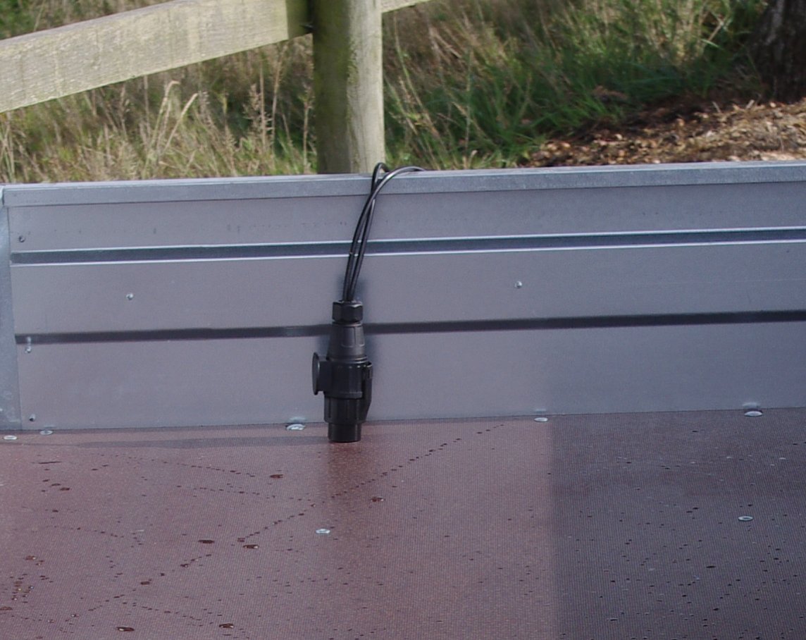

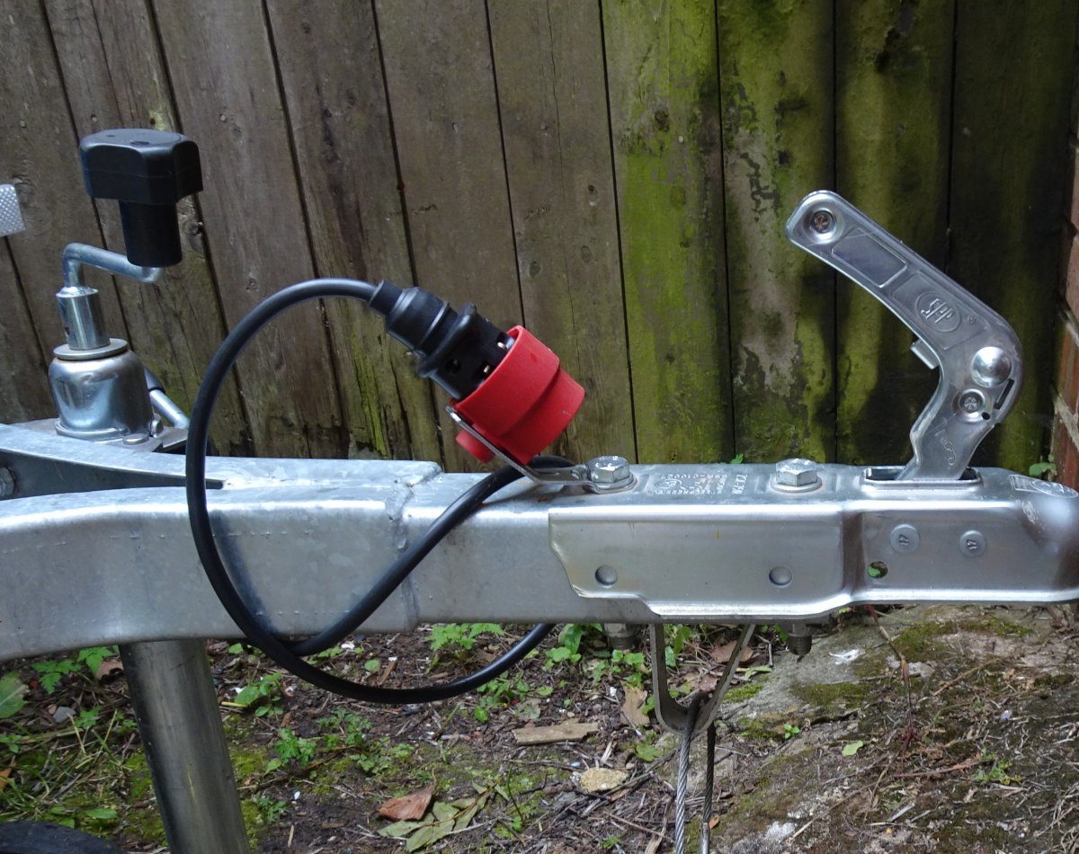

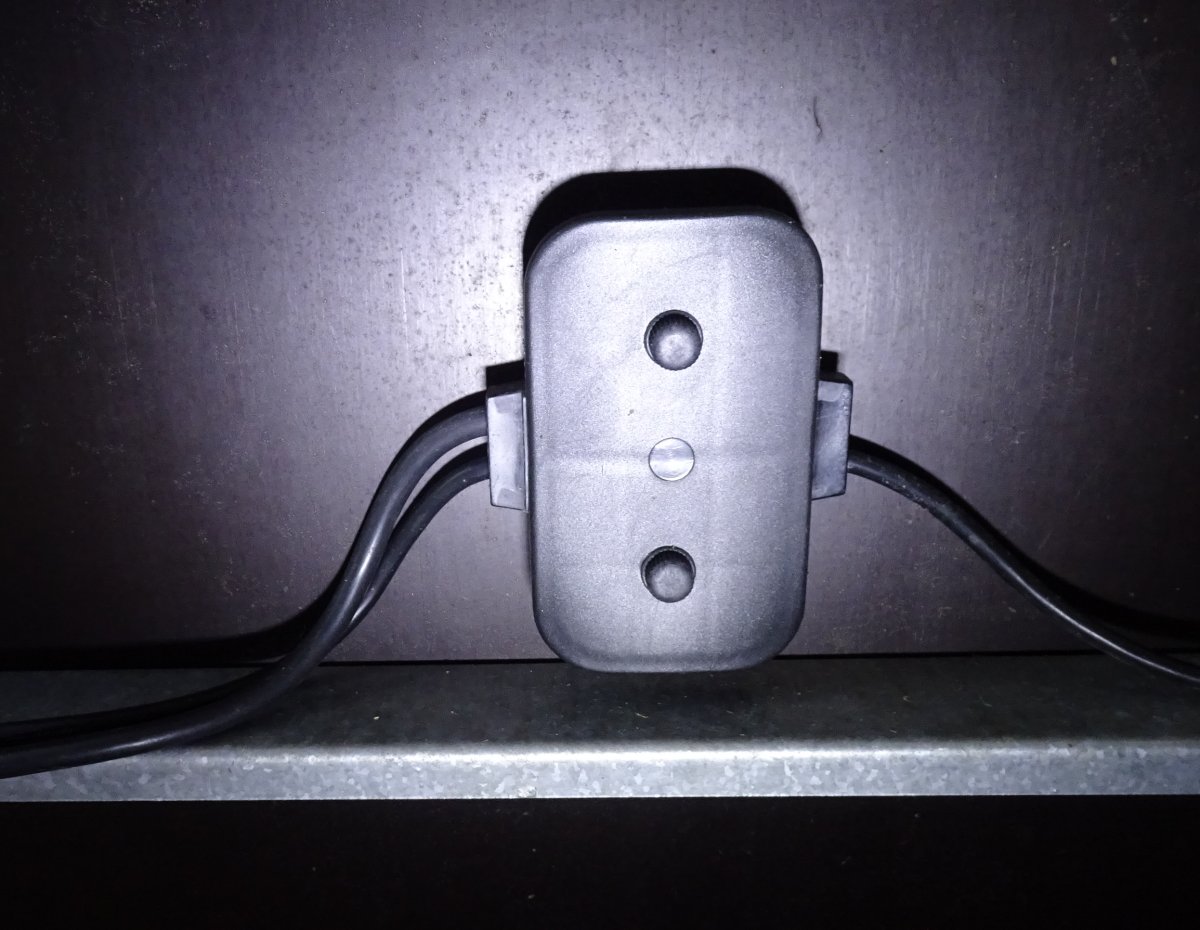

Re=-routed the 2 cables into a junction box under the floor
And fitted a 7 pin plug onto a single multicore

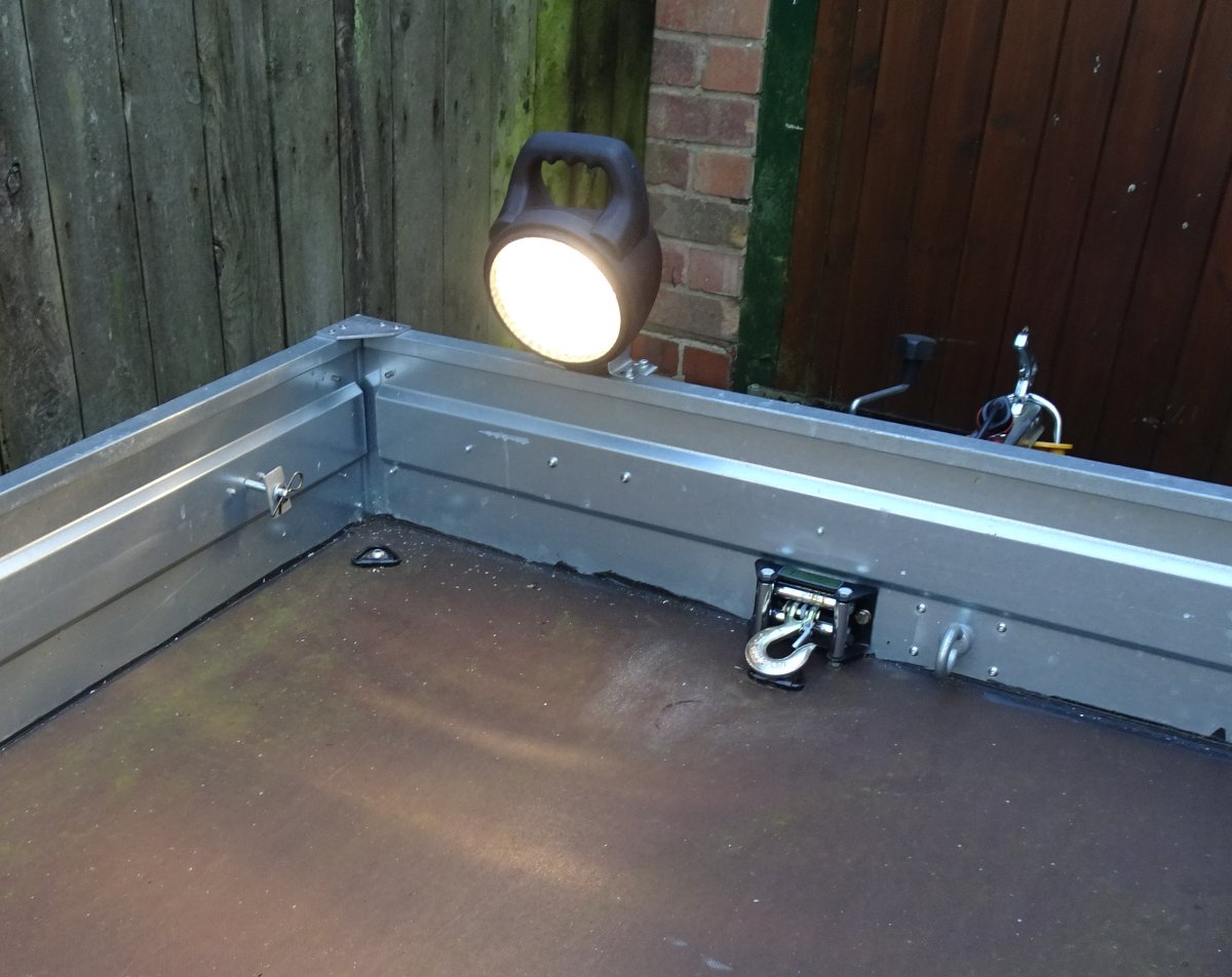

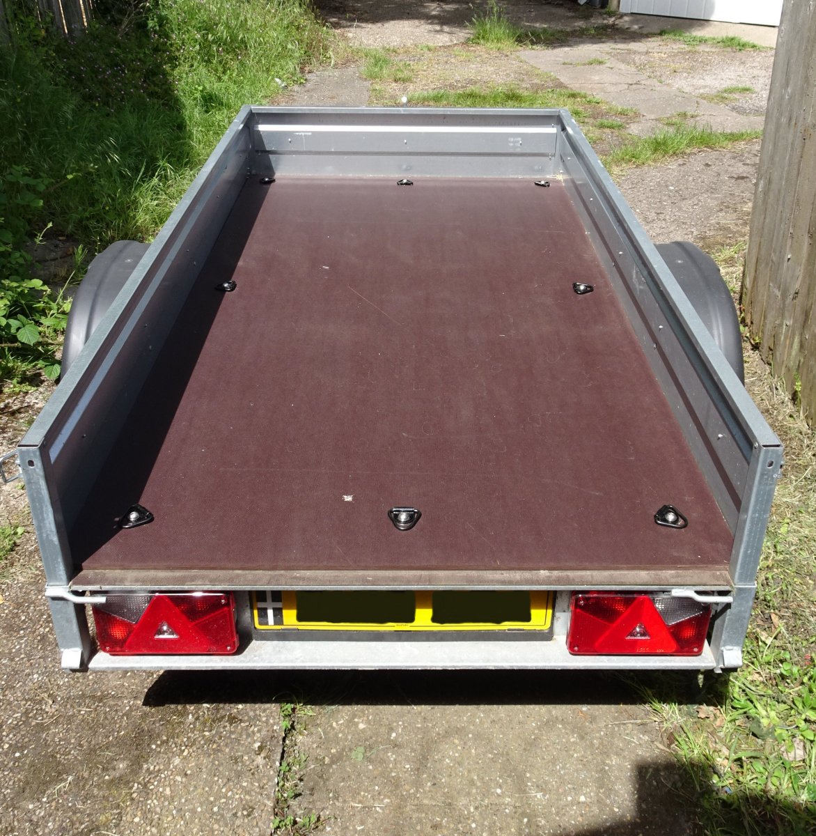

The deck was quite thin so I fitted a sheet of half inch Rhino board and some tie down rings

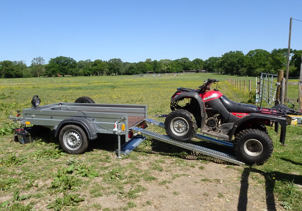

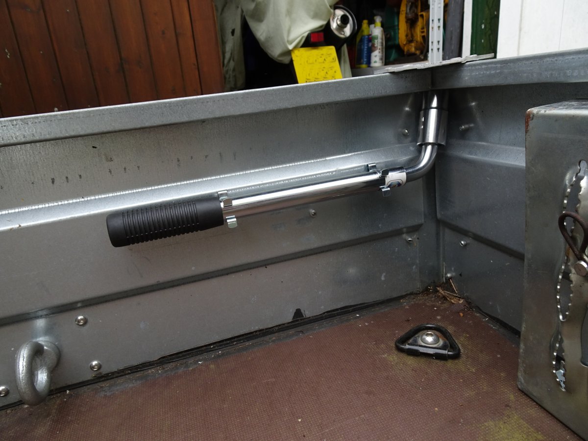

Couple of drop down legs to use when loading

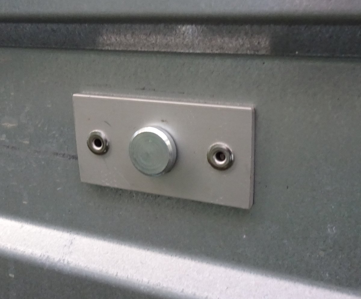

I did the same with mine as was sick of smashing them
