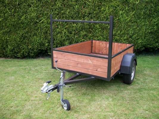

pedro - yeah wont be going over 750 with it, and have a cable fitted as well. I have never seen shock absorbers fitted to leaf springs?? Is this a new thing or where have you seen it done? Leaf springs by nature are normally self damping due the friction caused between the leaves was my understanding?

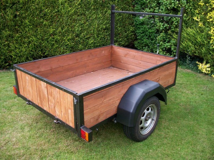

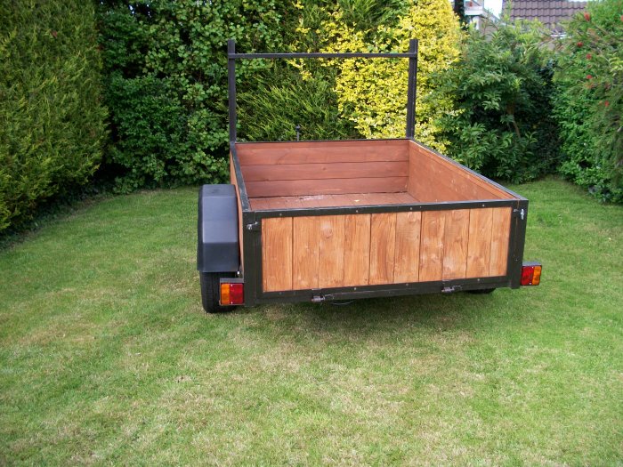

Ok I have been on and off here for a while and just havn't got round to putting some pics up of the finished trailer, got it finished around start of april, so thought i better get some pictures up before august!!! Anyway got myself a new camera today and was trying it out, So here is the finished trailer, have been using it a good bit already has come in really handy, tows really well and holds a lot of stuff!!

Look under any car with leaf spring rear axles, they all have dampers and bump stops fitted. 750kg is only the maximum, if your car weighs less than 1500kg it should be 50% of vehicle kerb weight. I've never seen trailers pulled and checked if they look decent but it's always a possibility.
Looks like a nice sturdy trailer. Dont forget though you need the red triangle reflectors on it to be 100% legal
