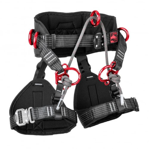

Converting this system, noting the central metal parts which shouldnt have, but do have, rough edges. It is making the webing fray. Note the main webing is not sewn to the harness, it threads through the side rings and around the back, which will aid replacement.All this does is allow removal/refitting of the straps into the ring? It doesn't provide any thing in the way of safety in a fall.
If the bolts failed the system would open, and I'd fall to the ground.All this does is allow removal/refitting of the straps into the ring? It doesn't provide any thing in the way of safety in a fall.
I am aware of these facts and I put considerable effort to ensure I know far more detail in the subject as my life depends on it. I find it funny how climbers generally trust their employers to maintain kit and I have seen the stateffor some of it. I know the history of my kit..Arrr,,,, the fabled "LOLHER Inspection" completed by someone who has shown a basic understanding of mechanical inspection and HSE Law, that has pasted a very basic test....
