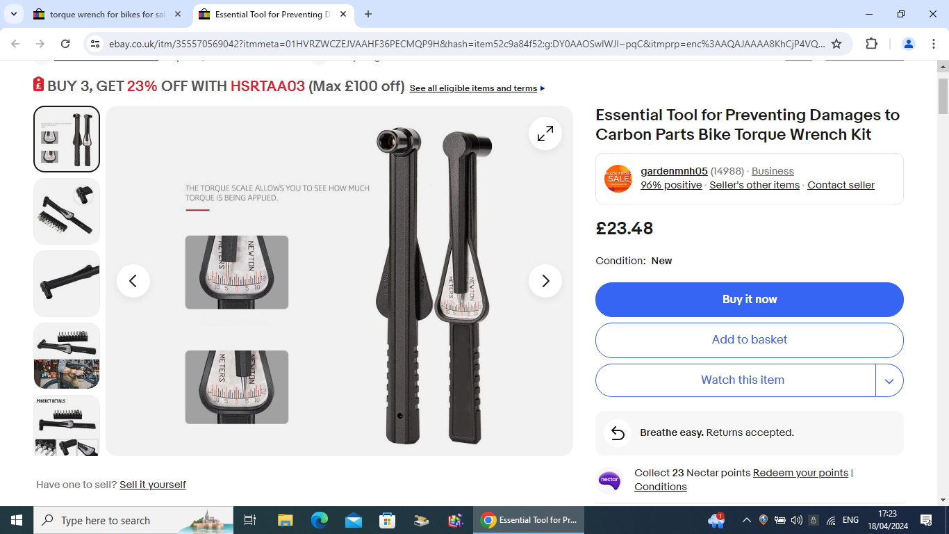

I need to do up a pair of bolts to 2.5nm, relatively important they are done correctly and not over torqued. I belive my torque wrench starts about 5nm and even then, I dont like to trust the clicky things, and dont want to buy another for a one off.
Plan is to allow gravity, a lever arm and a precise weight to do the task. However I seem to be getting confused with mass and weight when converting my 2.5 newtons into grams.
250 or 2500 grams at a 1 metre arm?
