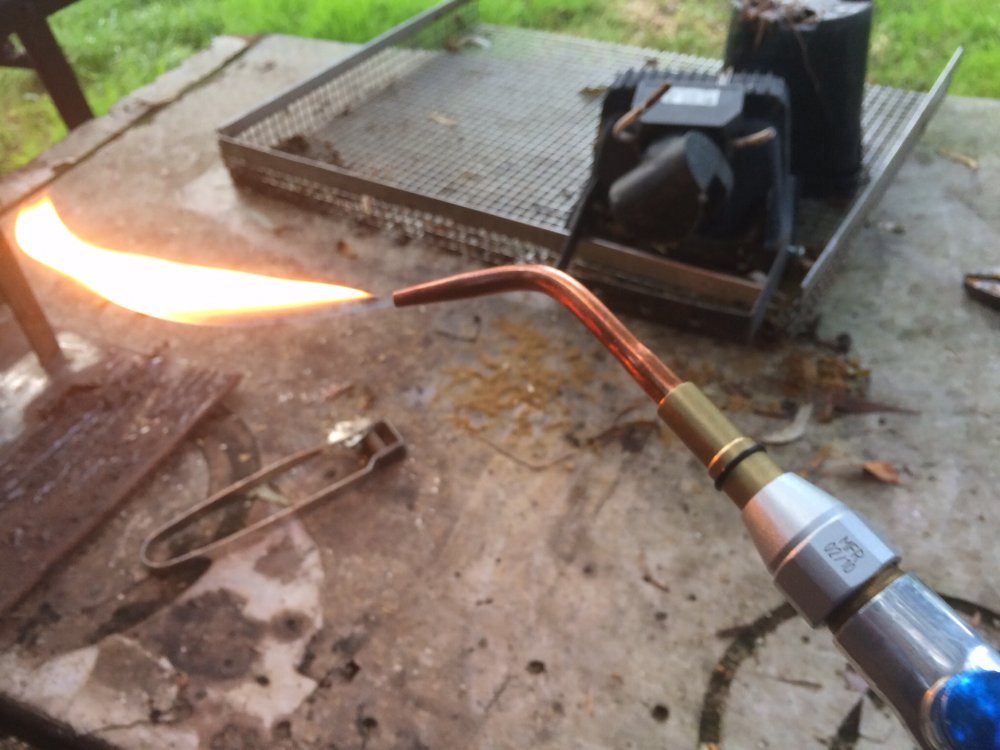

just doing sanity check...yes got brand new flash backs and hoses....Regs are only about three years old
HurrayPropane regulator if it had a gauge fitted it would only be one (out), bottle pressure remains more or less exactly the same from the beginning to the end (the only way to gauge how full it is, is by weight).
Oxygen might have two gauges (one for the bottle pressure, one for out).
Forget the gauges for the minute - let's establish you are using the regulators correctly:
I suggest close both of them (by unscrewing them totally) and just crack a bit of a turn in
then see if you can light propane OK?
ps
how old are these regulators? (you know they are "lifed"?)
are you using flashback arrestors?
Nah, H&S consultancy in heavy industrylet me guess - you are fireman![]()
Hurray
Getting somewhere now, I opened up the torch to full on propane and then cracked reg so I could just hear gas comming through then closed off at torch. Did the same with oxy and guess what the propane lit first time and when given oxy it produced a nice tight cone about 5mm long.
The flame seemed to be very under powered and there was no roar, is this normal?
Cheers fella, I'm a complete novice with anything gas and oxy. First time everand who says it cannot be done?
propane u can get .they will do all the pressures u require i was using burning regs for a few years till i scored a new ish set that was 35 years ago .and still going strong
up the regulator pressures slightly then and u will only need to open torch controlls half wayShould have said both torch controls were fully open to get the flames in the pictures
