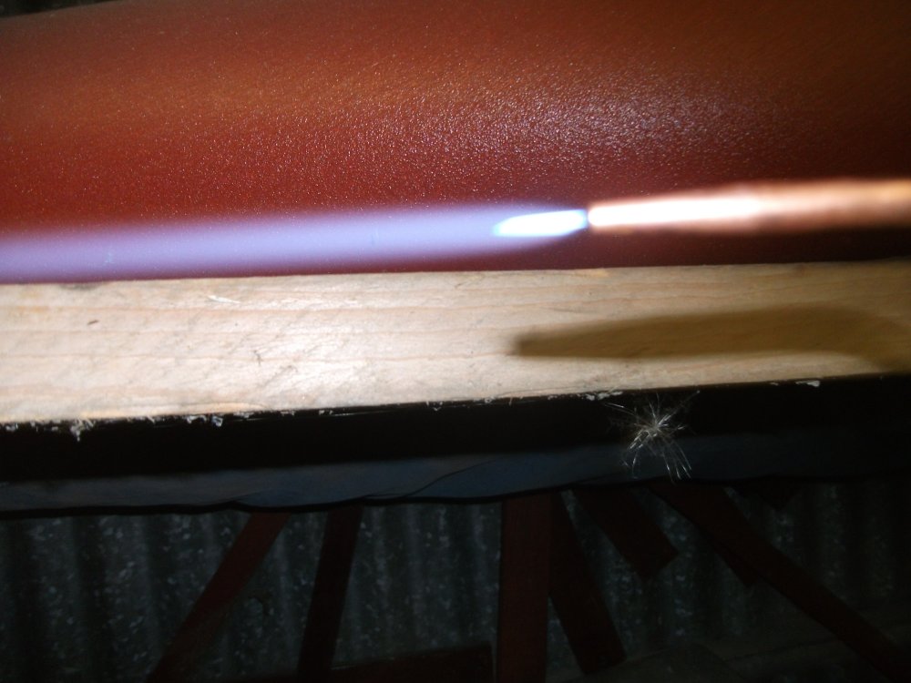

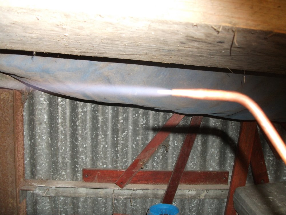

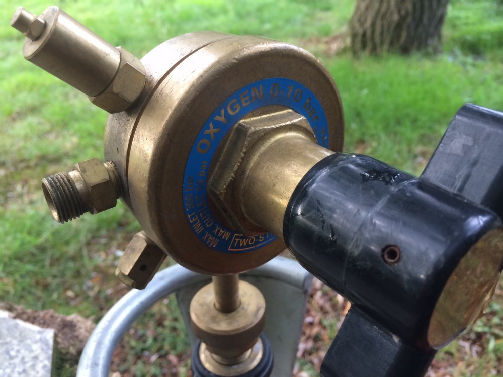

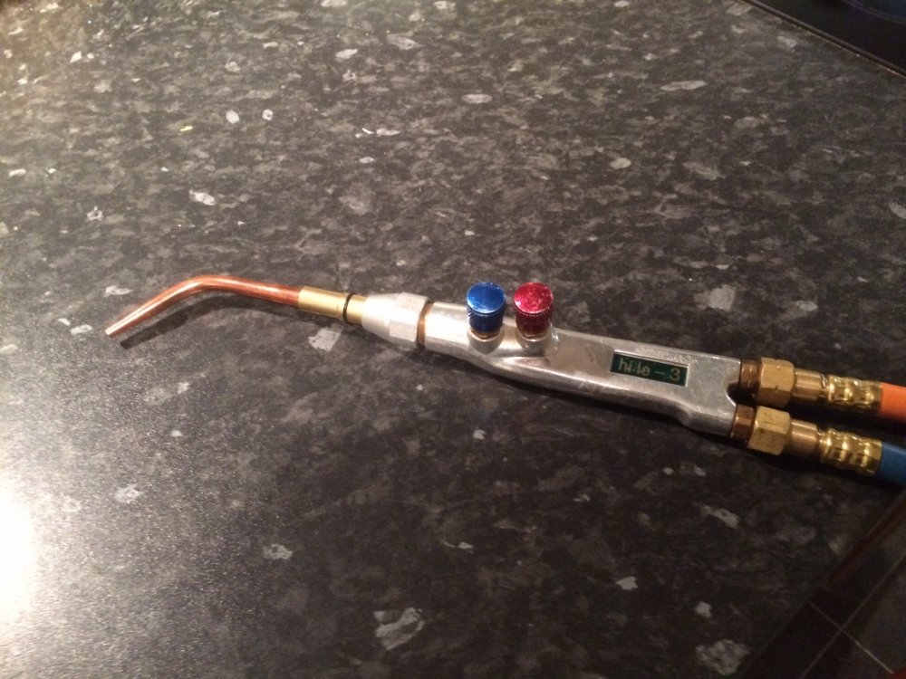

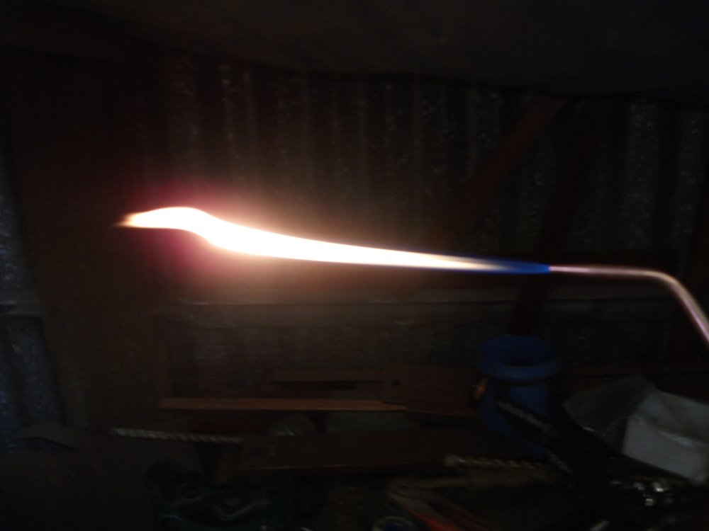

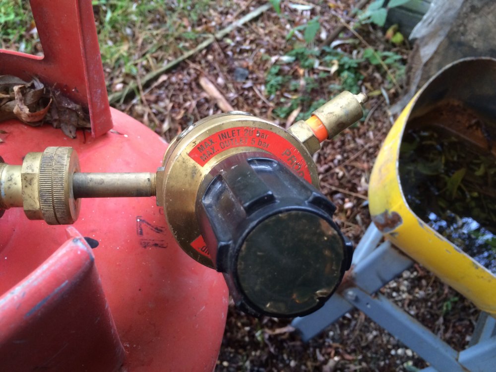

I don't have any pressure gauges on the regs so have no way of checking or setting accuratelyWhat pressure setting do you use for propane and oxygen?
If your propane flame is away from the tip than it's too high - it could be crappy adjustment on the torch? too high pressure at the regulator.
Like brightspark says propane flame has to be connected to the nozzle, otherwise adding oxygen will snuff it out (you can increase/adjust things later).
BTW that's my settings:
Oxygen pressure: 11-12psi
Propane pressure: 5-6psi
