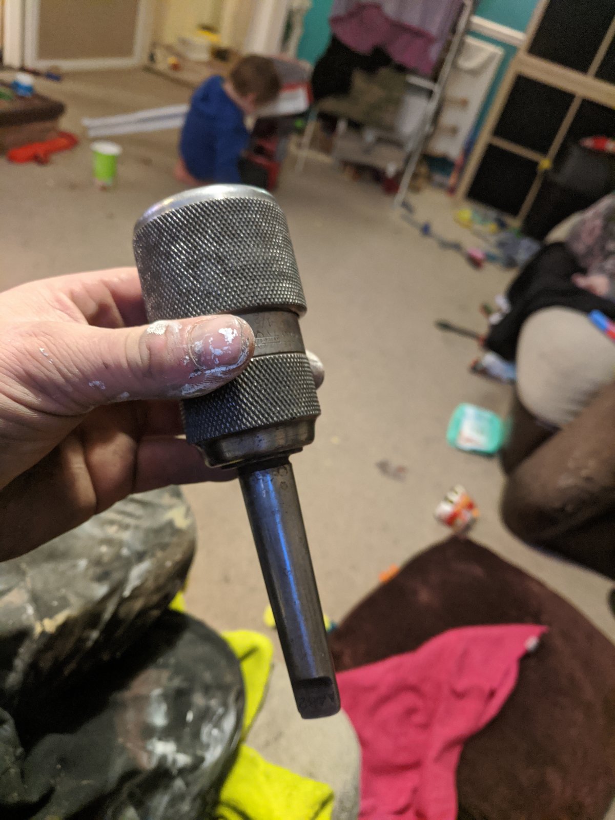

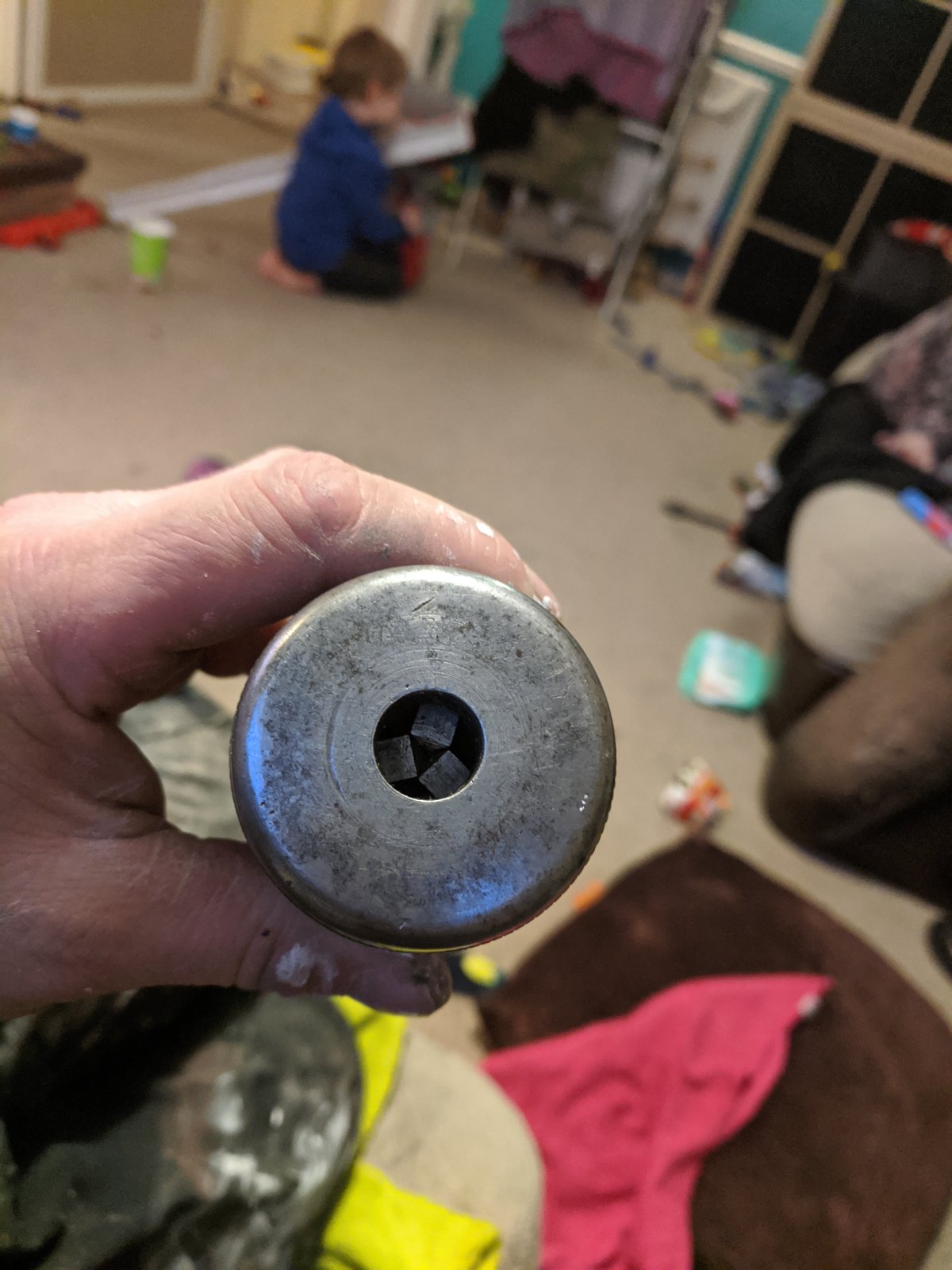

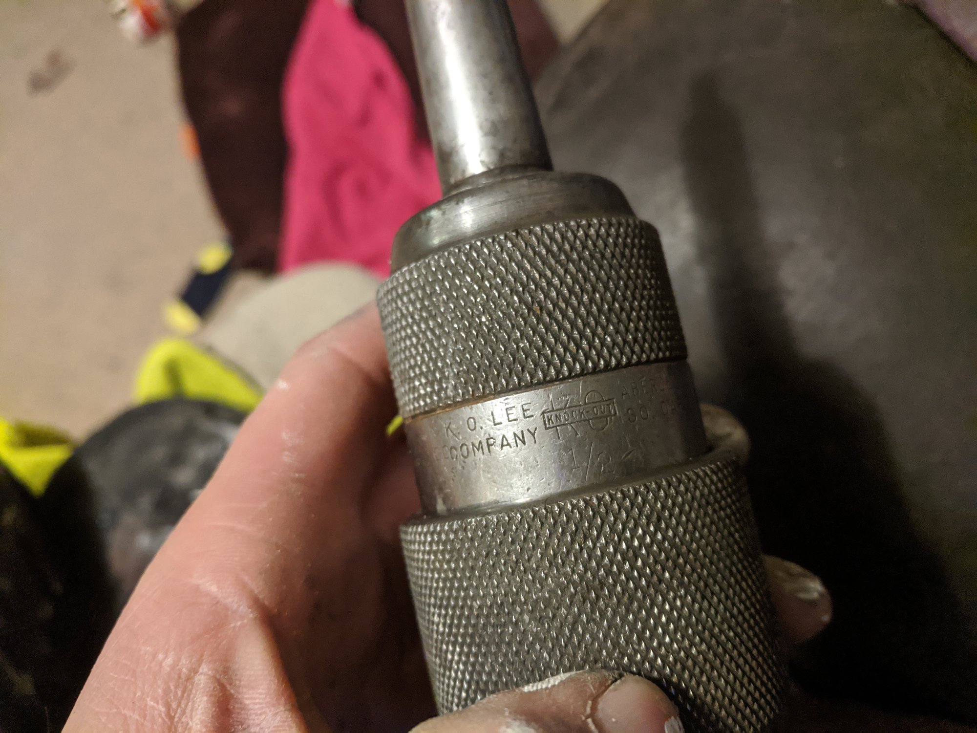

Thanks for the heads up. Stuck the minimum bid on it when you posted and forgot all about it. Won and arrived today.You'd need to check it's an MT2, but this looks good?
https://www.ebay.co.uk/itm/k-o-lee-Chuck-1-2-Lathe-Drill-Press-Milling-Engineer/114103899296?hash=item1a911f54a0:g:MtQAAOSw-s5dn6x4&LH_Auction=1
I'm pretty sure I have a spare chuck in the cave, but would need to check.
