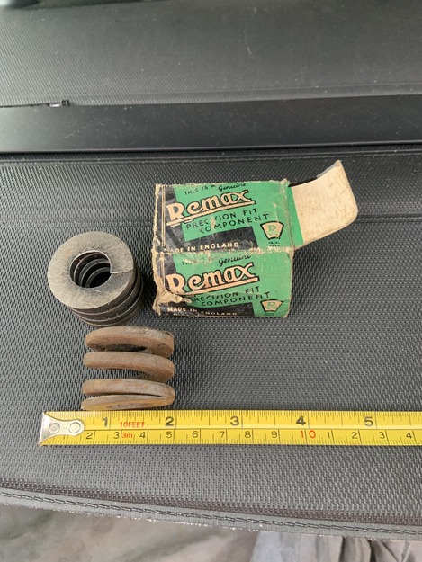

winchman Member Messages 6,359 Location Merseyside Jan 4, 2025 #1 Just Back from The Autojumble at York I bought a box of Jubilee clips for £2 and these springs are in the box any ideas what they are for?
Bullet2012 Member Messages 5,617 Location on average about 200 miles from the ISS. Jan 4, 2025 #2 Zebedee
johnik Member Messages 784 Location sunny Somerset Jan 4, 2025 #3 look like the springs on an inertia starter motor, goes dehind the bendix
Maker Most folk just call me; Orange Joe Messages 10,678 Location Keeler crater Jan 4, 2025 #4 Could be a die spring.
D dan treg Member Messages 517 Location uk midlands Jan 4, 2025 #5 from ebay Vintage NOS Remax FORD Popular Starter Main Spring SB9, Lucas 270326, 7W-11375 so starter motor spring or very similar
G GRW Member Messages 4,108 Location Wales, UK Jan 4, 2025 #6 My guess is the springs you find on some exhaust clamps, typically connecting a pipe flange to back box flange
M Melvyn Best Member Messages 2,102 Location Cambridge Jan 4, 2025 #7 Starter motor Bendix spring, think I still have the correct spring compressor tool somewhere?
octo0072000 Member Messages 6,023 Location south yorks Jan 4, 2025 #8 Starter motor Bendix spring by the looks of it old style non pre engaged type
