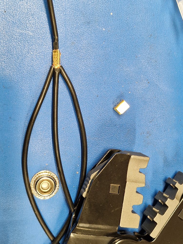

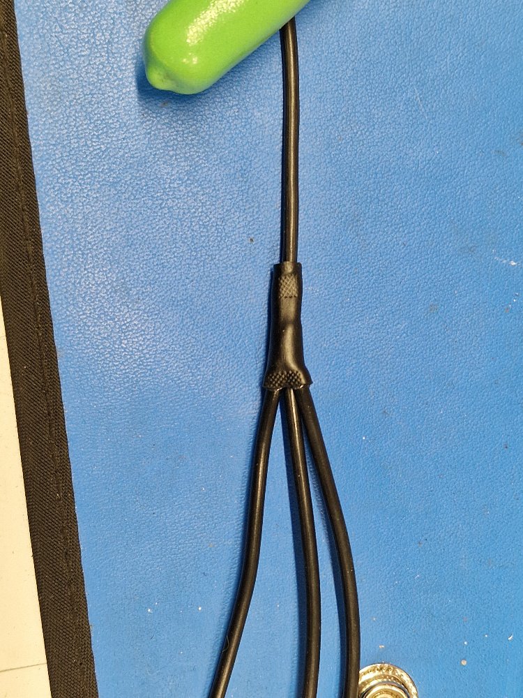

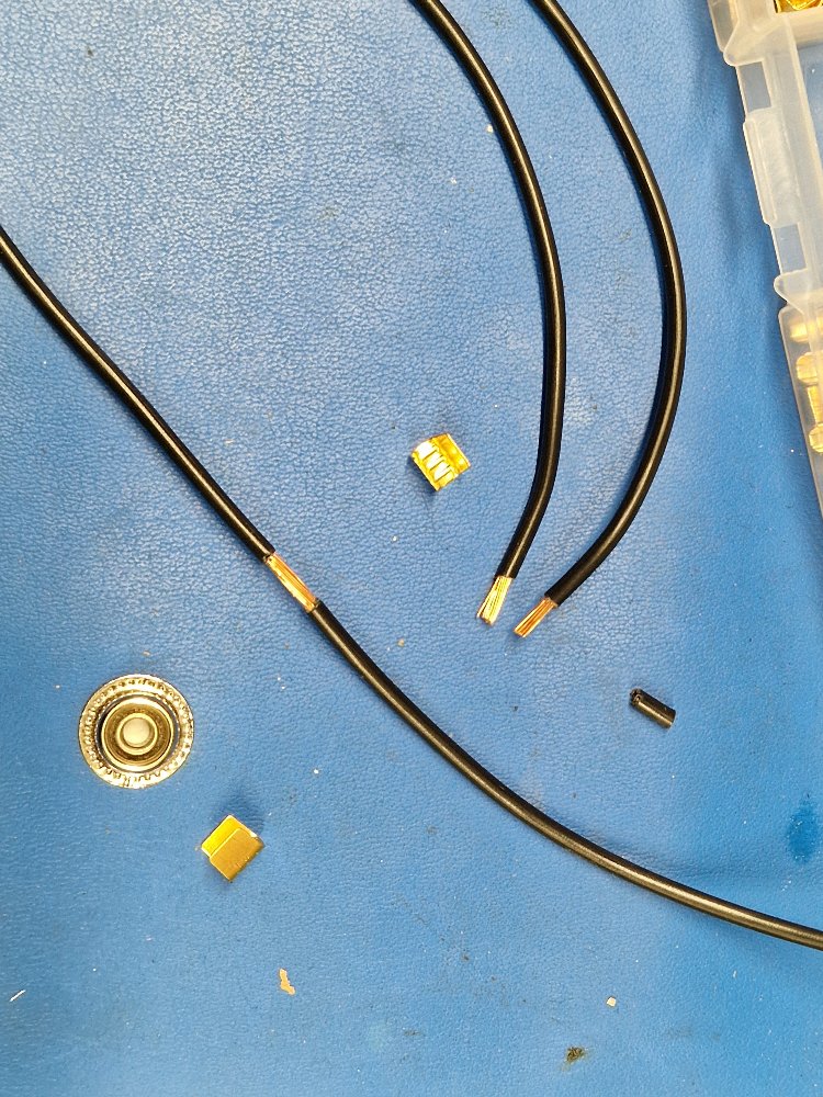

Making ground (earth) branches, in this case a split for the bar controls and instruments. A splice is used to keep connectors to a minimum. Strip the wires, crimp with a barrel splice, fit adhesive lined heat shrink for support and to prevent water ingress.
