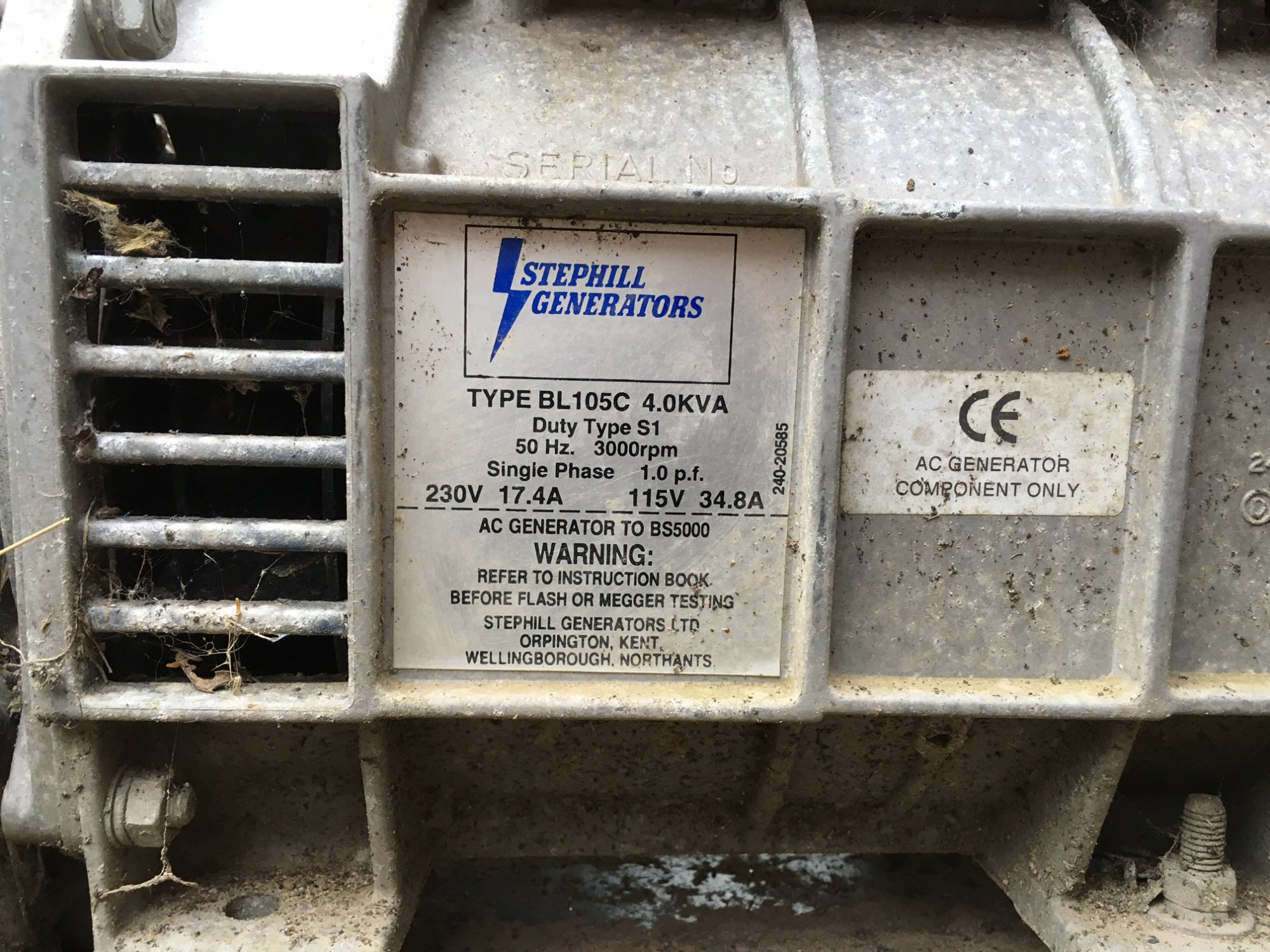

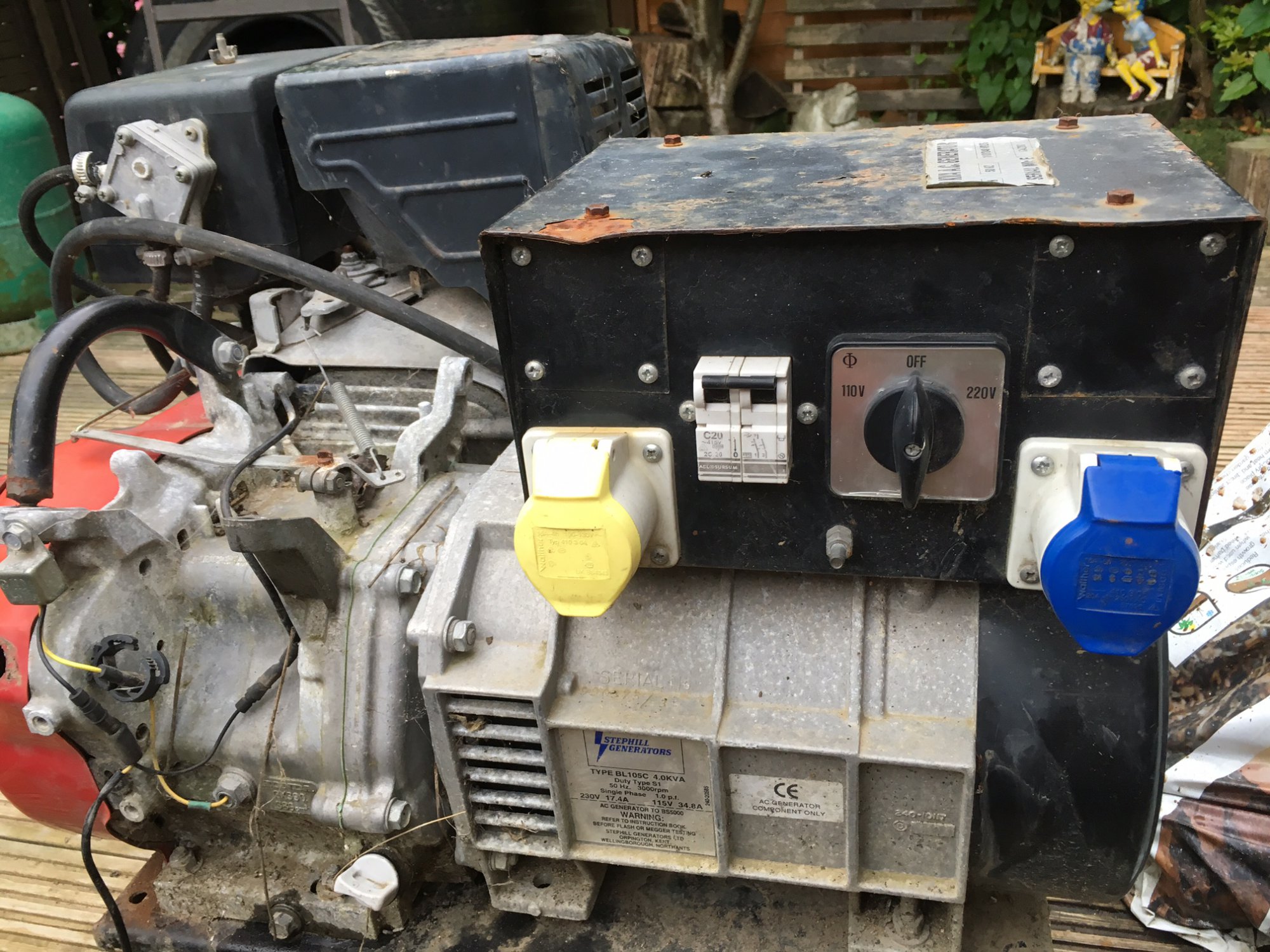

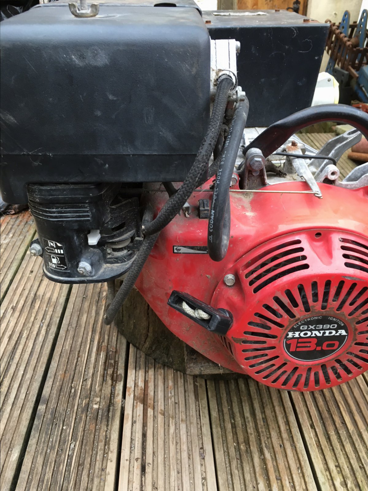

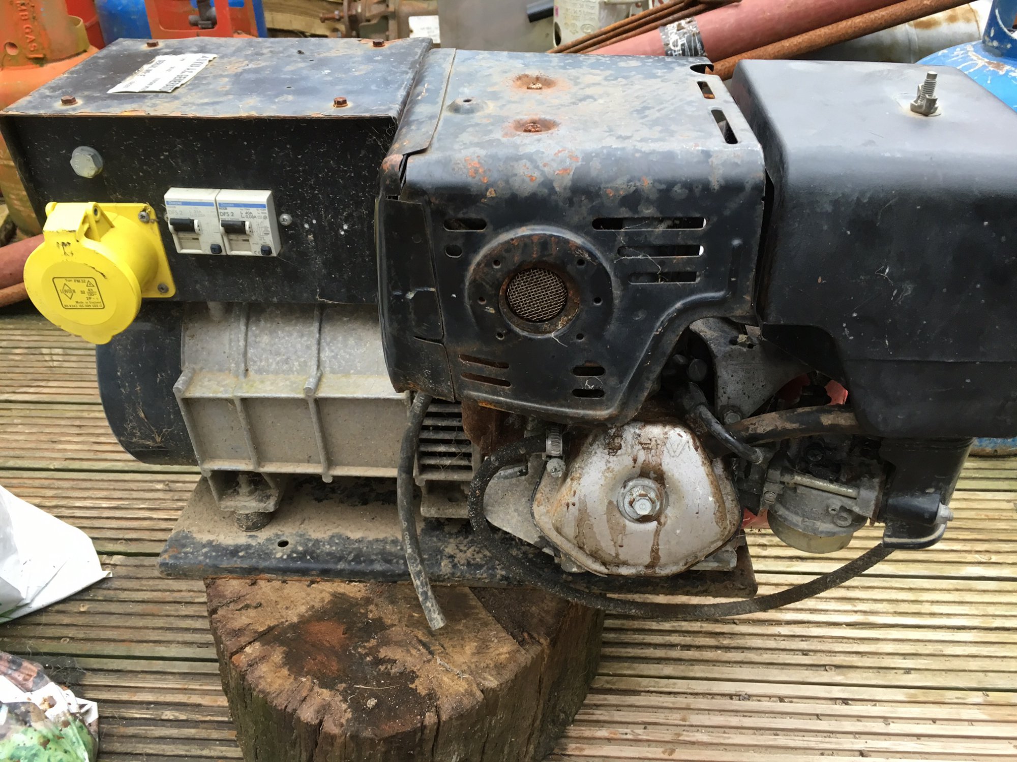

http://www.mig-welding.co.uk/forum/threads/generator-voltage-and-hz-meter.55615/Today I acquired for FREE a rather nice 13hp Honda 4kva Stephill generator that had been flood damaged but NOT while running. The owner found that the engine would not pull over so decided it was toast. I brought it home and drained the oil/water from the engine and then took out the spark plug and spun the engine over to remove the rest of the water in the cylinder, I popped the plug back in and it pulled over as sweet as a nut with lovely compressionI have now ordered a service kit from fleabay and all should be good.
The original fuel tank was removed for a long run fuel tank which I didnt manage to acquire but that is not a problem. For some reason the Stephill Genny does not have a voltage gauge on it so does anyone know where I could purchase one ?
View attachment 86265 View attachment 86266 View attachment 86267 View attachment 86268
Here's the same one as I bought:That was a bit of donald duck, i followed your link and it had a view similar items link what took me to this http://www.ebay.co.uk/itm/2-Voltmet...650082?hash=item43d0d85fe2:g:0oYAAOSw1x1UM5fb
