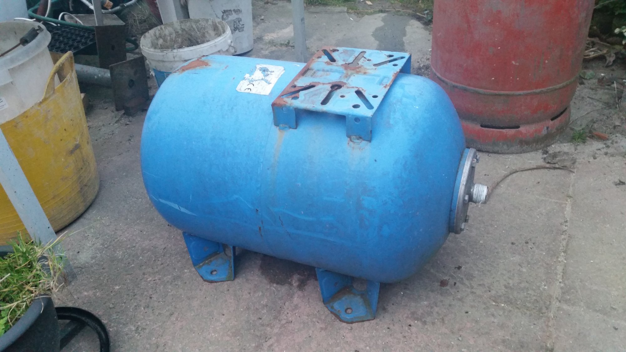

Jesus that looks like something off the Enola Gayi acqView attachment 82649 uired this a water pressure vessel I think I can take the guts out and use it as an extra tank for my compressor.
I might be wrong but I think it will be too low a pressure rating fro a compressor, bets to check the plate and check the internal surfaces for corrosioni acqView attachment 82649 uired this a water pressure vessel I think I can take the guts out and use it as an extra tank for my compressor.
Yes those vessels have a bladder in them ,air on one side water on the other , I wouldn't trust one to take 100+ psi, better off with a lpg gas cylinder .
