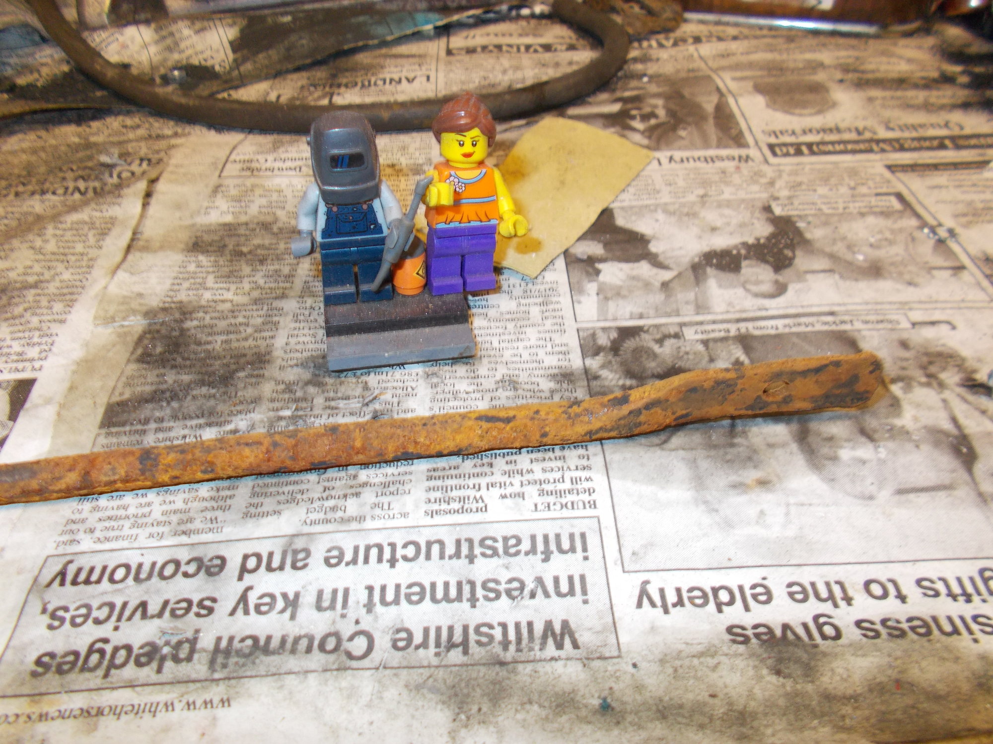

I have finished the "Wee Beastie", How it got the name is lost in a beer fug of time.
The new grass nail was aged in the following way.
I used it as the anode in a de rusting tank for 4 days. Then took the encrusted bar and dipped it into citric acid.
Let it dry and gave it a tickle with an wire brush.
Now it has bean wiped over with bee's wax it doesn't look out of place on the scythe.
The design of the grass nail is a mix of 4 designs I found on scythes on the walls of local pubs and garden centres. All were different. I am guessing each area had their own patterns. Or when they broke the local black smith would make a new one with bits he had.

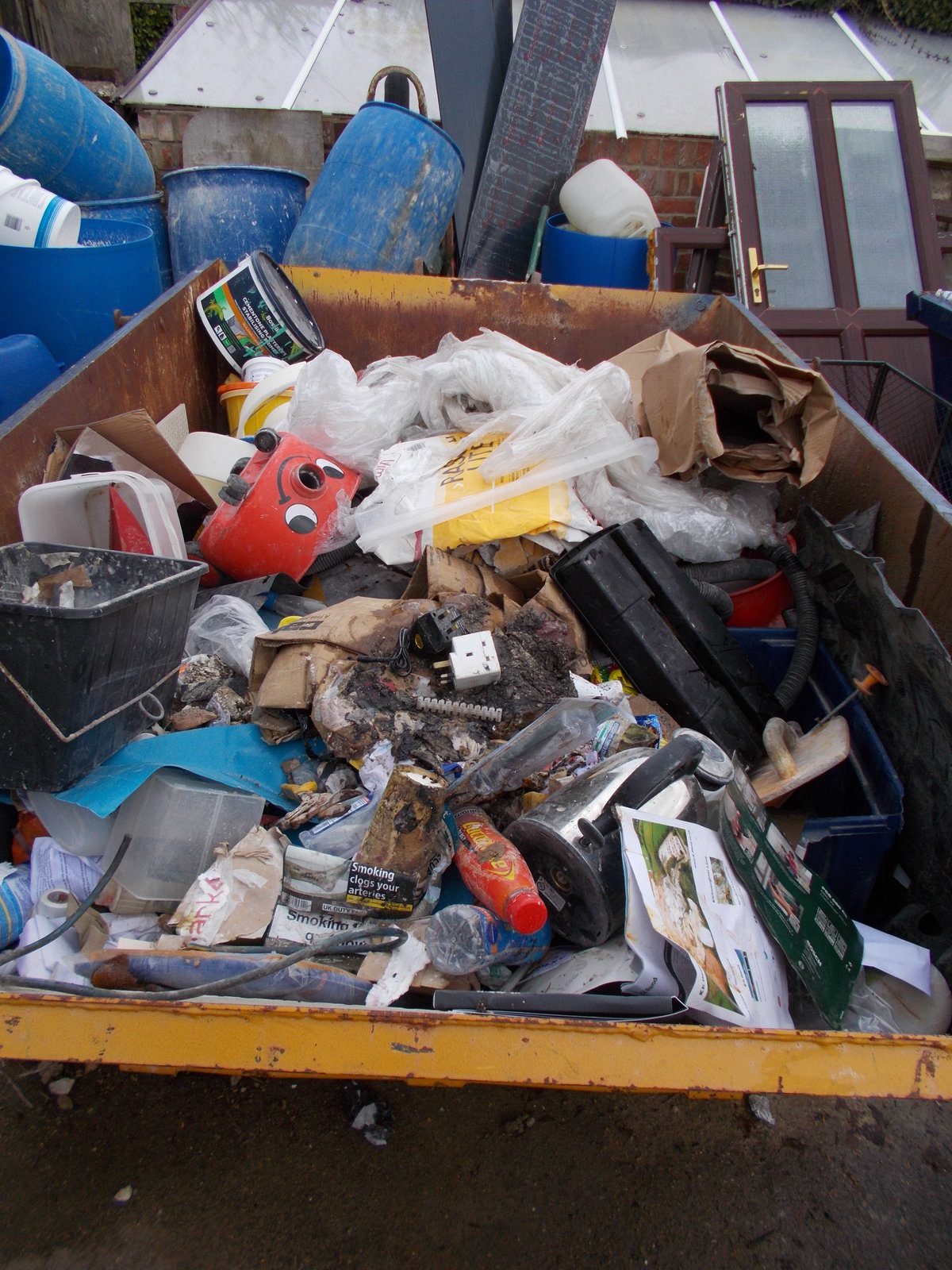

[interesting blue barrels in the background.....
