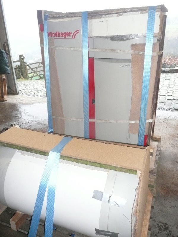

Also lots of hot water for the brewery and I can extend the heating system to the wifes workshop in the summer so she's a happy bunny too.Today this was delivered many thanks to @fizzy a fantastic service, it was only picked up from the back-end of Aberdeen on Thursday
Its a 15kw pellet boiler, I should have a very warm workshop in a couple of weeks
The courier was one of happiest I have ever met, nothing was too much trouble. We had a good chat over a brew and he left with a couple of bottles of home brew.
Just got to buy the flue and buffer tank and I will be toastie warm and no more rusty toolsAlso lots of hot water for the brewery and I can extend the heating system to the wifes workshop in the summer so she's a happy bunny too.

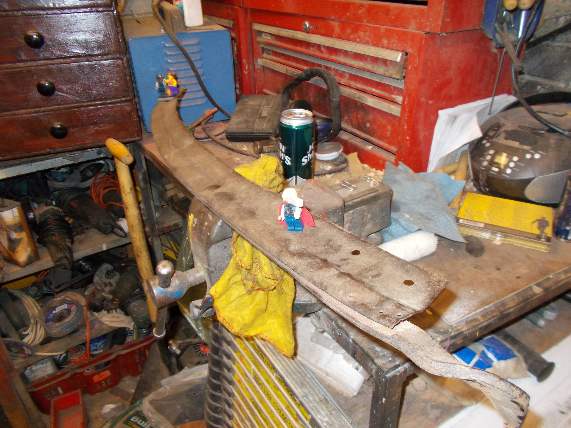

heating rivets that size! bloody matelots.......................Very little time this week, work etc.

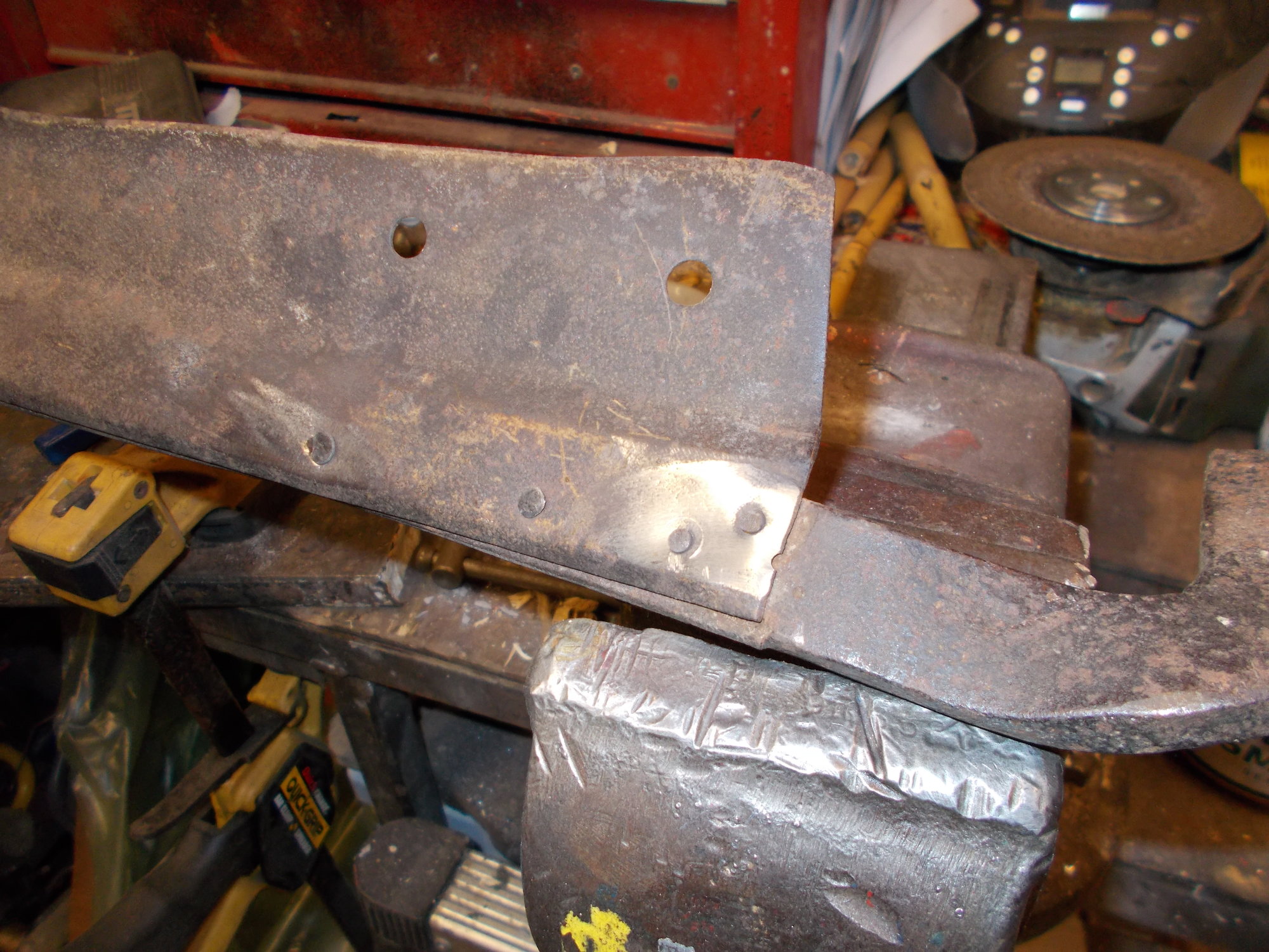

Last night got some work done on it.
The handle, has cleaned up very well, drinking Linseed oil like a sailor on his first night ashore. The metal fixing at the end was removed and cleaned.
The blade had lost 4 rivets, sheared off. But a few minuets with a drill had the holes opened up.
Were to buy rivets on a Friday night. You don't.
You get some welding rod of the right size, trim to length. Heat to orange hot. Insert, hammer to suit.
I could not get the edges to fully line up. The whiteness marks shows it was like that for a long time, so I had to leave it has it was.
