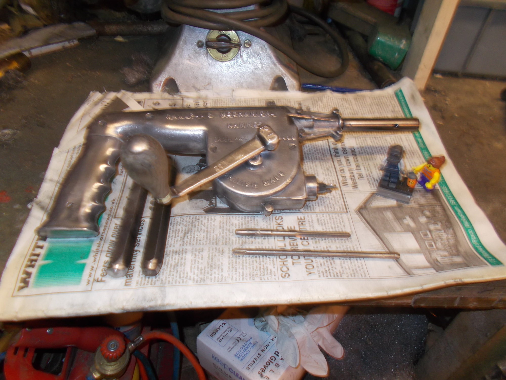

But This is what was acquired for me. Many Thanks Mrs TYA.

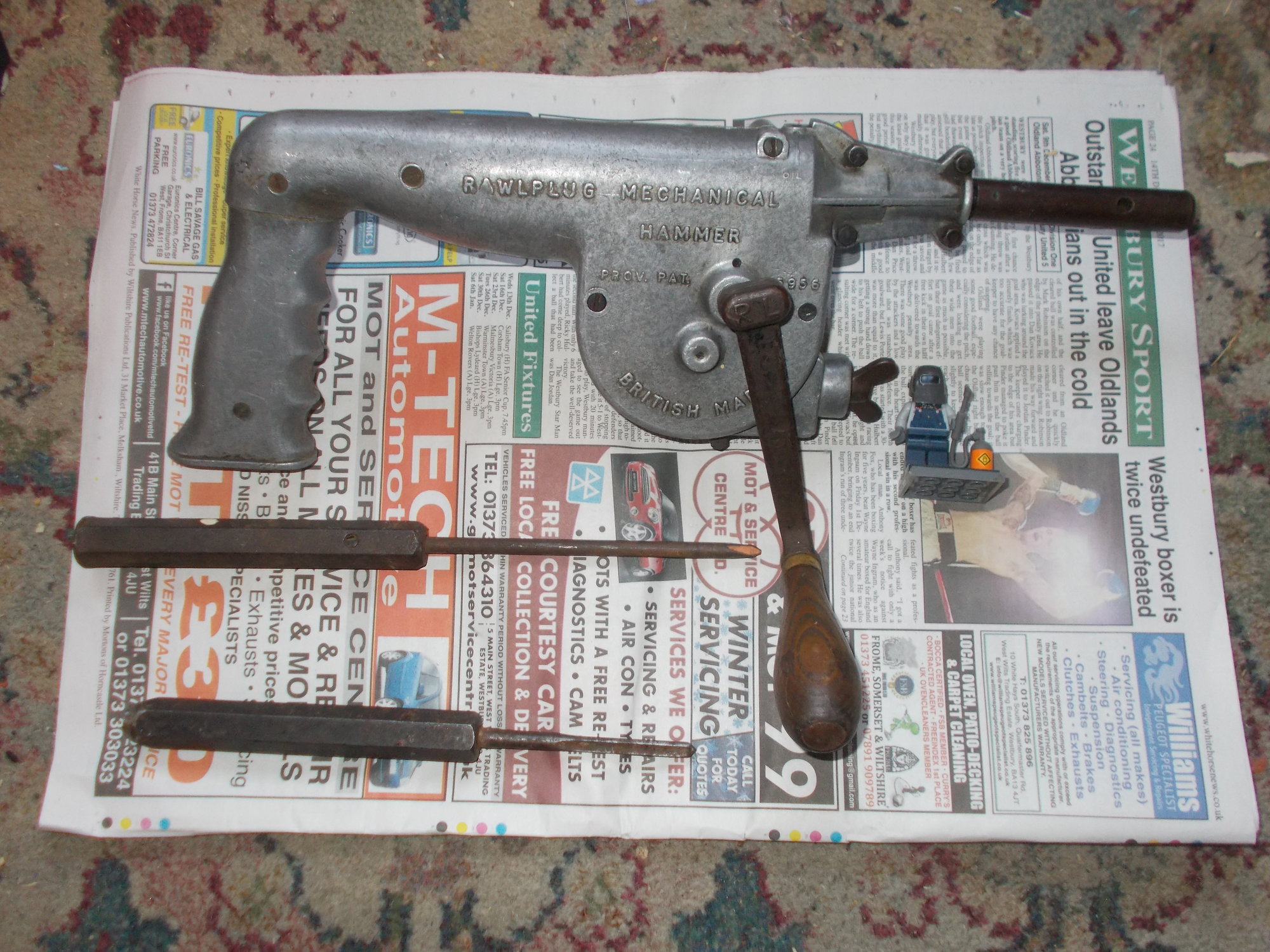

Rawplug Hammer. With 2 bits. It works.
I just need to remove the 2 bits from the mandrills and try it out.
Are the Lego figures you and the lady of the house? I have been into Lego since i was a child never seen the welder figure.A few hours today.
A good de-greasing and wipe down. It was coated with some clear sticky stuff.
It was striped down and re greased and it all works.
But the small scratches and nicks made using it with out gloves uncomfortable.
They were not deep, just the stuff it would get in us and being dumped in a tool box.
Fine files, wet and dry and a buff up and we get.
The 2 bits came apart with some use of heat and a drift.

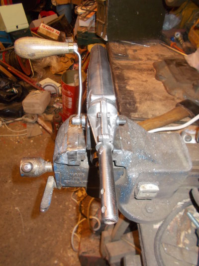

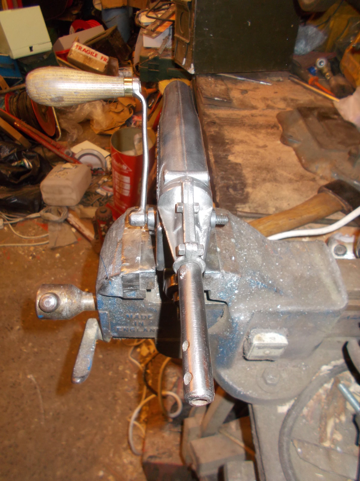

One issue came to light, was the handle was bent, so when you cranked it over you knuckles suffered.
I found out, google helped, there was 2 style of handles for this machine. Looking at the handle I have it was an early version. But I was worried if I worked the handle to fix it would crack or fail. As it was I had to remove the handle and re-rivet back so the slop was removed. Nice job with a ball pein hammer and a beer.
Yes, I have used it. I drilled a few holes in a House brick I acquired. Don't ask how or were I got it from.
So another tool for my collection.
