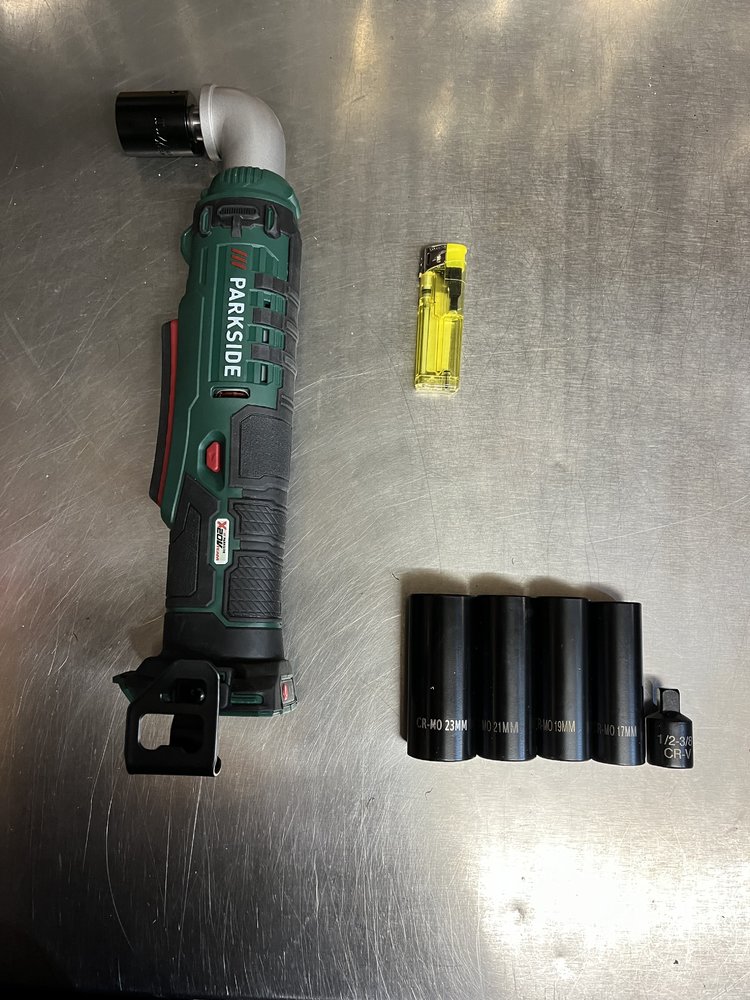

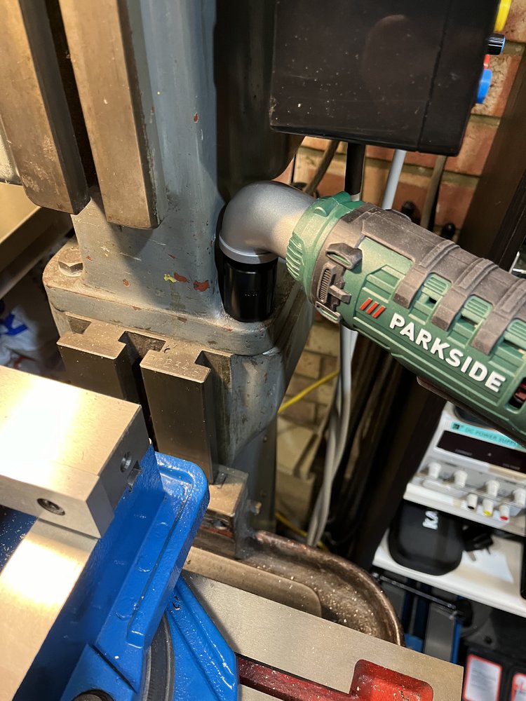

On giving it a bit of a workout.
Pros - Decent DIY build quality, pretty light and quite compact, got into some reasonably restricted access bolt heads, comes with 4 deep sockets which I found odd given the big point is tight access and a 3/8" adapter. The trigger speed control allows slow control all the way upto max. The light is well directed. And as @eddie49 posted "hammer mechanism and a geared 90 degree output, not simply a motorised ratchet"
Cons - At max 76Nm it's obviously not aimed to shift rusted fused stuff, more light/medium assembly/disassembly. The direction change switch is easy to knock, bit picky maybe but not ideally placed where you are gripping the thing.
Overall pretty happy with it.
