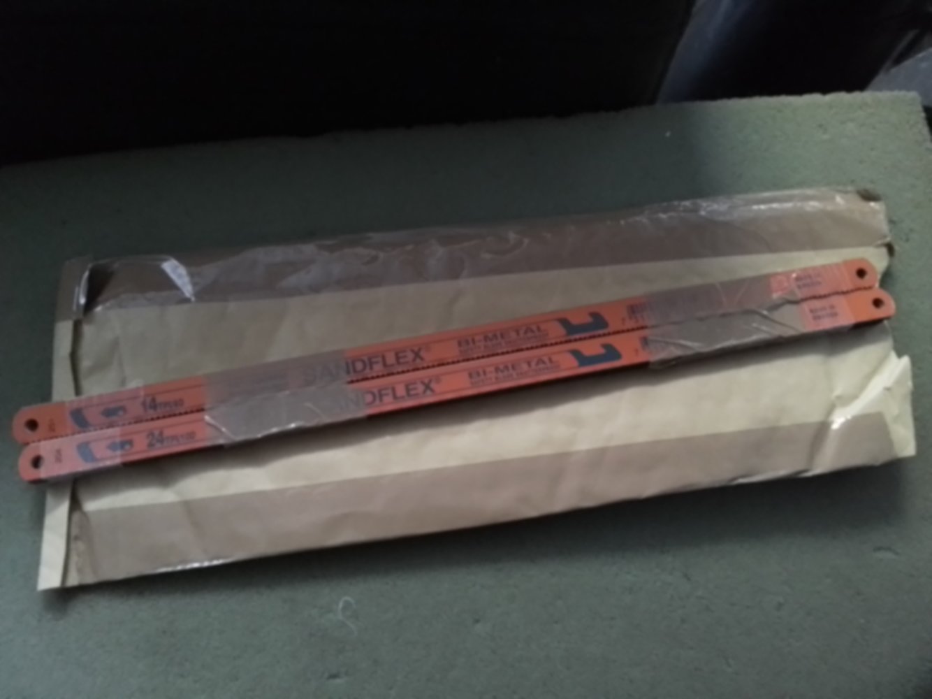

Yes lots of fakes, I wouldnt buy them unless it was a very reputable shop.New super duper no expense spared hacksaw blades
First cut an inch into mild steel 3 mm sheet and all the teeth disintigrated, errr something wrong here ... are there fake Bahco blades out there ?

Seller has refunded me without any questions which is suspicious , I have contacted Bahco to see what they say.I've been making a point of buying proper Eclipse blades instead of the "ten for a pound" blades from the market, all was fine until it turns out there are fake Eclipse blades around as well. Chap that told me was selling blades, but didn't have the ones I needed (32tpi) so it didn't really help. Apparently with Eclipse, you can tell they're dodgy if all the paint comes off quickly, though that doesn't help when you're buying them.
A few years ago I bought some Purdy paint brushes on ebay. It was a few months before I used them but then I noticed they didn't feel right in use, just didn't work like the other Purdy brushes I'd been using for years. I left them soaking in water to use to finish the job.Seller has refunded me without any questions which is suspicious , I have contacted Bahco to see what they say.

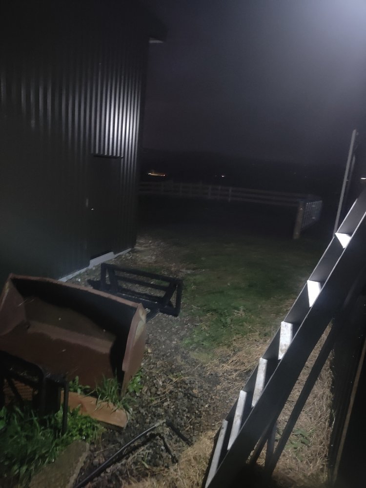

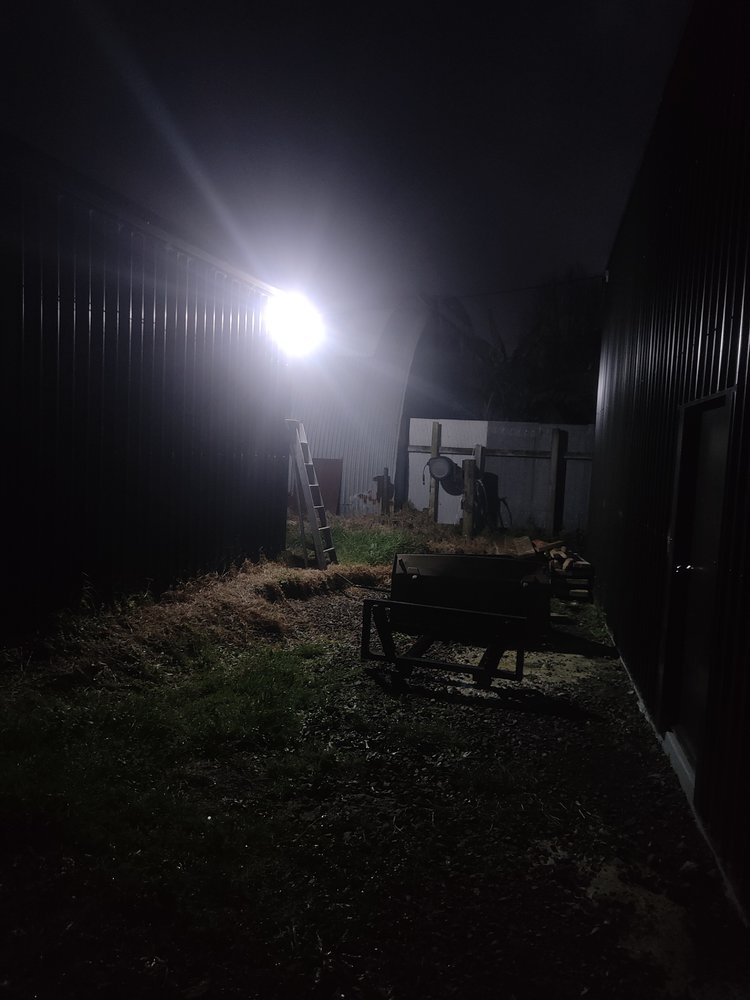

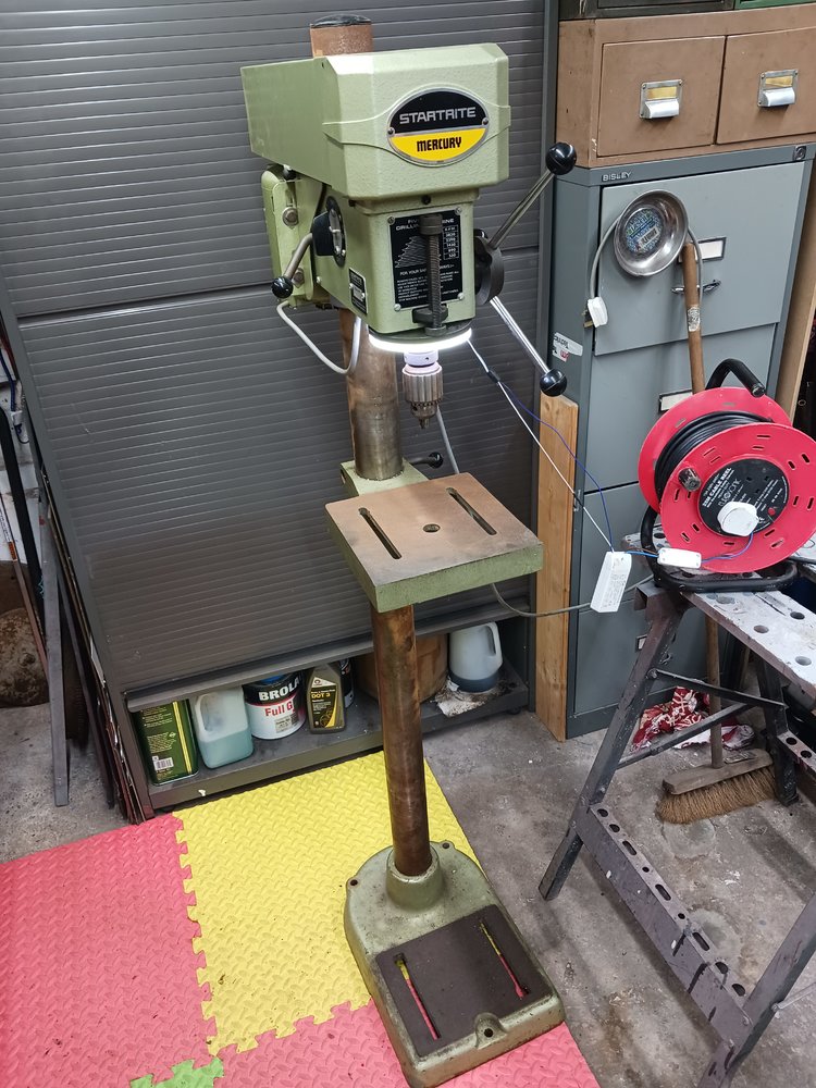

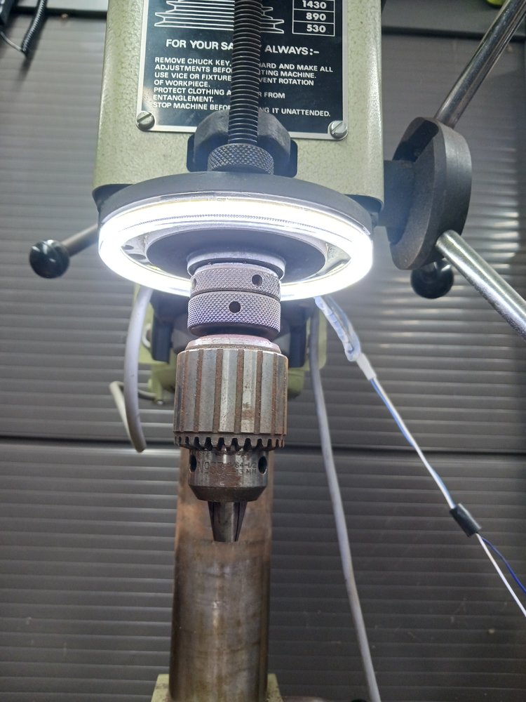

I like that light, does it work (I mean by that, does it nicely illuminate the workpiece without undue glare etc)?A Startrite Mercury drill, unmarked table and original paperwork including the invoice from 1979. The (deceased) previous owner installed a light above the chuck.

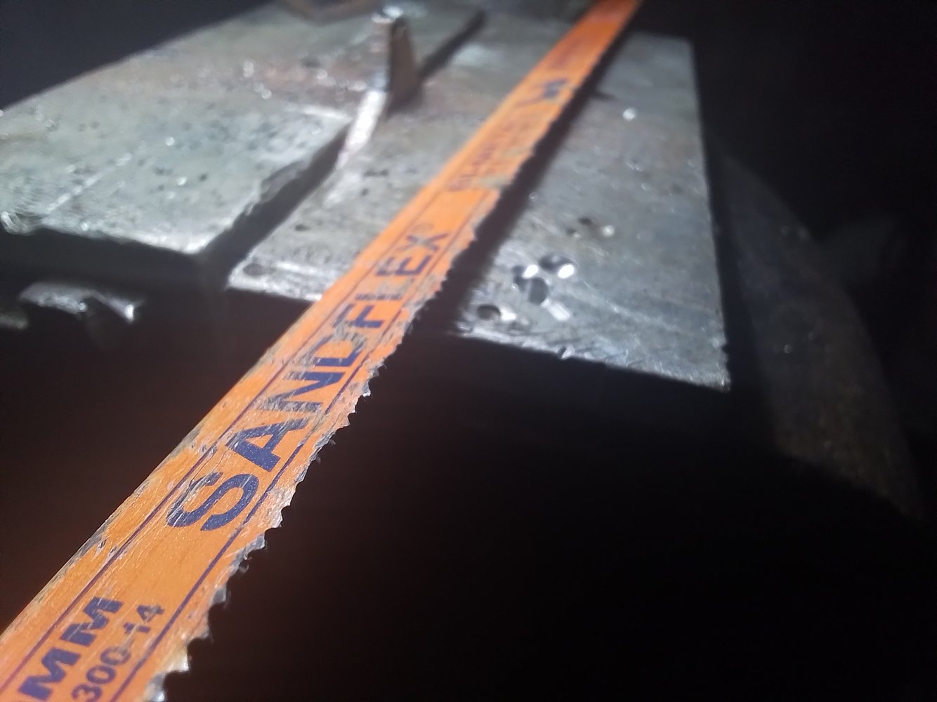

As a light hacksaw user, both work and play, I would agree with that. I now take the time to change blades for the material.Looking again at the hacksaw blade pic, the teeth have sheared rather than rounded, so it might be just too thin metal for the tpi, as tigdlo said. Try another one cutting something 5mm+. Its best to have 3 or more teeth in the work at any time
When I bought some fakes off ebay, the teeth were soft and rounded over while trying to cut a 4.8 grade bolt. The seller was a pain, but I sent them back.
Was it something you picked up commercially?
Must admit it looks good, but would agree it would not be better than something you can adjust and point into the work.
It works well, I'll take a picture tonightI like that light, does it work (I mean by that, does it nicely illuminate the workpiece without undue
Thanks!It works well, I'll take a picture tonight
At the moment, I have neither!Must admit it looks good, but would agree it would not be better than something you can adjust and point into the work.
