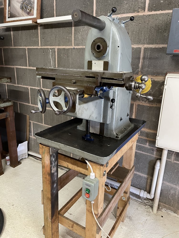

You won't be disappointed, it was nine years ago (Almost to the day) I got mine.
Luckily I can't find a better picture, so you can't quite tell how bad a haircut I had as a 15 year old.![]()
I remember that Adam, we were having difficulty getting the lathe off the trailer when your mum came along with some words of wisdom that worked, it was as if she moved old machinery on a daily basis![]()
If that were the case I'm sure she'd have cleared out her garage by now.it was as if she moved old machinery on a daily basis

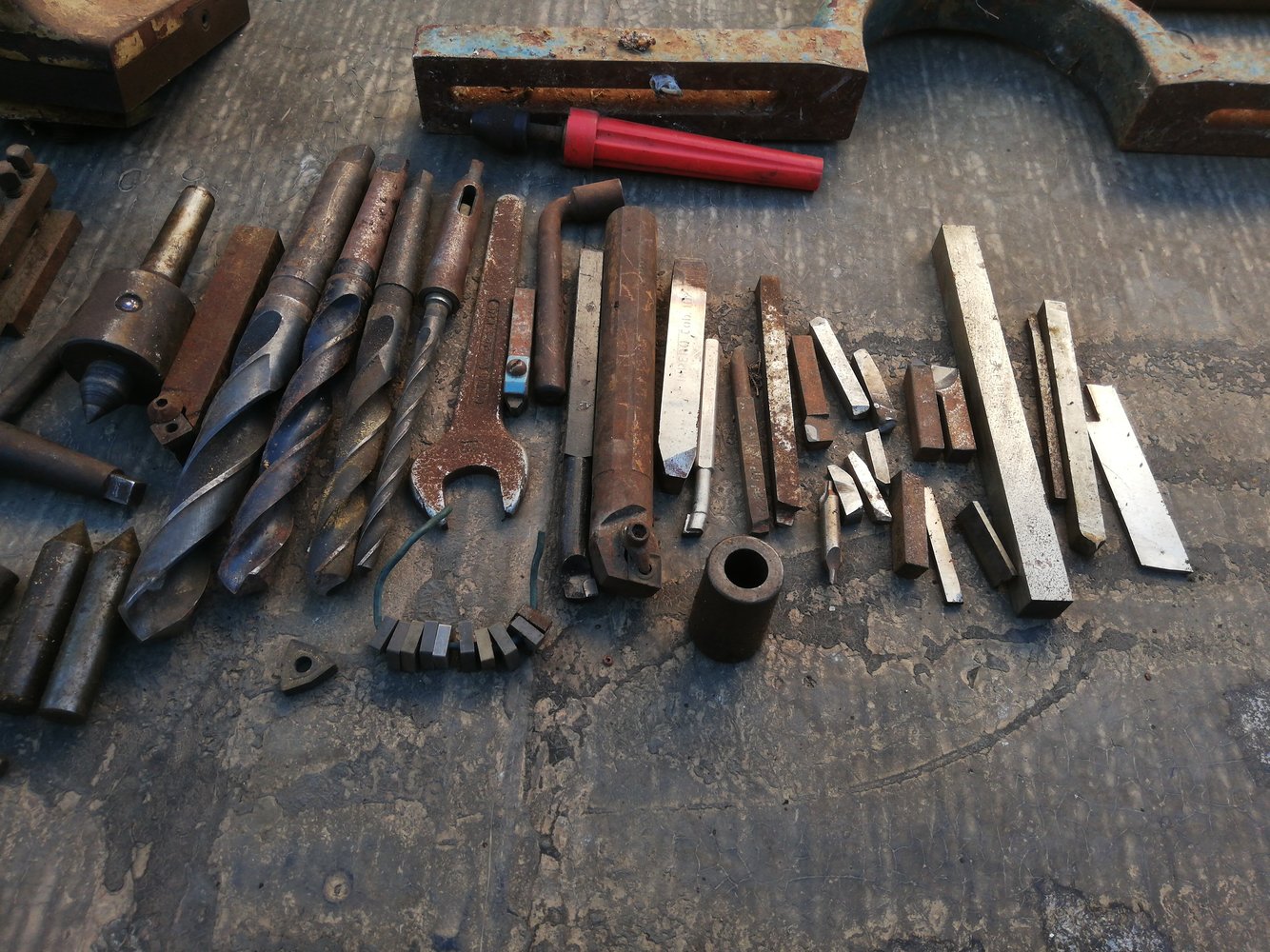

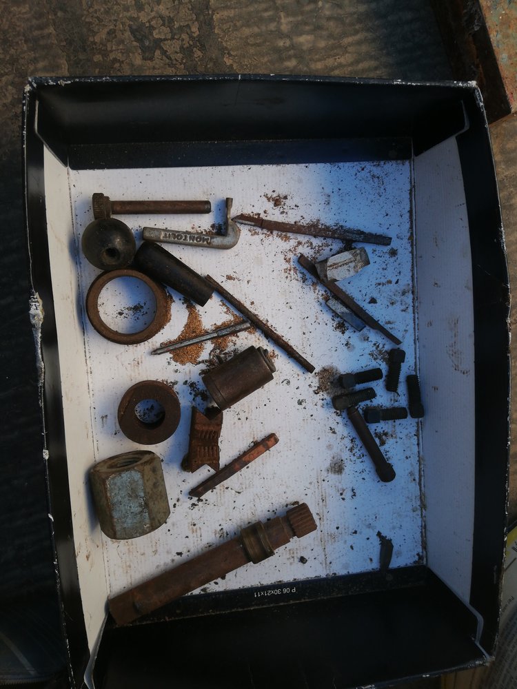

Why do they call them cotter pins. I grew up being told they were split pins, a cotter pin was and still is for me, the tapered pins that hold bicycle cranks to the spindles.Some essentials,the one box of screws were a freebie as they sent the wrong size.View attachment 446346View attachment 446347
As long as it doesn't involve cottagingApparently, UK usage is "cotter" means a wedge or tapered pin. US "cotter" is a split pin.
(It's been one of those days for finding the correct names for "stuff")

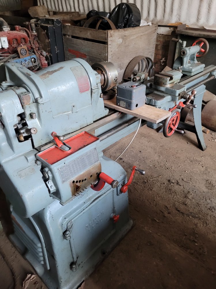

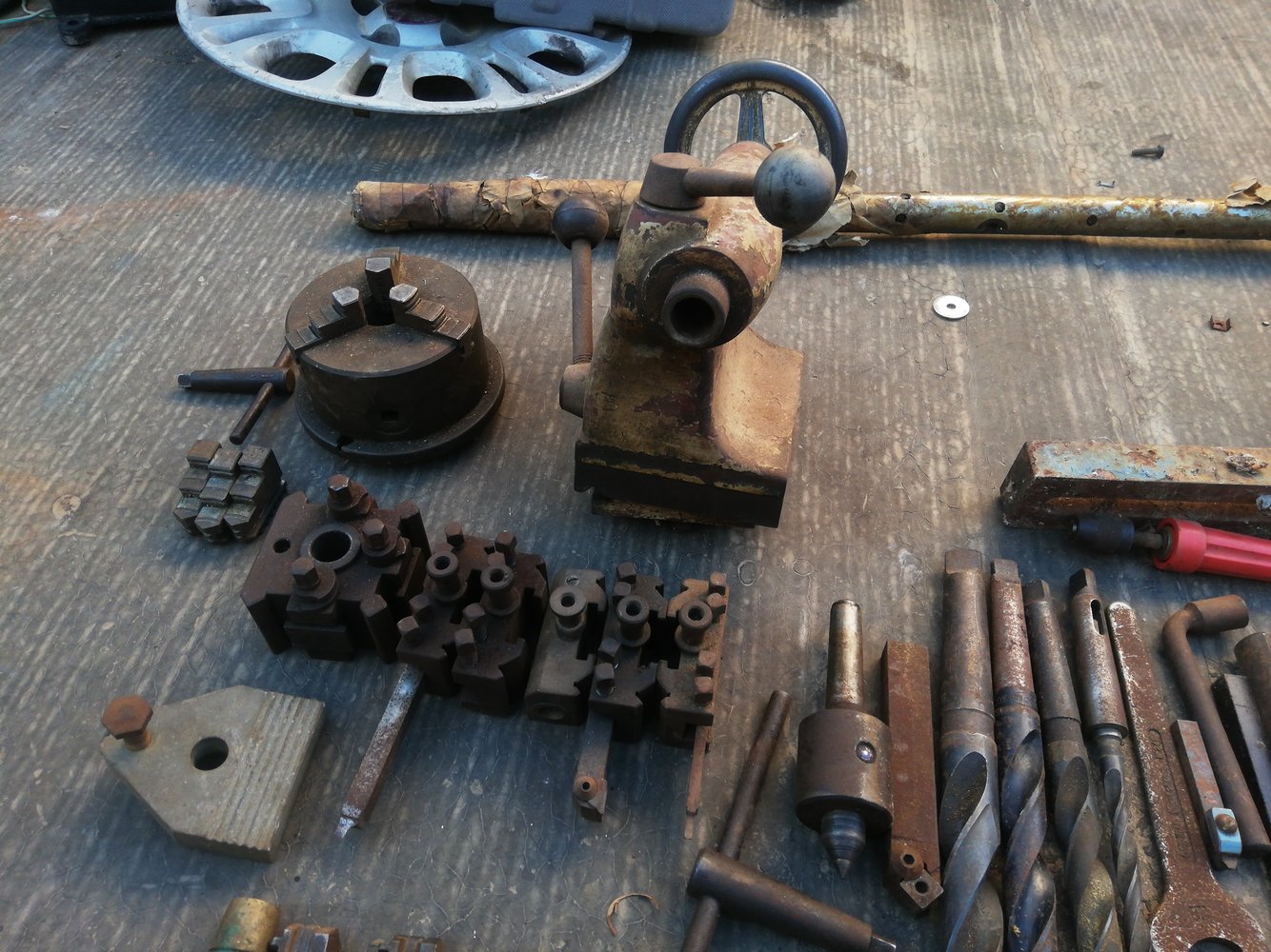

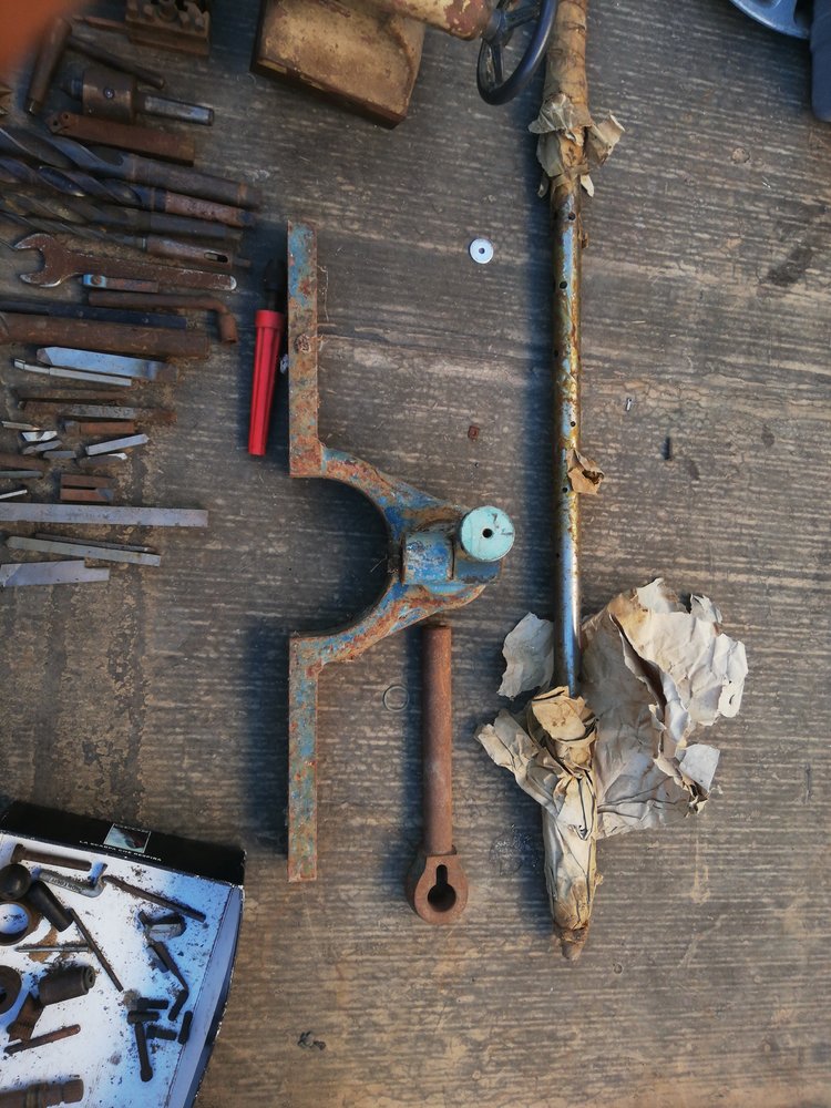

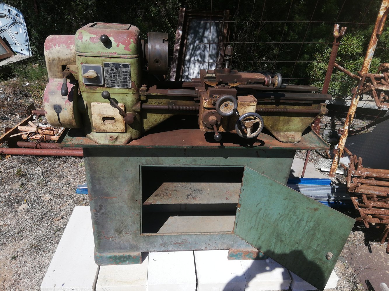

Just clean it many times with WD 40 & a scotch brite green pan scrubber & soft cotton rags , it will allow you to familiarize yourself with the lathe and still have " The character of an old good working lathe .As promised here more pictures of my new to me lathe

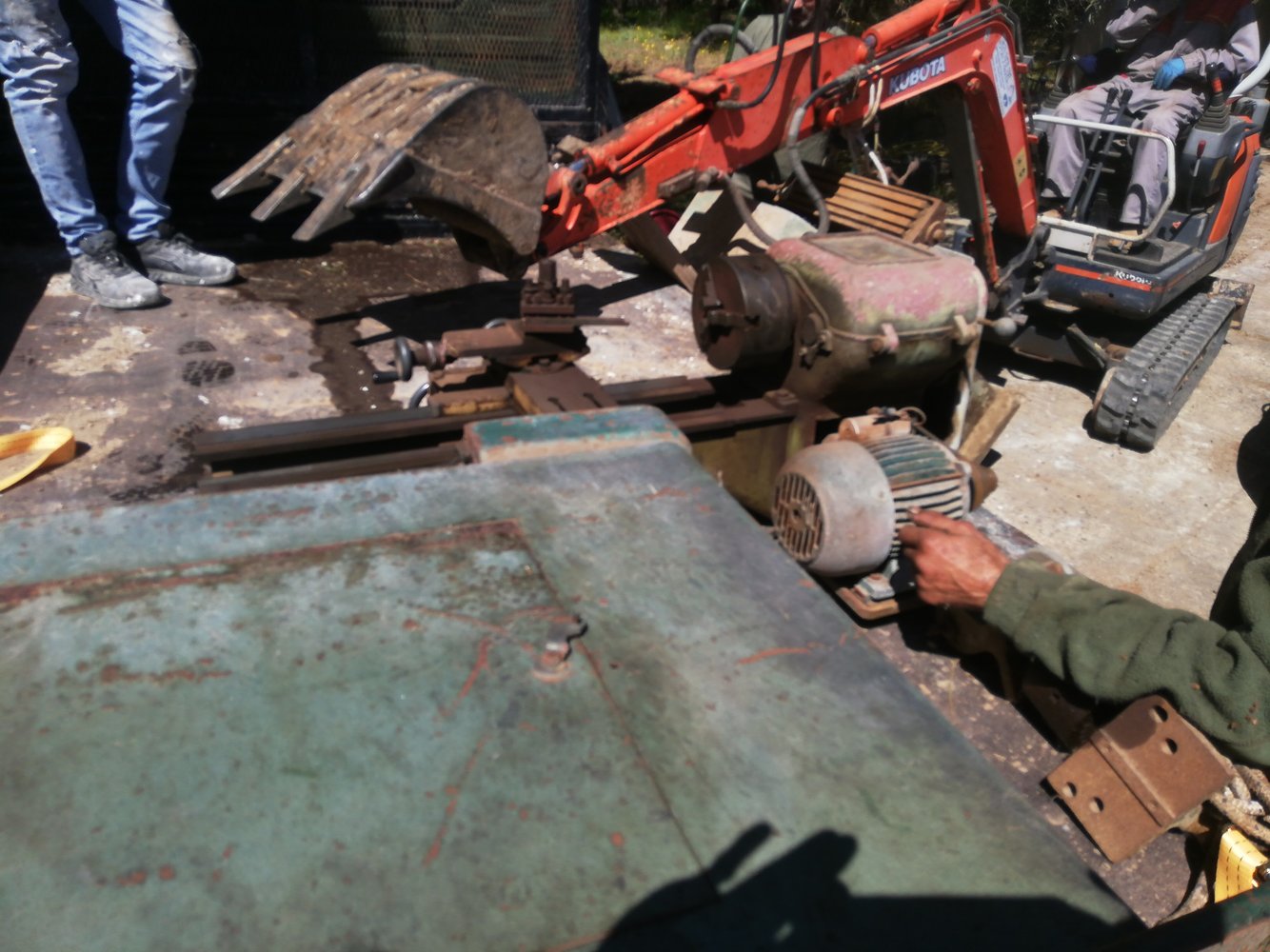

Here an overall picture of it,on its cabinet and already removed tailstock and quick change turret, tomorrow I'll remove the chuck too ,those will live at home for at least a month prior to get a portable garage and have a some short of shop in my land .

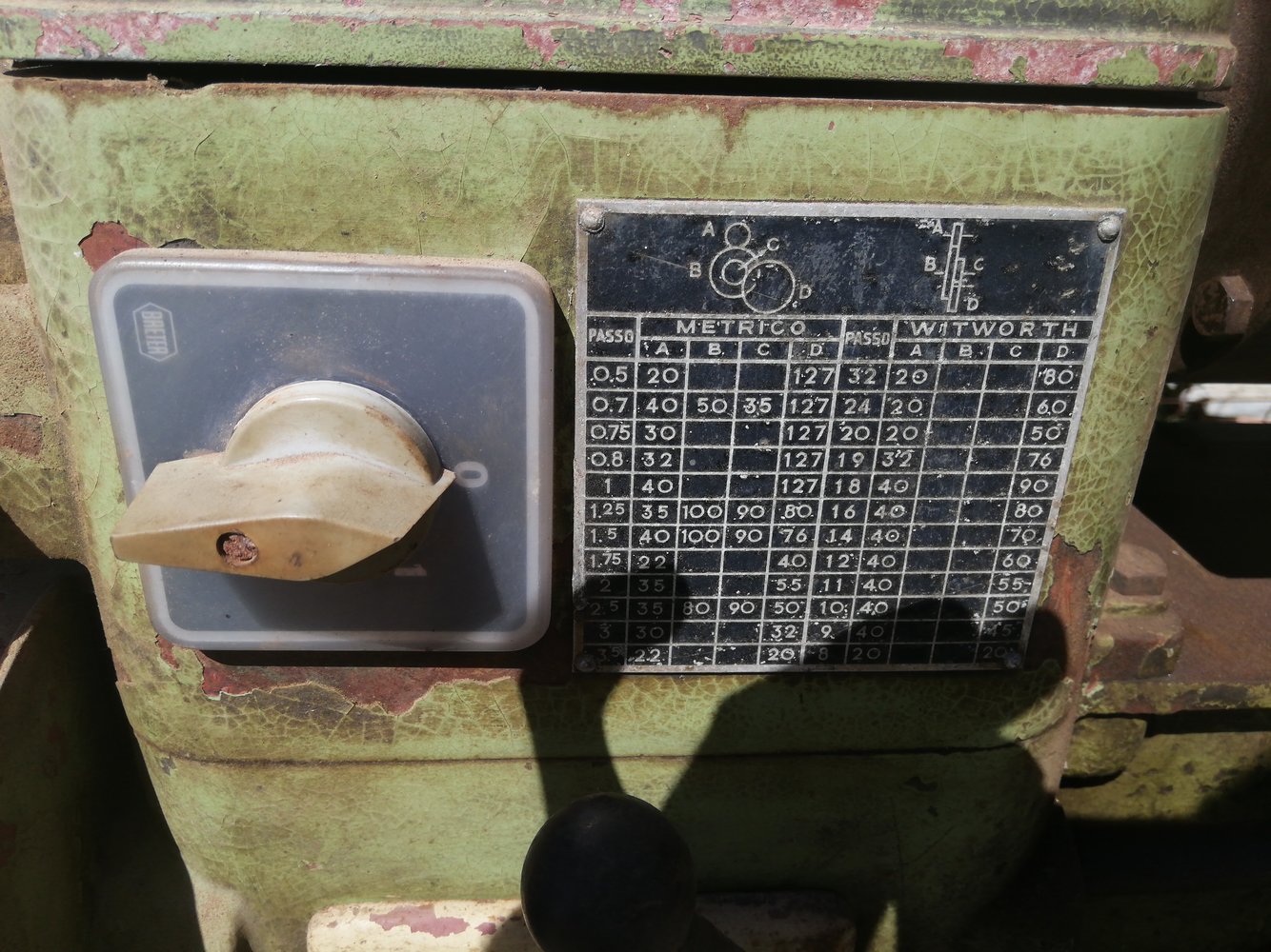

Here a detail of the switch and threading chart plus my hand shadow

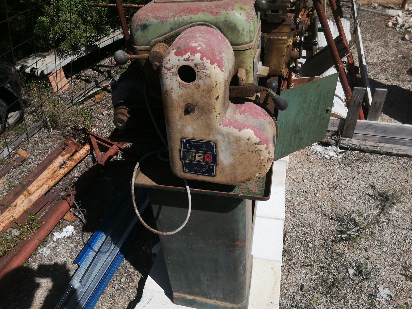

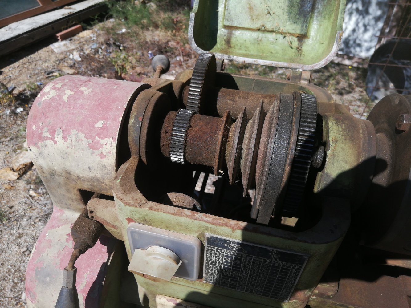

Pulley and change gear for the spindle speed
Which should be 4 on the motor , 2 mechanical on the spindle (hi-low)
Other 8 in the headstock between the 4 pulleys on the spindle and other 2 between the motor those pulleys upmentioned and shown in the pictures .
I didn't have a proper wrench to open up the change gear cover on the feeds speeds cover on the left .

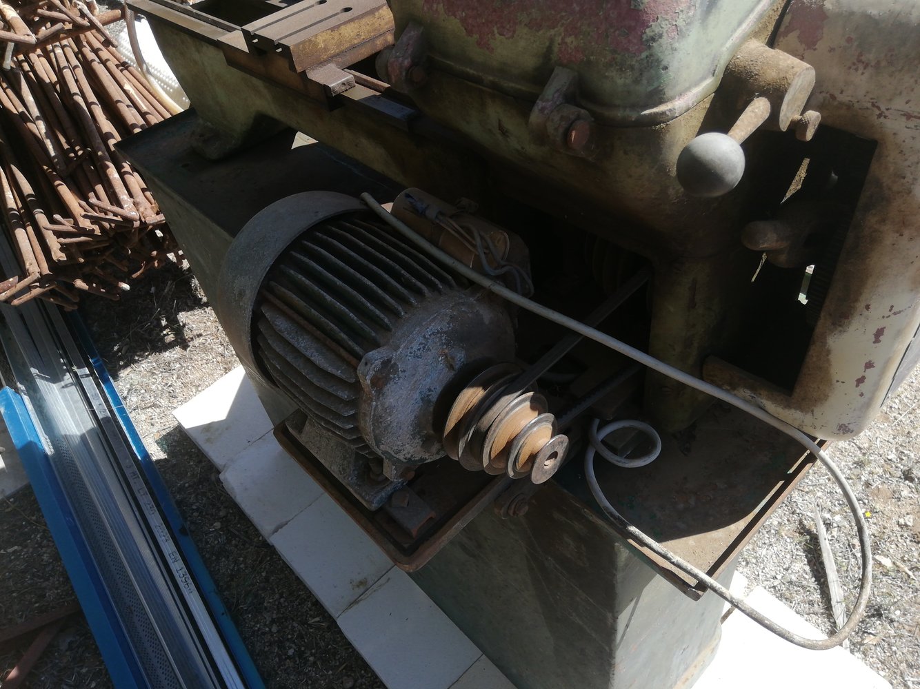

Here the motor with its 4 pulleys .
The hi-low change gear lever up on the right and one of the two change gear levers for the feeds
Here the change gears bonnet with the spindle bore passage and the manufacturer logo CEB which I might try to search on the lathe.co.uk website if I'm able to find anything about especially the spindle speeds cause there's no indication on the lathe
I don't know if paint it back in raseda green or grey with the inside of the bed and the top of the bench in red .
I might make a dedicated thread about it later on when I have enough time and resources to properly restore probably in May or June
Now I have to unload the trunk of my car so I can take some pictures of rest of the acquisition.
