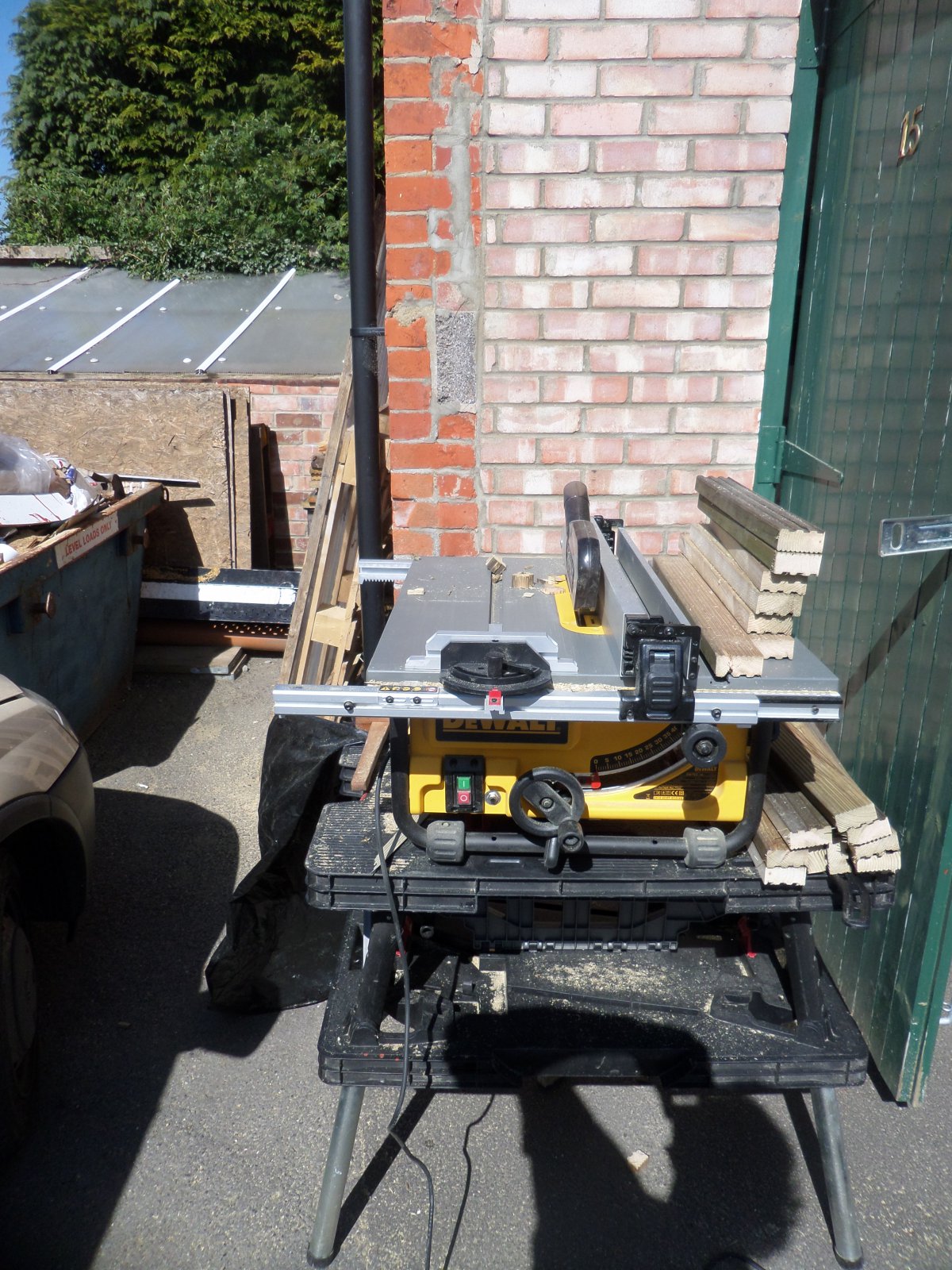

Car boot sale this morning, not the normal 2 go to. I bag this baby.
Seller was telling me it couldn't cut a straight line for "Love or money" Then he gave up on it and dumped it in the shed.
Pulling it out it did not work.
Got it home.
Opened the plug and the live wire had came detached. Nice to find a plug you can open up these days. t even has De Walt embossed into it.
The not cutting true was easy. Set the mitre angle to 90Deg not the 8deg he it set to. Ok the locking device was murder tight.
It still did not cut true.
The fence is removable, a quick look showed when it was assembled it was set up one click out. a quick fiddle and away we went.
That's the baby and a few rip cuts on some old decking.
