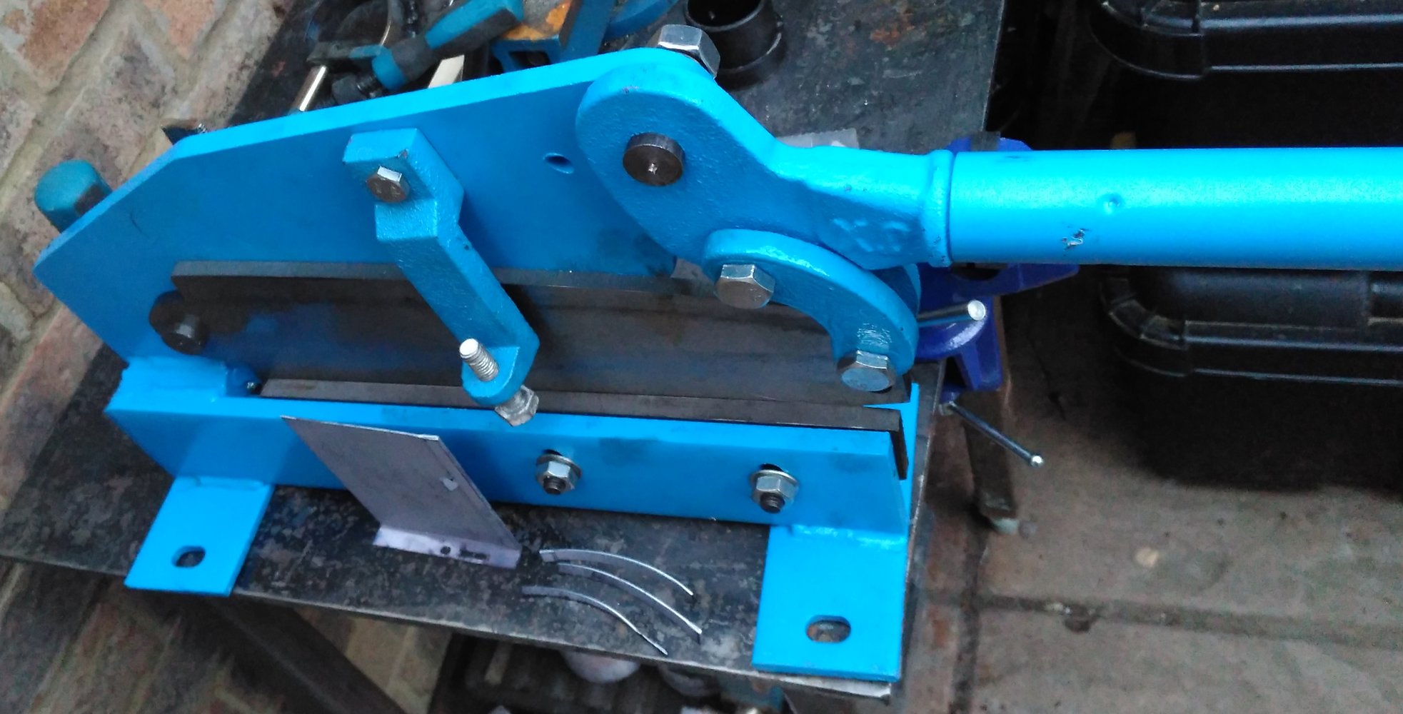

I got a Sealy bench 9 inch shear about 25 years ago ,It cost me over £125 IIRC . I'd got over a thousand 150 x 200 mm rectangles of 10 mm steel mesh to cut up a bit better than after angle grinding them off the big panels . Cutting the small panels to a pattern to make observation tubes and places to mount the automatic drinker devices so I could start equipping our small mammal reading farm & get on rearing stock ASAP.A big box. It contained..

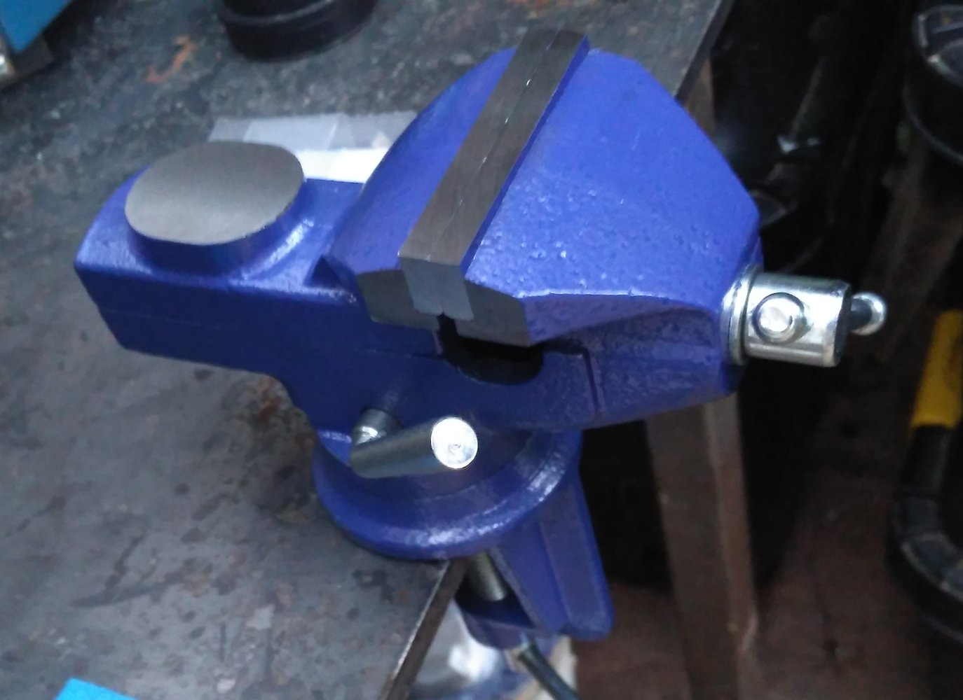

A tiny 1.5kg swivel vice. I am quite impressed with this. £6.
300mm bench shears. Cuts nicely, should be better after adjustment. £31 !!
The feet are not on straight and are warped up but I couldnt give a crap about that.

Irritated after spending an hour or more drilling big holes in the half inch thick bench bed plate to mount it . In anger ( One of the rare occasions ) , I gave it a wallop with a 7 pound sledge hammer and it was perfect after the second hit .

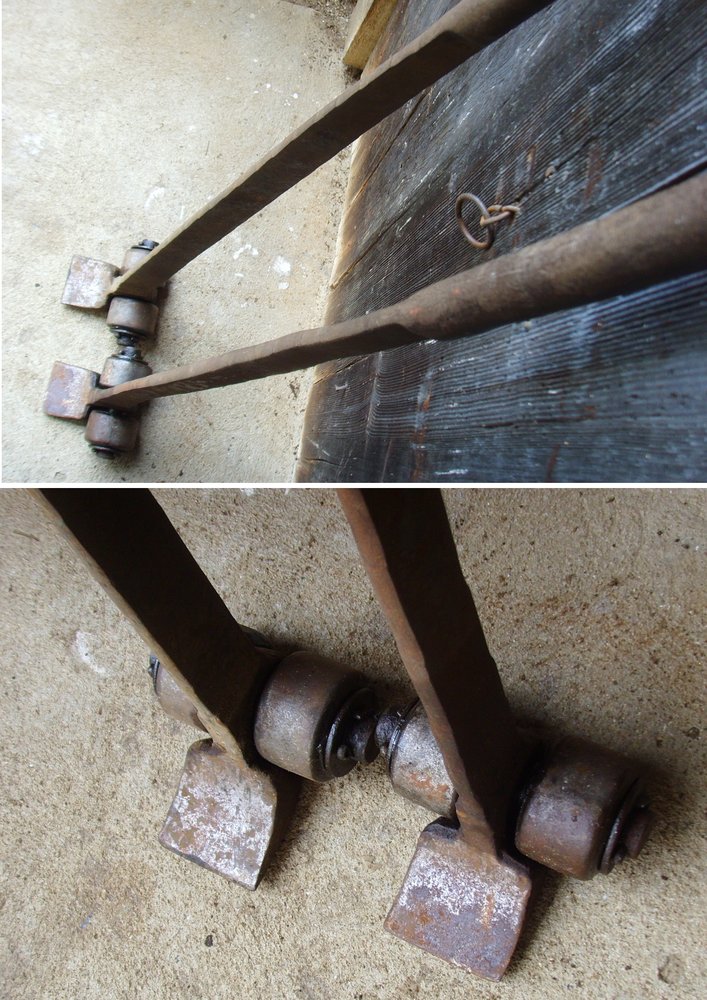

and the lever blades are about 130mm long from the tilt axis at the front bottom and the hand levers are about 1400mm long from there, then a 95kg person should be able to lift a load of a tonne with one of the levers alone quite effortlessly ...
Good for moving really heavy vault safes and machinery ... keep an eye out for four of the small tracked rollers that they usually accompany .
A pair of rather old, very heavy power levers to lift even heavier things:
If I wasn't completely asleep at schooland the lever blades are about 130mm long from the tilt axis at the front bottom and the hand levers are about 1400mm long from there, then a 95kg person should be able to lift a load of a tonne with one of the levers alone quite effortlessly ...

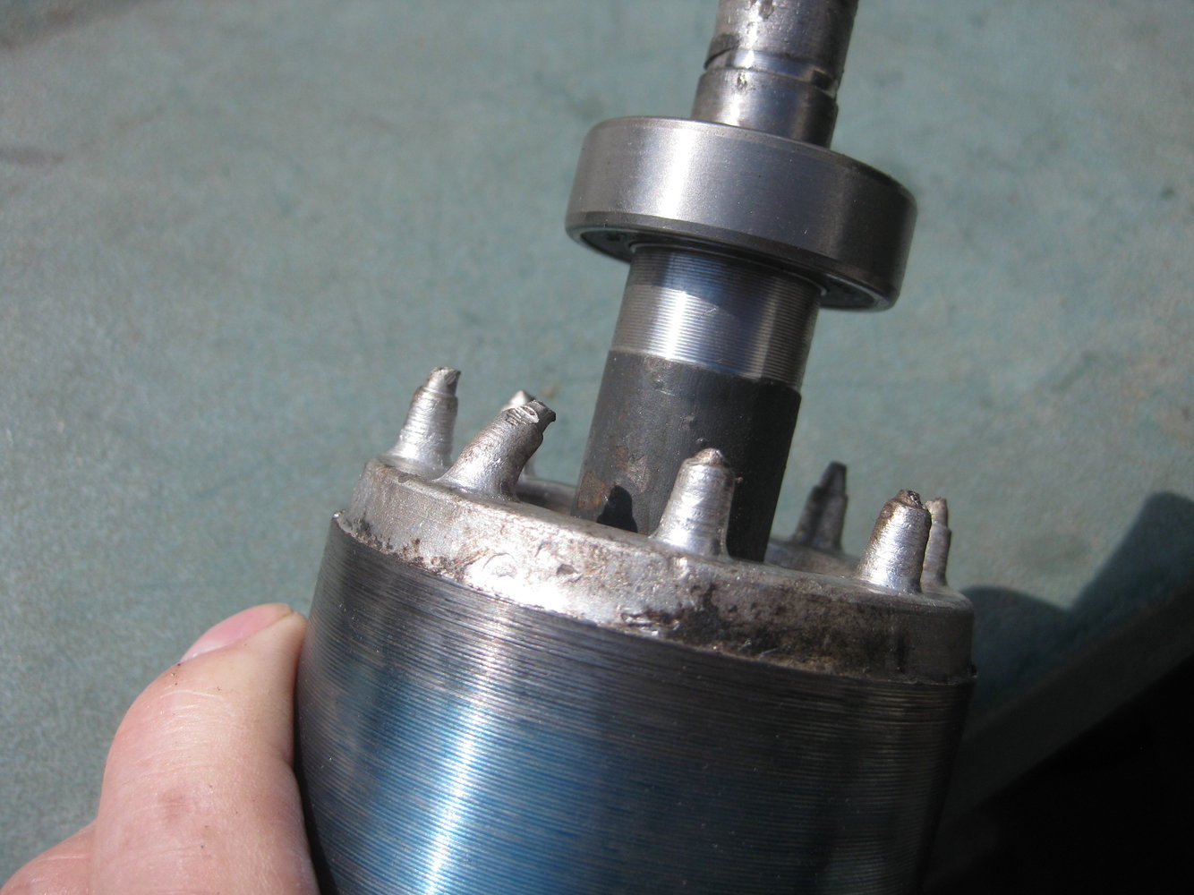

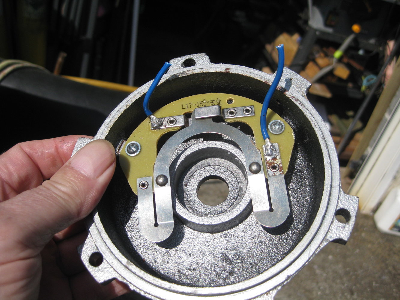

It's got a spring and bobweight system on the rear of the shaft, which when it throws closes a pair of contacts which look a lot like an old Points system. So it must be a Star/Delta soft/start system I think?
Clarke 1/3 hp motor I put on my lathe apart that only got 12 or so hours running time out of it . .
Note...the Chinesium special headed cross slot mounting screws for which out of a dozen nor more different x head screwdrivers I don't have one for that profile .Carsten - thanks for that insight. Yes I noted it was stated as just one wiring configuration too - but I don't know a great deal about electric motors themselves.As far as one can read the type plate, the motor seems to be hard-wired for star circuit, but the centrifugal switch could take a starting capacitor out of the circuit when the desired speed is reached - after that it would be counterproductive and would not live long itself either?!?
So, yes, softstart.
Carsten
Not inspiring! Luckily the 2hp 2800rpm (ish) motor on this Compressor is working fine (offload af least).I've just taken a 19 month old deadClarke 1/3 hp motor I put on mny lathe apart that has the same sort of centriflugal bi metalic contact set up , it drops out part of the windings once the heavy start current has got the motor moving if I'm right
Have a look at the special way the rotor was balanced , note the bashed up metal work but there is no evidence of any foreign bit being inside the motor to cause the damage . The rotor actually has polished the former of rotor as evidenced by the difference in colour ever so slightly , yet the bearings at both ends have very very little free play in them .
Could this motor be a factory reject that's been recondition in China ?
Darker outer rim polished by the rotor ?
The split load switch , in good condition in the cast iron housing body.
Precision balancing method
Like this?spring contact set up as well as a sliding centrifugal actuator flange on the rotor's shaft
Yes ..... but my set had a silver plating that's less toxic .Like this?
