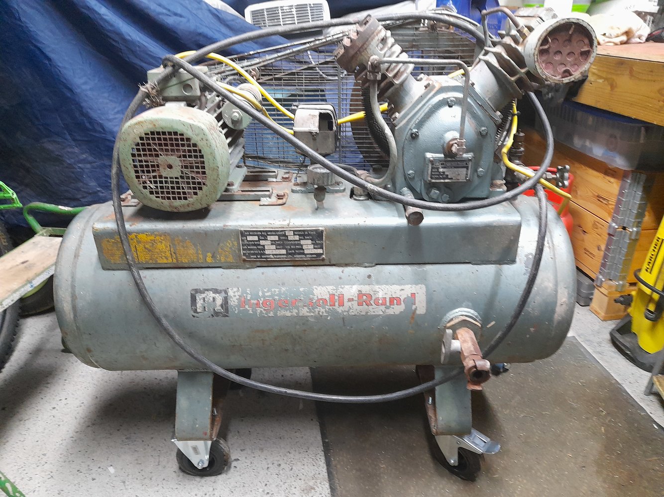

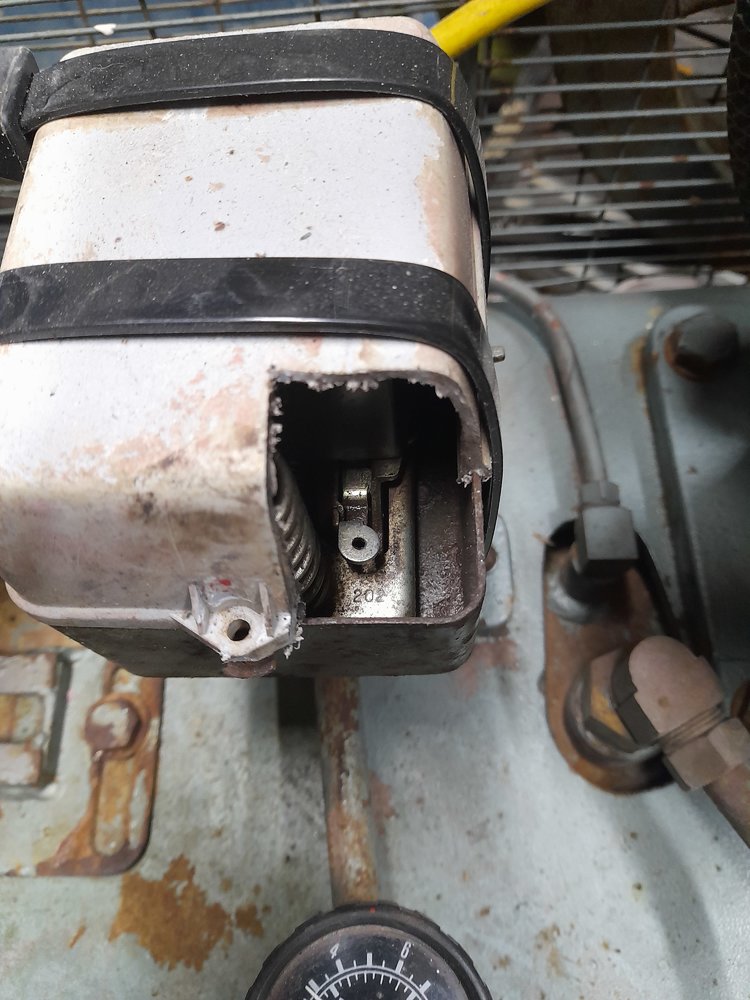

Today I collected this.....
Thanks Carsten.Interesting piece of equipment! Nice
The large phase capacitor on the motor gives me a hunch that this can be brought back to its old three-phase glory quite easily.
1,500rpm seems like a realistic rpm to me.
Why don't you take good, legible pictures of all the nameplates: Engine, tank, and compressor, then I'm sure one will be able to help you out here.
So your question about the oil means there is no oil sight glass? Everything clean around there?
Is there an upper and lower oil plug, maybe a separate drain plug? Often the necessary oil level can be estimated quite well due to the layout and design.
In any case, find someone with an instrument to inspect the tank from the inside, digital boroscopes don't cost much these days,
many people already have one.
A bursting tank is not funny, almost never without serious injury or worse, you want to have seen the inside of the tank before!
Good luck with the project, looks like a pretty durable machine.
Carsten
motor isn't original as its East German!
I think where I work (as there is a workshop for Plant & Machinery, trucks) there might be a boroscopeI can borrow.... but if not I'll look into getting hold of oneThat's why I think I can find out something about the motor for you, I know someone with original knowledge I could ask and it's easy for me to read the original technical dokumentation.
Anyone who does a lot with engines now has a digital boroscope, ask around.
Your tests were correct and important, but not enough.
You need to know what it looks like inside.
Many of the Chinese ebay-dealers of these boroscopes offer a return period, you have nothing more to lose than return postage at most.
Carsten
