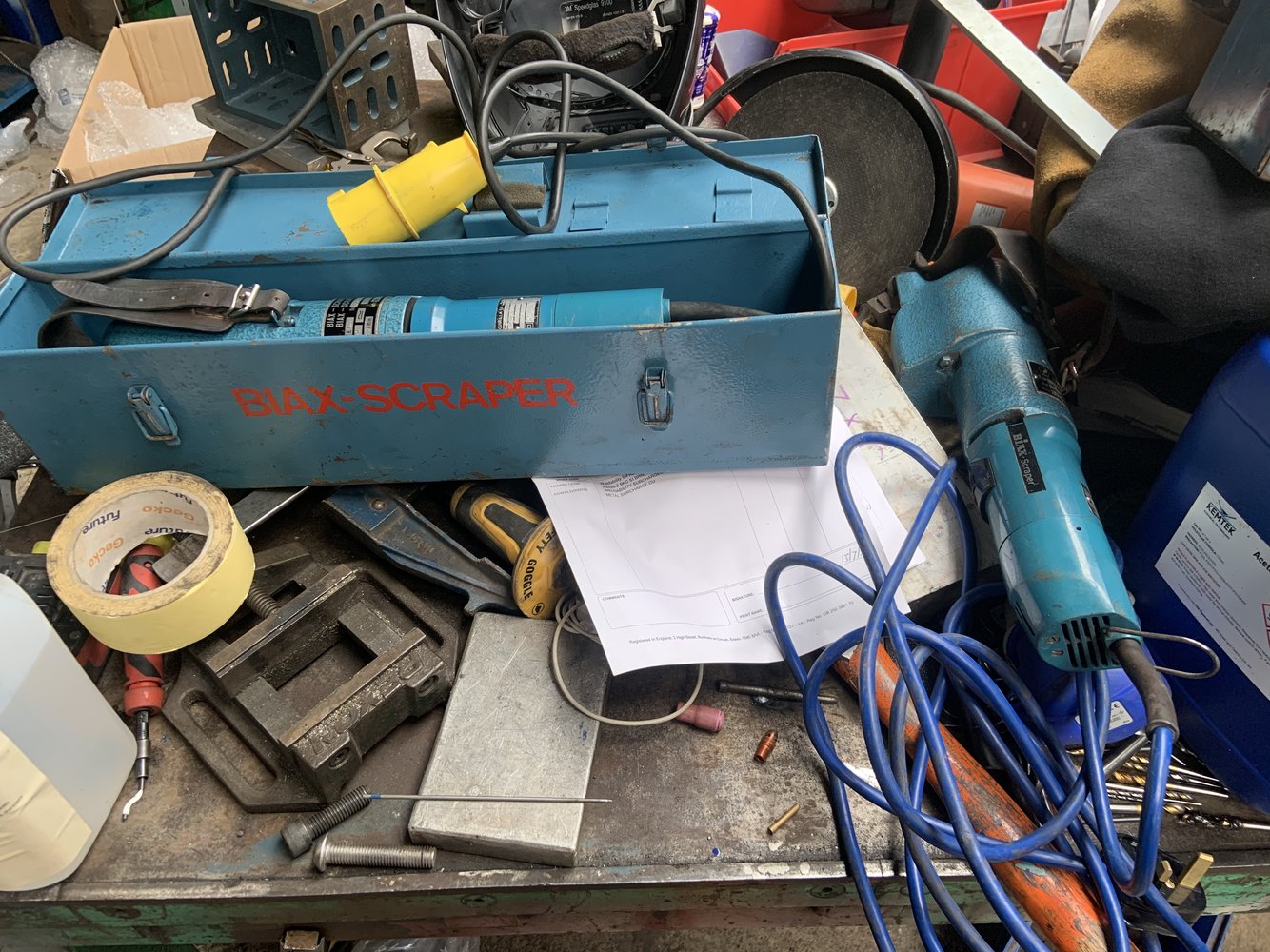

 it'll stay this clean too, I'll probably never use it! But always nice to have.

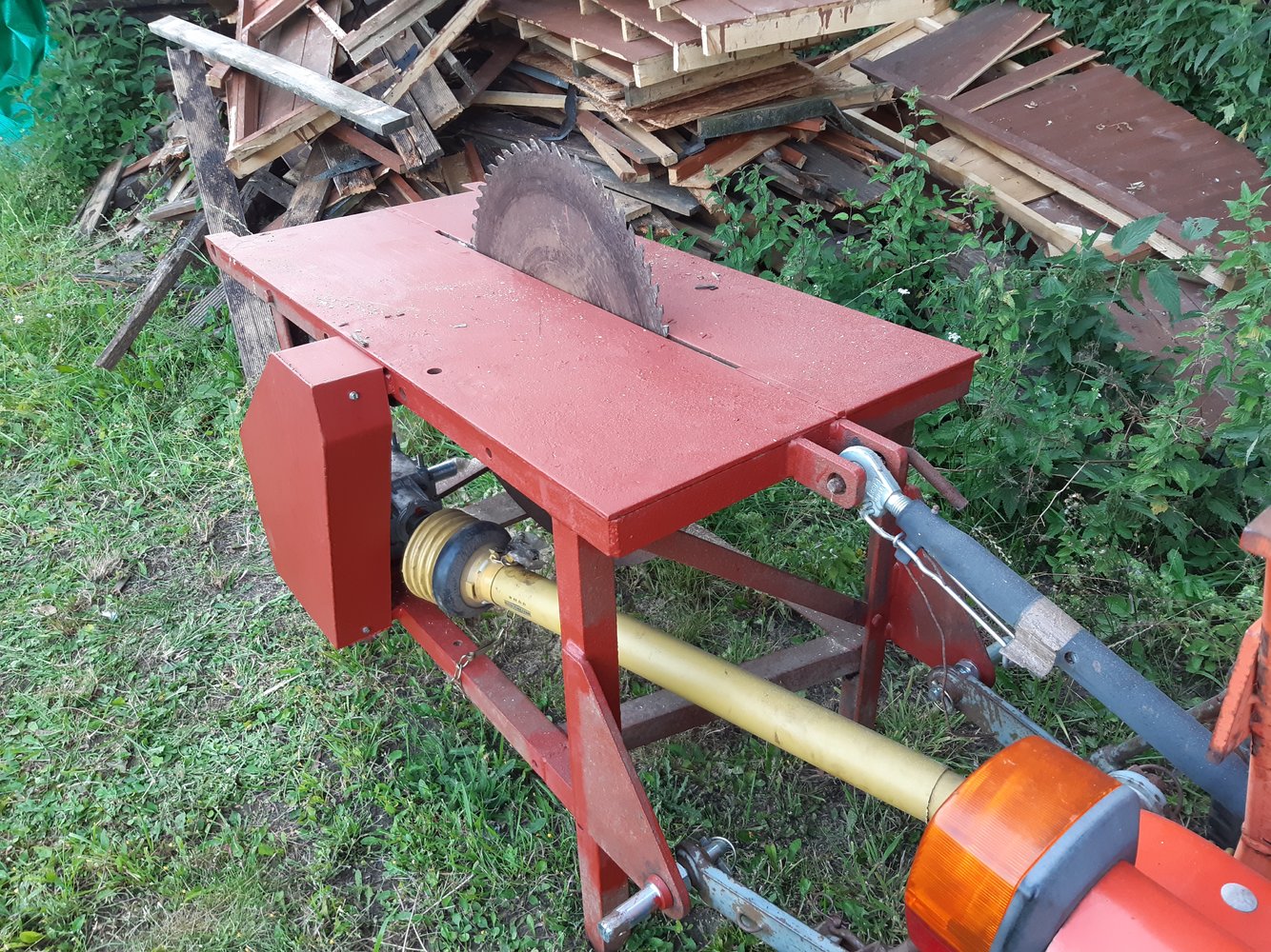

I actually got this 6 months ago but only just got it working. It's a dennings pto sawbench, it originally had the tractor at 90° to the blade but I modified it with a 90° gearbox and moved the 3pt linkage to the end., it allows access to both sides when cutting. Changed the old bronze bushes to pillow block ball bearings.View attachment 301553

Yes I doubt they meet many health and safety guidelines. I've been using it for an hour this evening and surprisingly still got all fingers and thumbs.When I was in hospital getting my hand stitched up there was a farmer type who fell across one of those and opened his belly up

Was using one of them when I was a small kid. I’ve all my digits too. We also had a belt drive one running off an old car. That’s proper hillbillyYes i
