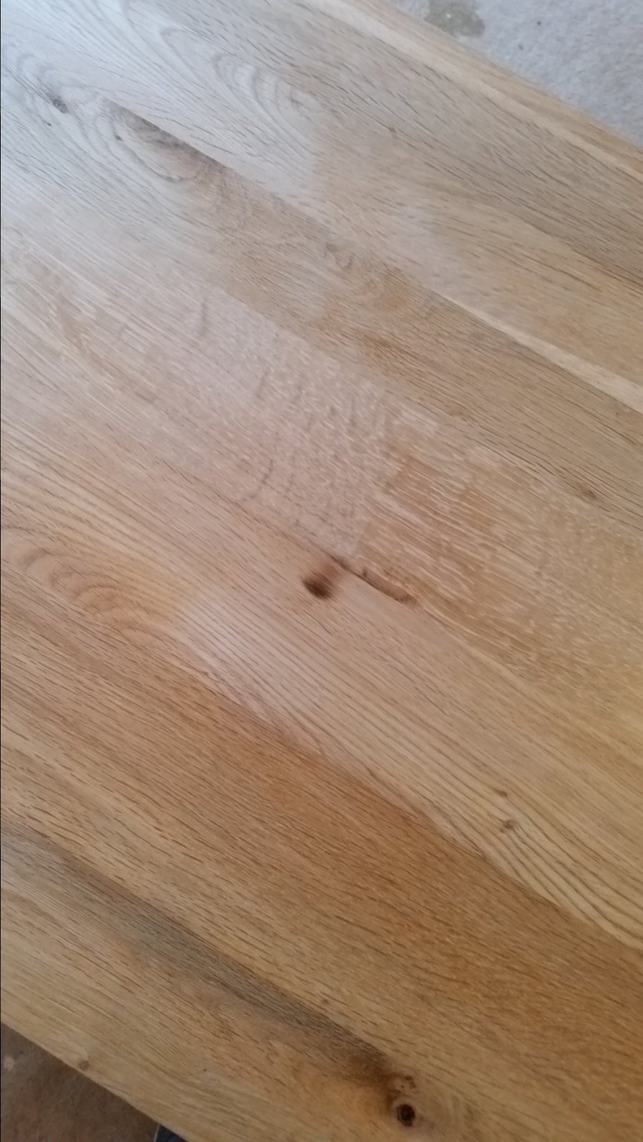

He sanded a dent in the wood, its not going to be raised by steaming im afraid as the wood is not compressed but gone forever. The only way is too take the whole top down with a big belt sander and 40 grit, then work back up the grades.
We used to wipe over with oxalic acid to bring up the grain in gun stocks. Steaming out dents was a regular job i used to do as an apprentice.
