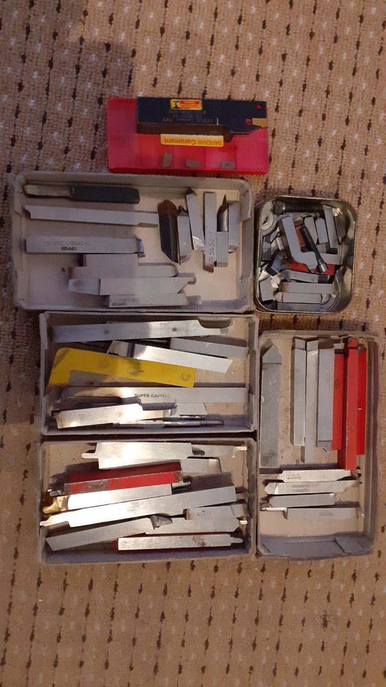

and a several boxes of tooling courtesy of my BIL

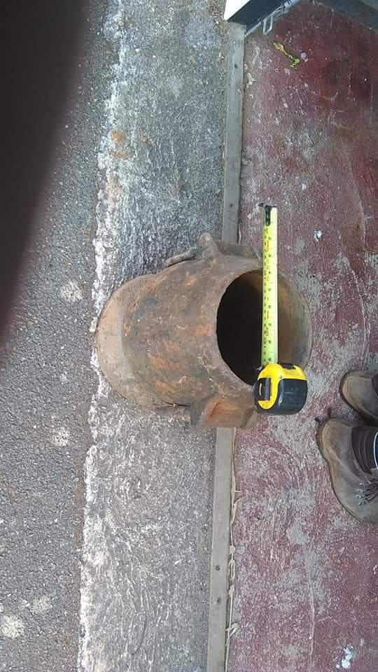

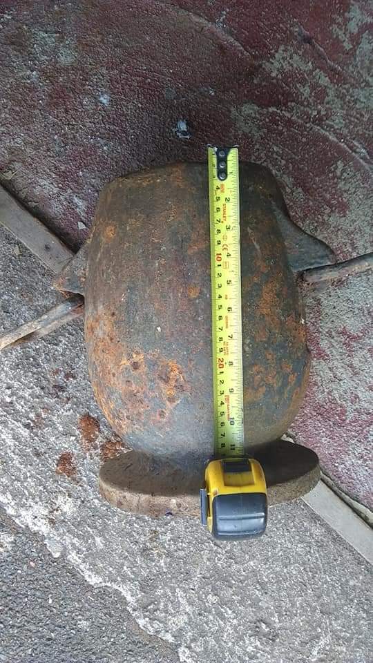

Hi , it is a container of some sort, can see where you are coming from thoughIf I had to guess I would say it's a large pump discharge pipe connector.

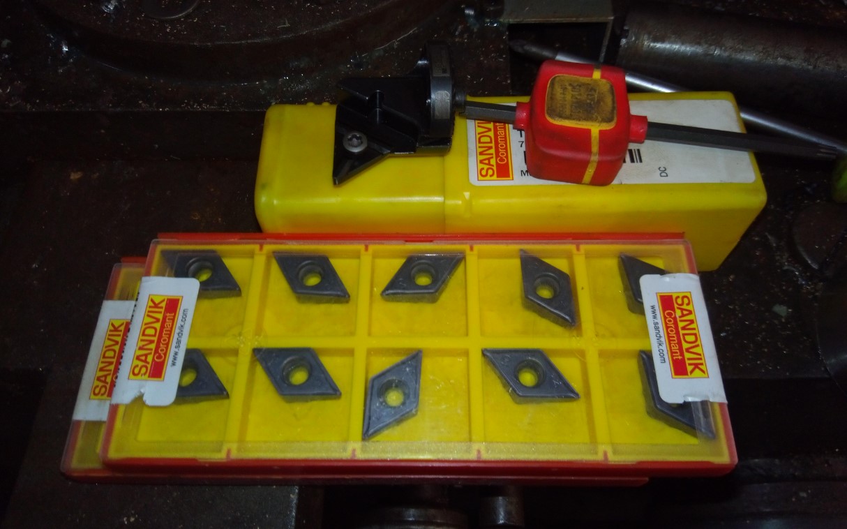

These turned up today, cost me just over £100 which seems quite expensive but the SL head alone is over £200 list price.

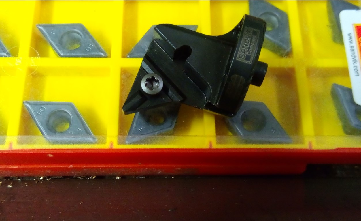

The insert seating is interesting.
And the underside of the inserts to match.

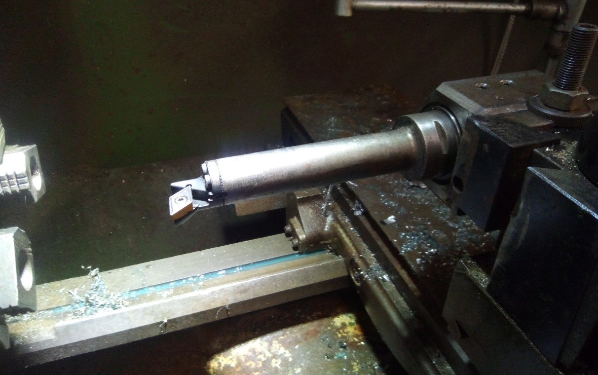

They are for the Aniti Vibe boring bar I got a while back for free.

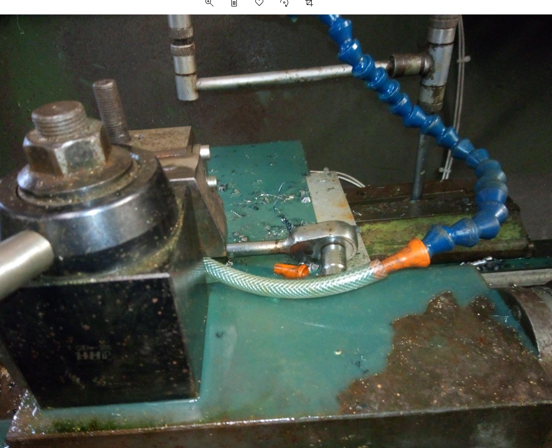

Temporary coolant connection for testing before I rig up a better connection.

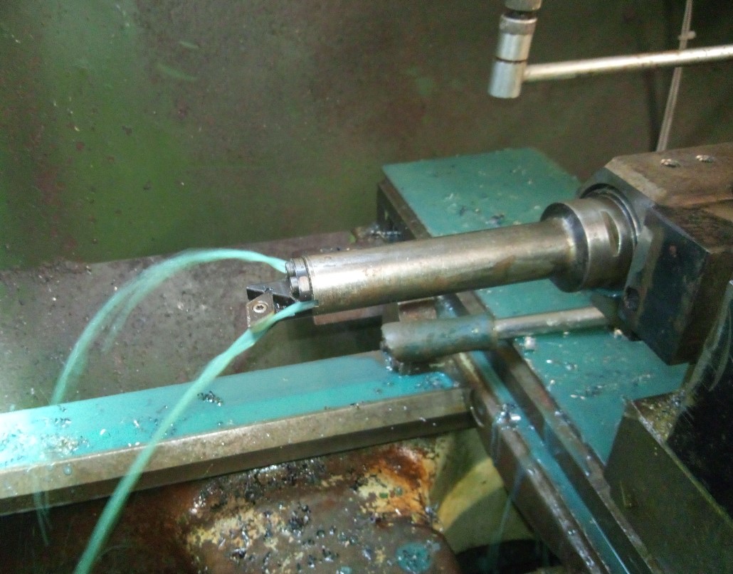

It works.
I am well impressed with the bar, 1mm DOC in some steel pipe.
