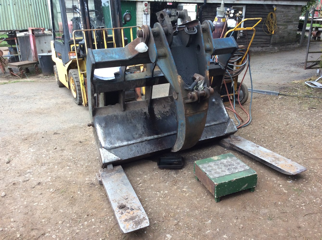

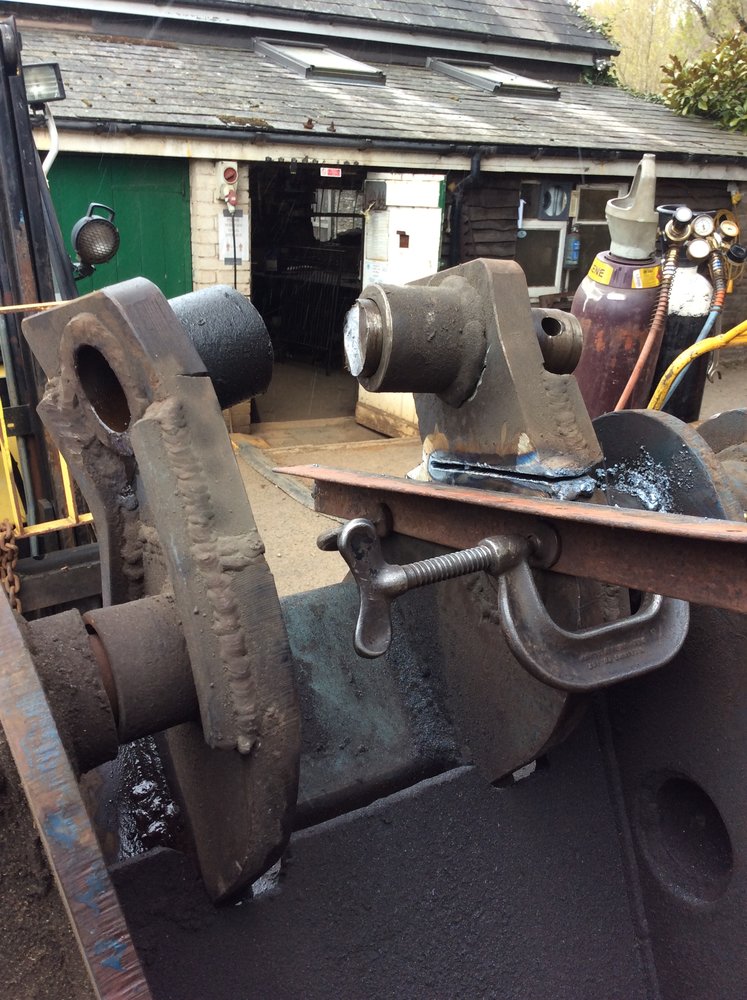

This log grab,it’s sheared it’s 45mm pin,and bent/cracked the mounts,almost too big for my fork truck.View attachment 283067View attachment 283068
That's taken some force to do that.or a special kind of special! I work in a quarry from time to time with people who could do that for funThat's taken some force to do that.

Looks like it's had some reinforcing done in the past already. With the plates on the outside of the brackets?

By me,3 years ago,tomorrow I’m going to check all the pins are parallel,make sure they’re not fighting each other.Looks like it's had some reinforcing done in the past already. With the plates on the outside of the brackets?
Big shovel/forwarder driving it then, or on a 360?By me,3 years ago,tomorrow I’m going to check all the pins are parallel,make sure they’re not fighting each other.
I’ve seen them driven over bumpy ground with a 1m diameter oak butt in the jaw,7m long!
Pivot steer jcb,2007,used to be an early ‘80’s case,massive beast that was.Big shovel/forwarder driving it then, or on a 360?
