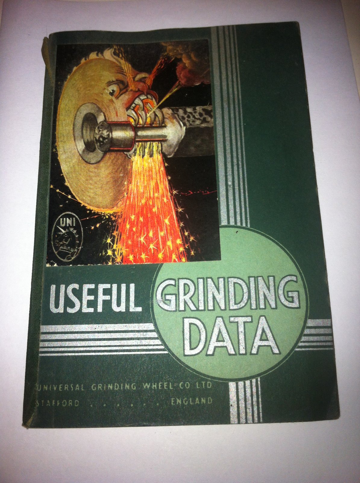

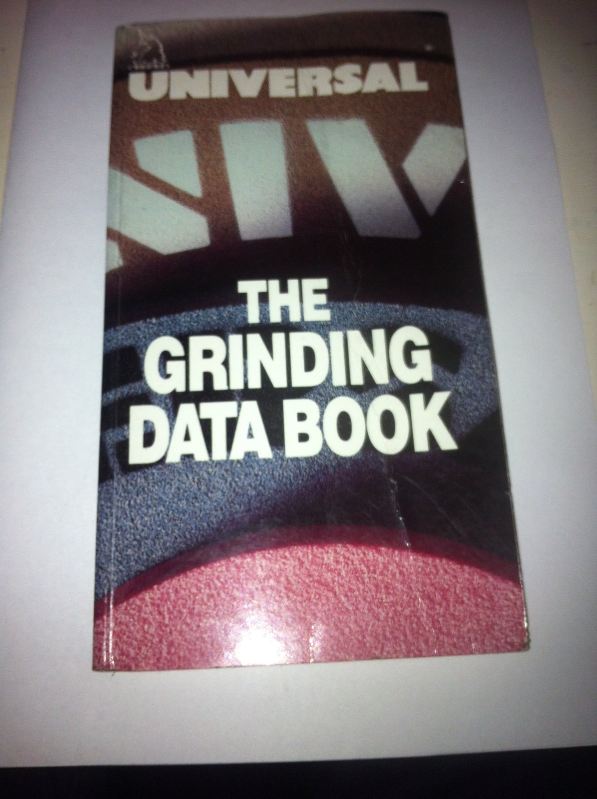

Bet you’d get some funny looks if you went into a shop & said “have you any books on grinding”A couple of little books on Grinding. Any info on the subject seems difficult to get. Love the picture on the cover.

A couple to add to your collection:
http://vintagemachinery.org/pubs/detail.aspx?id=6637
http://vintagemachinery.org/pubs/detail.aspx?id=19852
Lots more stuff on the Internet Archive. Robert Woodbury's 'History of the grinding machine' is a good read with lots of references.
