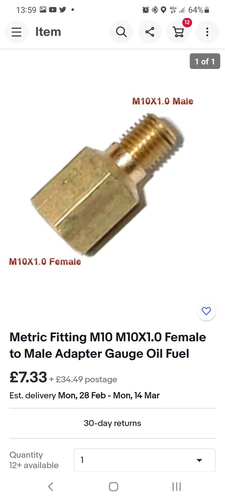

I need it to be one Male with a female on the end of it.Brass Brake Union M10 x 1 Male to Male Union

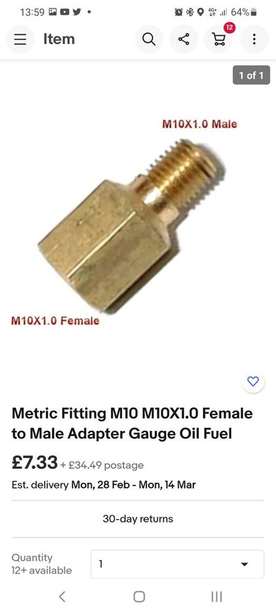

I don't suppose you can find a link to 10mm 1.0 threads that look like this.
I would like to do a repair with a helicoil and loctite a fitting in but retaining the facility to remove brake lines if needed without pulling the threads out of the calipers.
View attachment 333623View attachment 333624
