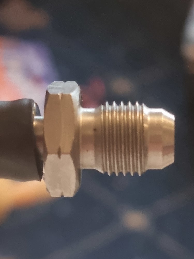

I am looking to replace the threads in Brembo Brakes and need M10 x 1.0 internal thread. With whatever they come with outer thread.
Helicoil is a lot cheaper but I am not sure if they are good on brakes.

Interesting have you got a photo of one. I am not sure what you mean female banjo.?

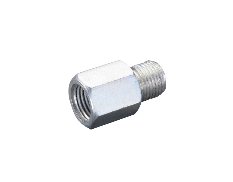

I see now. I did a search and thought I could see what you meant. It's the fact the hydraulic lines have a male cone in the caliper they seal to.. that confuses me.Something like that in 10mm/10mm
Fit the banjo bolt into the helicoiled part with a couple of copper washers and then you won't need to disrupt it again as you can remove the hose from the banjo if required.
Or, use a nipple to do the same job.
It might be tricky to find a m10/m10 one of those though.
Probably easier to find a nipple first as if you can only find m12 male to m10 female then you would want a m12 helicoil fitted.
I have used nipples before that I think were 3/8" male and the 3/8 helicoil is close enough for an existing m10 caliper hole

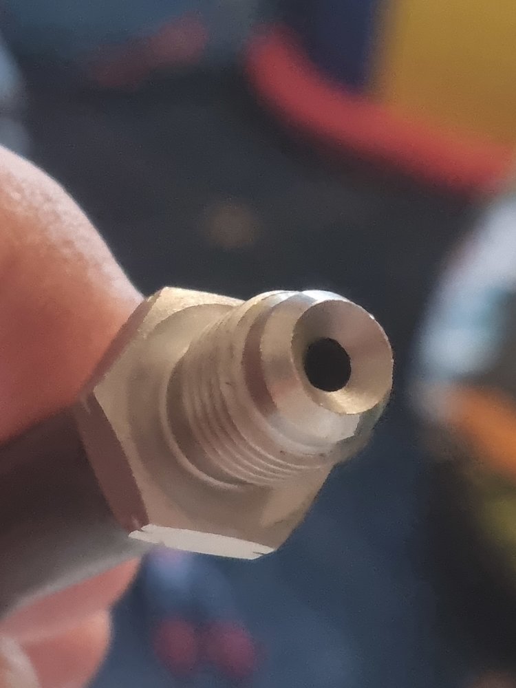

I don't suppose you can find a link to 10mm 1.0 threads that look like this.I use 'Torques UK' on evilbay for most of my brake and fuel pipe/fittings. Very reasonable compared to Earls and Goodridge.
I would like to do a repair with a helicoil and loctite a fitting in but retaining the facility to remove brake lines if needed without pulling the threads out of the calipers.
