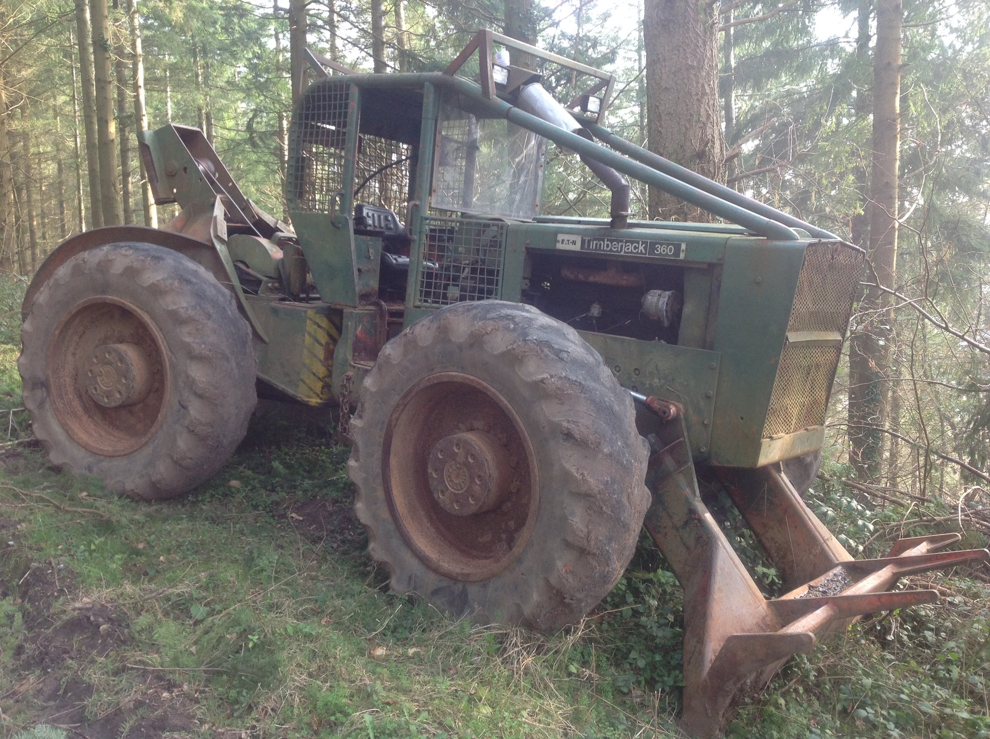

What sort of RPM is a good speed for a capstan?
The capstan I used was engine driven off the crank in its original application so I assumed 1000-1500 rpm shaft speed, because the little engine is no match for the original in terms of torque I bought the version with the reduction gearbox so it could be run at 3000rpm without increasing winch speed. I hope this makes sense, I am old you know
