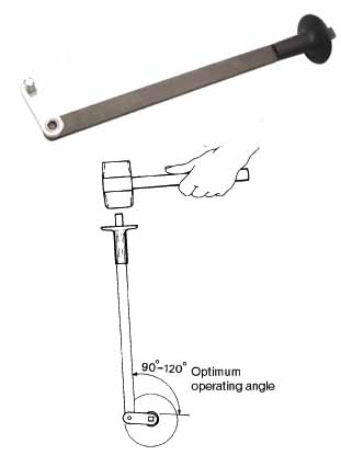

View attachment 191216 This might be ur answer iv used them for areas I couldn get into with the gun or not enough space to turn a big bar and they work very well and not to expensive either
Never seen one of those, looks like a handy get out of jail bit of kit
Very handy as they apply a shock in the same way and impact does only slower and they fit in awkward spaces
What make is it? I know some are discouragingly expensive.....and it's a left hand thread. Some I've seen seem to offer a limited tightening torque, which of course in this case would limit their loosening power. Or am I, as usual, missing something?
