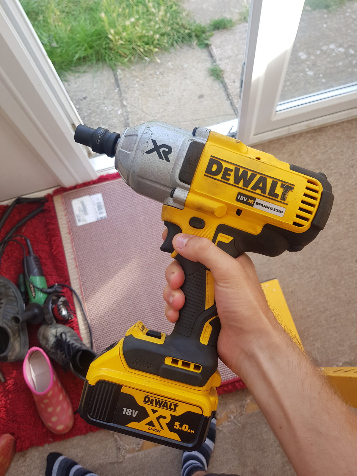

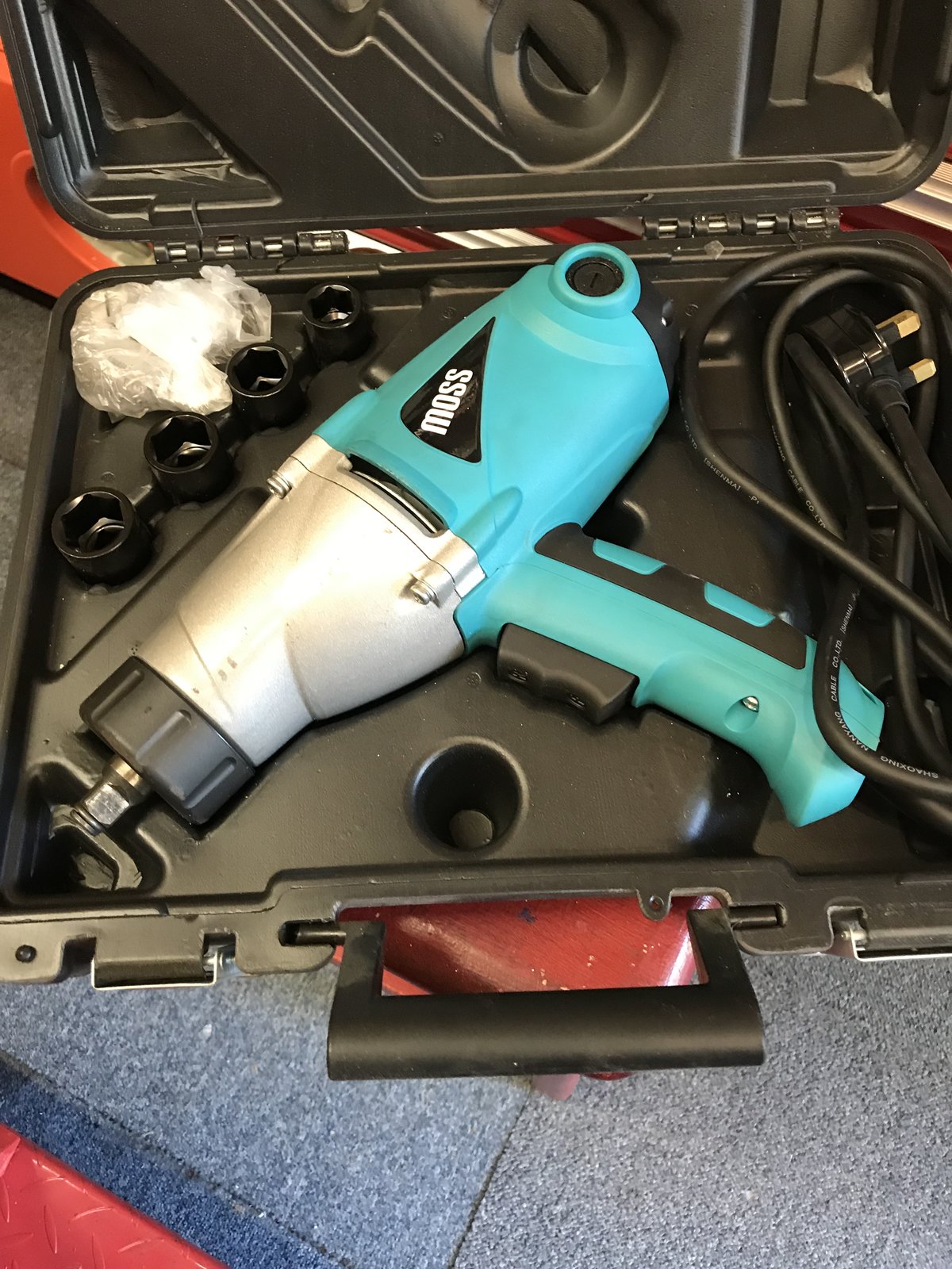

..save your money and choose from 3 guaranteed ways to remove. 1..repeated hard blows from a high end impact 2..a breaker bar as tall as yourself so mathematical magic converts it to a couple of ton pulling power. 3..my favorite which is just plain old cherry red heat
