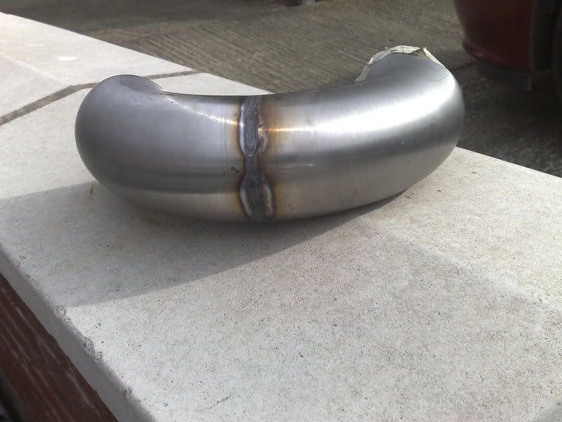

Snowy's right re "lift" on the V145. "soft" and "crisp" are for stick welding.
The lift setting lowers the OCV, but also drops the current until the machine detects a closed circuit, then puts in the full weld current. Makes tungsten sticking/ inclusion much less likely than good old fashioned scratch.
My big ole V200s had no such facility, but it can take a pedal, which is a winner.

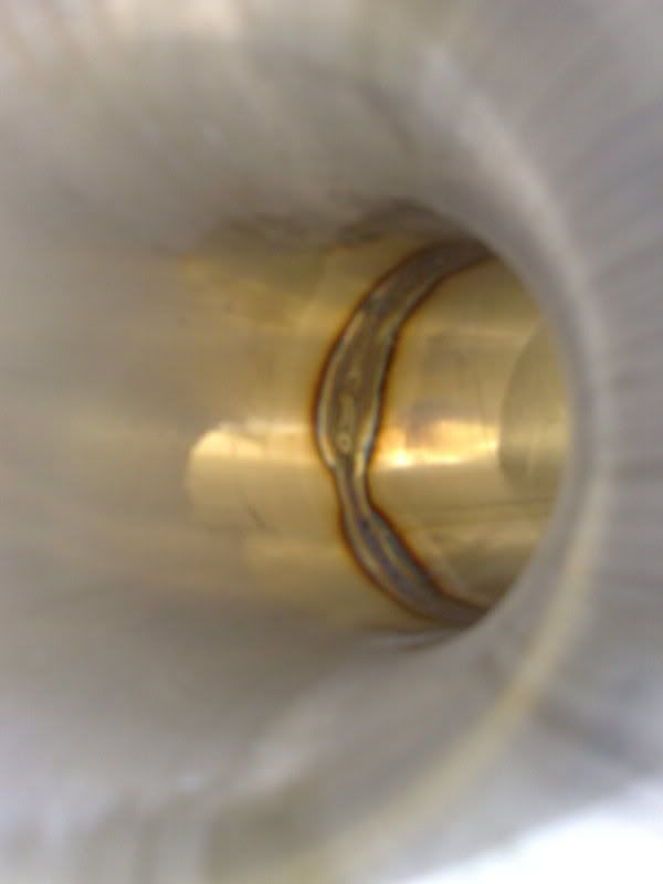

12 Litres per min, is plenty for tig, maybe a little too much, about 7-10lpm is optimum....I don't think your problem is too much gas, maybe too much current? How was your purge for the pipe that turned out worse?
