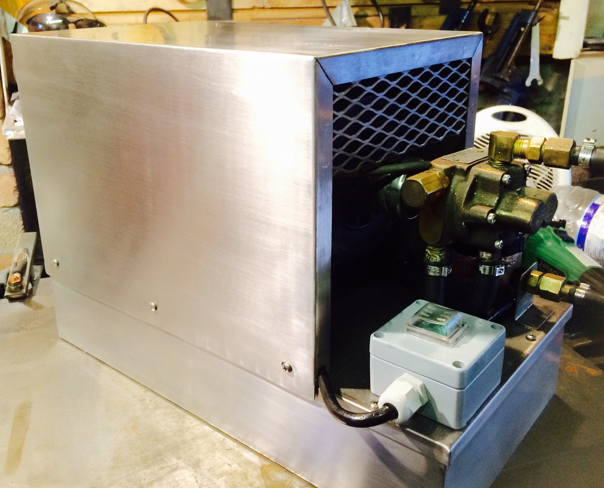

How is the beer cooling project progressing mate
Gas cooling is alright for a bit of DC and light AC but it's crap really in my opinion. You should investigate your pump further if you can make it work. Once you put 200 amps down a tiny wp20 on AC you'll never back to a gas cooled set up again. Everything about water cooling is nicer apart from the initial expense. Consumables last 10 x longer
Just found this thread, much good info here. How's the hose stiffness with water cooled setups? A 17 air cooled with a superflex and pedal really only needs the one hose and seems really flexible. Fighting my torch and it's stiff cover cable really makes me think a flexible cable is super important.
Power supply for what?Sorry to BUMP this. What power supplies are people using?

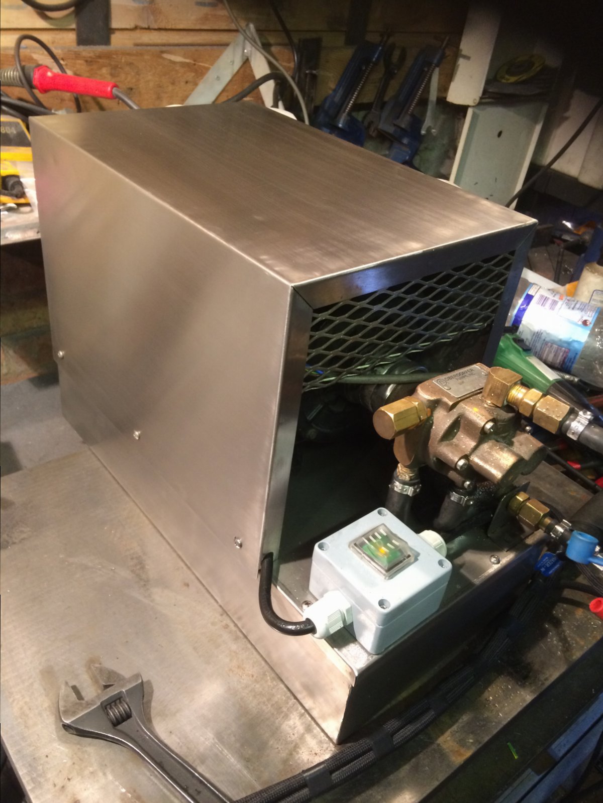

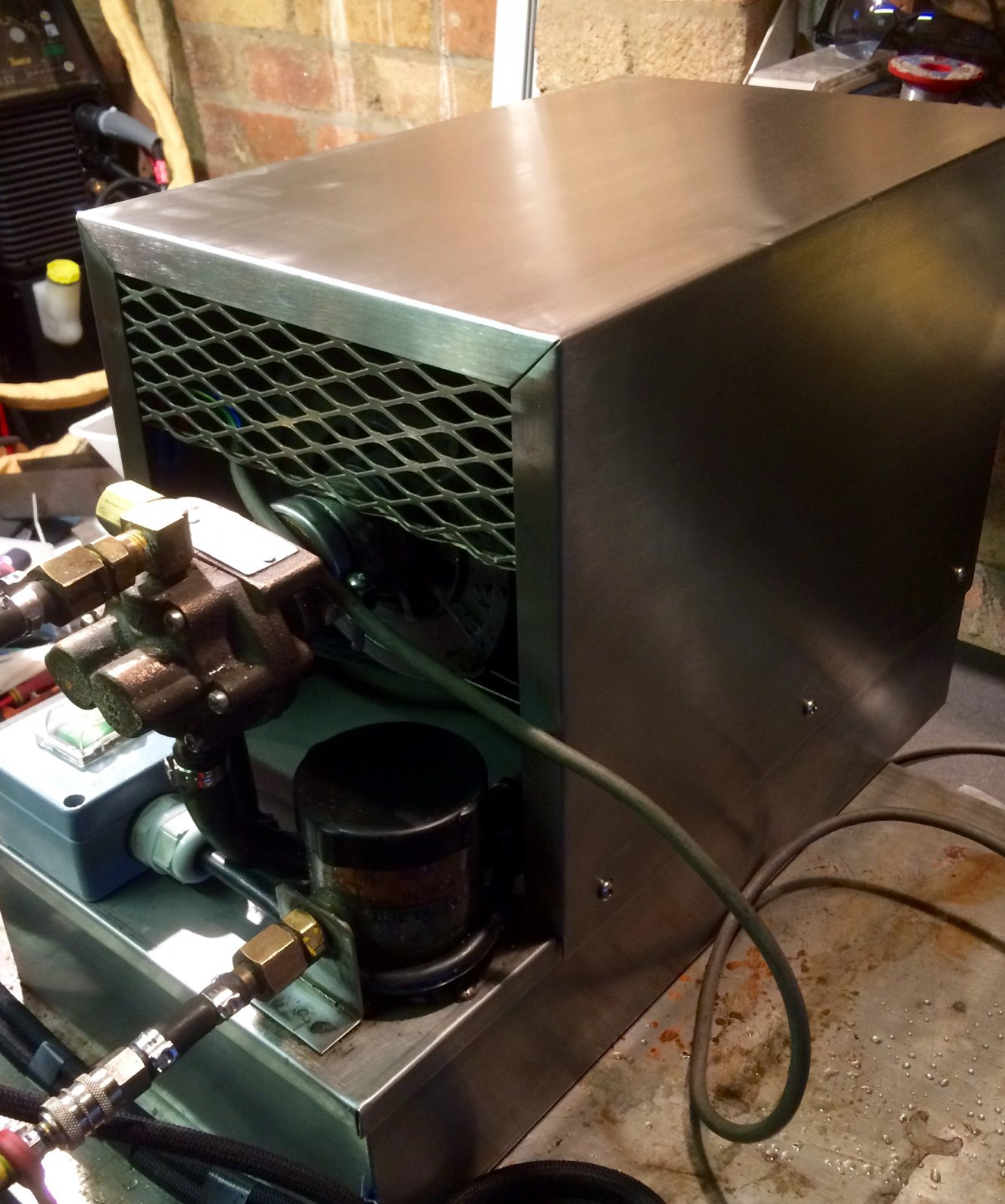

They are awsome coolers. That pump is just excellent. It's gear driven so other than a couple new seals it's bomb proof. Really nice adjustment too can put out anything up to 250 psi. Motor is the powerful 1/3hp and it's a full 304 grade construction. Very basic thing in standard form, not even got an on/off switch which I'm in process of changing. Nearly a grand new to buy!!!Very good coolers, standard fitment with the old hitachi's
Top man. Look forward to seeing your results. I expect to see a beautifully welded up water tank. You've got weld on fittings I assume so it should just be a quick easy job.i've bought everything bar the power supply as it stands richard.
It would help if we knew what the pump was giz.Yes, Weld on fittings for feed and return. Also have an additional bung fitting for the tank water temperature aswell.
Im just stuck on what power supply to use now.
If his welder is 230 v and doesn't have an aux socket I'd put a socket on the cooler and plug the welder into the coolerIf your welder had a aux socket on the back for a water cooler I'd go for a 220v motor and pump.
