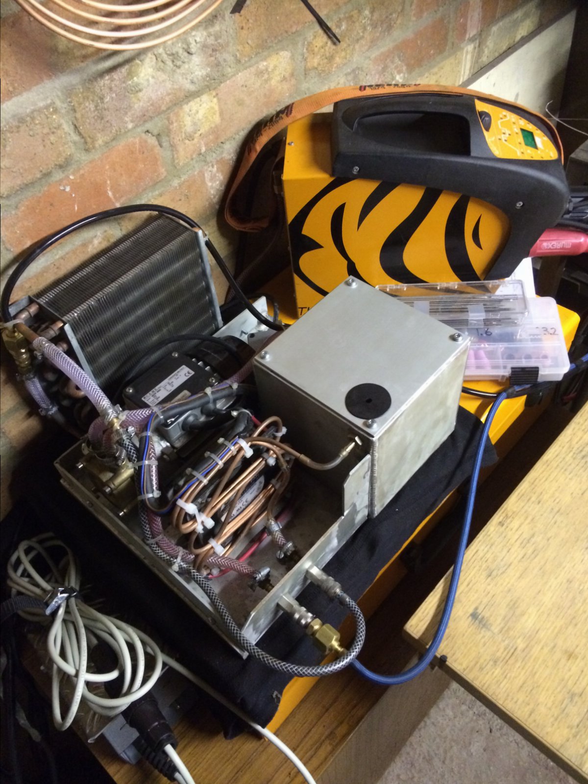

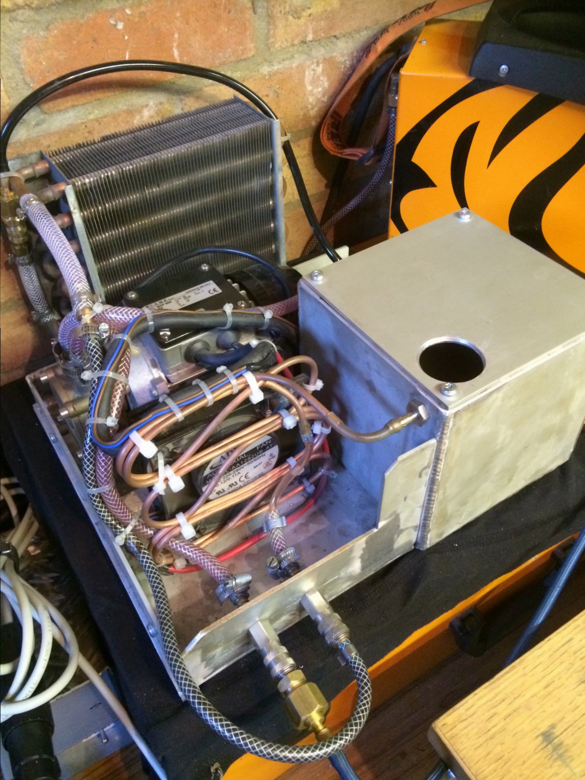

Well the coils of copper worked fine on the last one with the pulse pump ive used computer rads and they ain't much better than this.I don't know why you don't use a radiator like everyone else. It's more efficient than coils of copper pipe and they must be available cheaply in the tiny size you need?
Motors got a fan.It would if you rotated it so the rad fan blew air over the motor.
NA. It's a wonderful thing. And with that big rad could cope with twice what the machine can put out. I do wish Id opted for a pulse pump as they don't generate any extra heat so the worst case scenario I sell the pump and buy what a want and ditch the big rad or I just paint it up and leave it as is. I don't intend on moving it around. I've got my gas cooled 17 for mobile work so it's not all gloom. Might swap pumps and ditch the rad or might leave it alone with big rad.Sell it make another one haha!
I could do that with this exchanger if I wanted but again it's not what I want. I want it ALL inside the box just like the other one I built. I've looked at other coolers that use this pump like the parweld and Tecarc coolers. The pump is kept miles away from the rest of it in an open grill at the bottom and the coolers are huge with big rads and now I see why. My mistake.Could you not get a smaller exchanger, and bolt it onto the back of the water cooler with just the two lines coming out of the cooler? If that makes any sense?
Yeah I know. It's like a 150amp mma welder in size. It's really smart. Id defo have another.That tiger is a seriously compact bit of kit!
