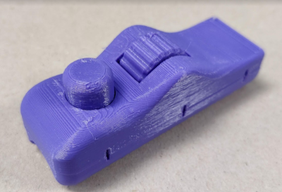

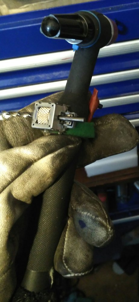

It should be a simple problem, but with the limited space, it is not!
Seeing @Dr.Al 's version in the 3d print thread has got me thinking about it again.
Here are a few ideas that I intend to try.
1) A linear slide pot mounted on the side of torch. They all have a bit too much travel at 35mm+. Im thinking a lever to reduce the travel and a button underneath the lever. This may be the easiest to get working, I need to order a few pots to experiment.

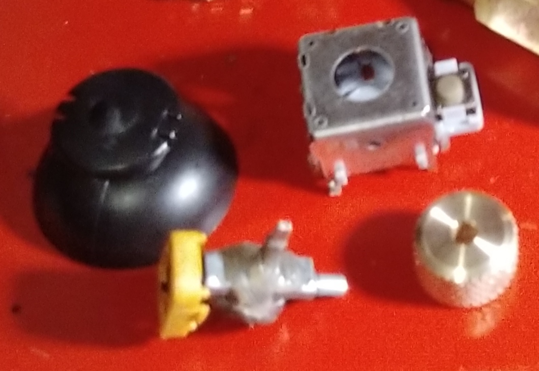

2) Mini thumb joysticks may work, may be too sensitive, free moving and truncated range? They have a button built in. I have one from an old game pad I will try, they are 10k ohm. It would be nicer if the control stayed in position and this is sprung to centre.

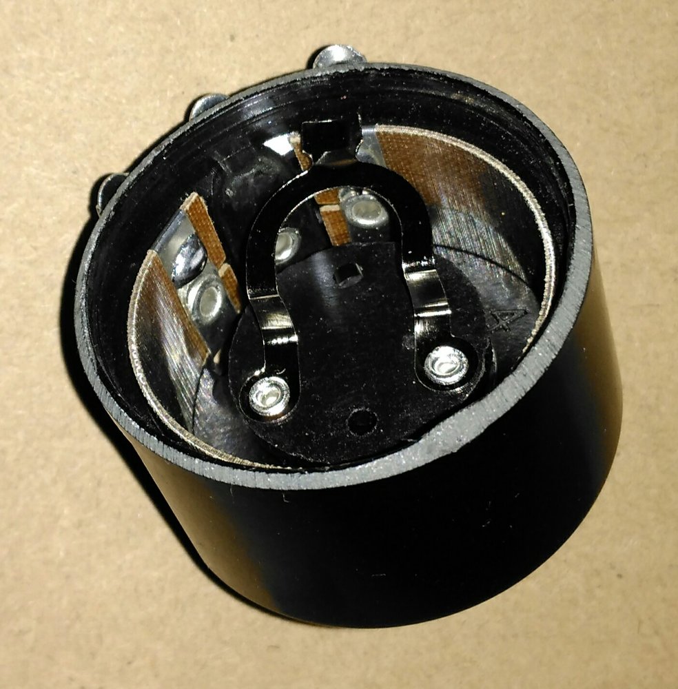

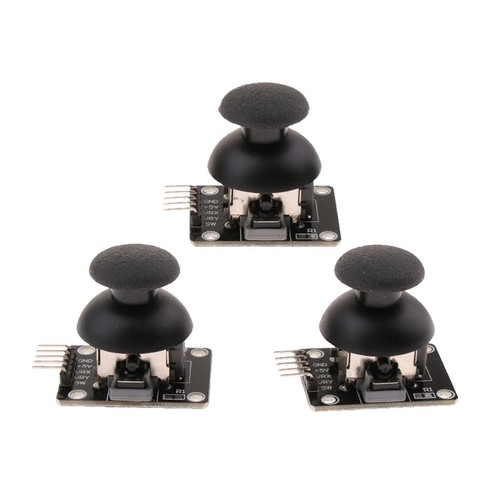

3) A wire wound could be dissassembled, and put around the torch. A tube with a shoulder could act as a bearing/housing for a tube shaped wiper, sitting against the wound coil.
This one is 10k but the travel would be too big, would it matter?! but a 50k would have about the right travel. I have a smaller one but its only 4.7k, so awill order a few more.
5) Pcb slide resistor. Many small smd resistors and traces to a slider. This is from a drill trigger, only 8 steps, I think it would be enough. Possibly the smallest way. A tactile button would go on the slider. To do properly I would draw up the pcb and get them printed by JLC or a similar service. As its a small part, it should be quite cheap to have many made. I have a roll of very tiny smd resistors already.
I dislike carbon track pots, its hard to find any that last and I dont want to be replacing it often, the wire wound and pcb ideas have some advantage.
