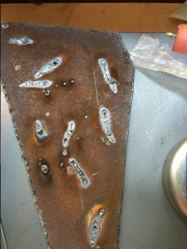

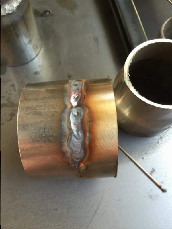

Right. First off leave the tube and the SS and the joints for another day. Your not there yet. Secondly the pic of the steel you've put some beads on. Seriously how can you expect results on such a rusty plate. That's just not going to work for you. Tig at the best of times needs perfect clean metal to weld but that plate your showing would be a nightmare with some of the most forgiving processes
