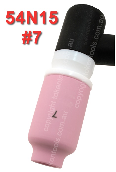

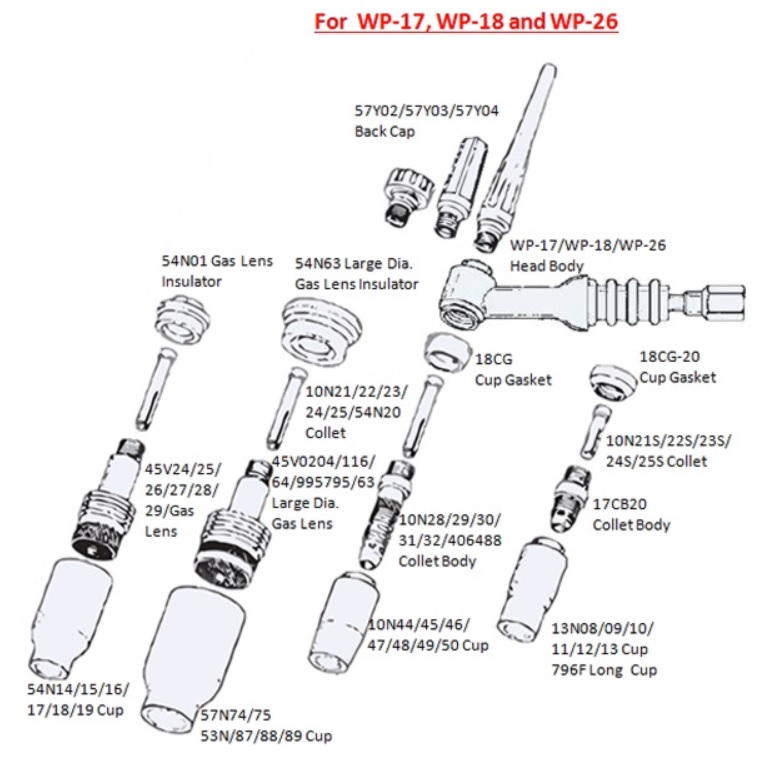

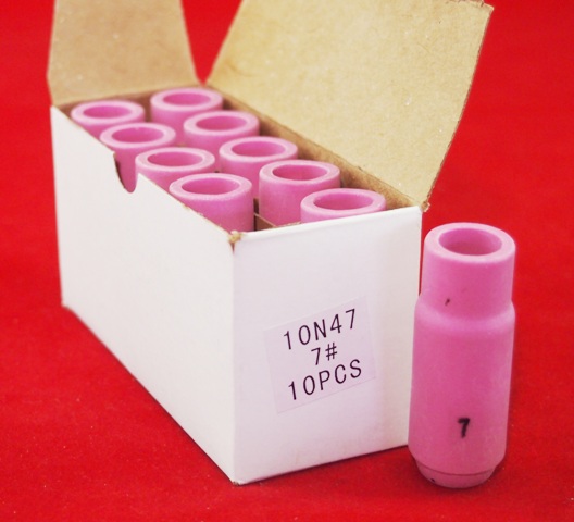

J Jack Ryan Member Messages 752 Location Adelaide, South Australia Nov 17, 2021 #3 paulo1974 said: Hello I bought a 7 of a 54n15 cup. I know that the cup number seven has a hole of 7/inch . What the rest of of the numbers stands for? Click to expand... Aside from the 7 (7/16"), I don't know how to decode the numbers but they are just part numbers. 54N12SW #10 cup 54N13SW #9 cup 54N14SW #8 cup 54N15SW #7 cup 54N16SW #6 cup Those you bought must be for a gas lens. Here is what you bought And here is another more common No 7 Jack
