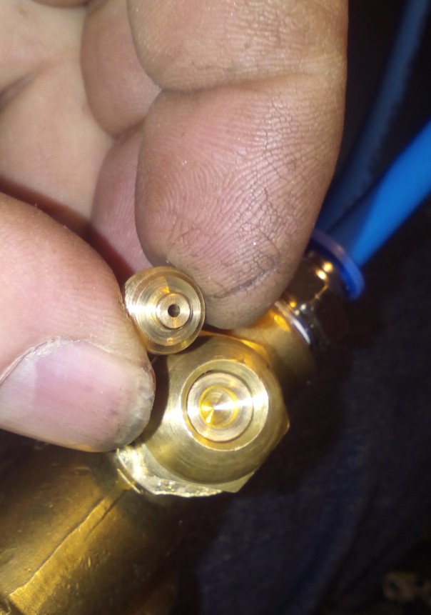

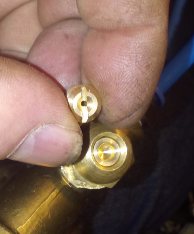

Pics please hood of your connections. Now it's rare but sometimes there can be a bur in the head water jacket causing a blockage.I think it much more likely it is the torch but can't be 100% certain yet. Other people use the Quick Release fittings so it is unlikely them but I will see if I can find a way to hook it up without them later on, might not manage though as I am at home and do not have access to my lathe or other fittings.
I have just tried flow through the 6mm ID pipe, I fitted things up with the pressure gauge still in the loop and the pressure was 30 psi where when connected to the torch was 60psi. Flowrate was 2L in about 15 seconds so that would equate to about 8L/min.
So to me it looks like the torch is the culprit.
Also likely the Chinese pump would have been fine.
Also looks like even the central heating pump may have been adequate although obviously not as good as the Chinese and no where as good as the Procon.
