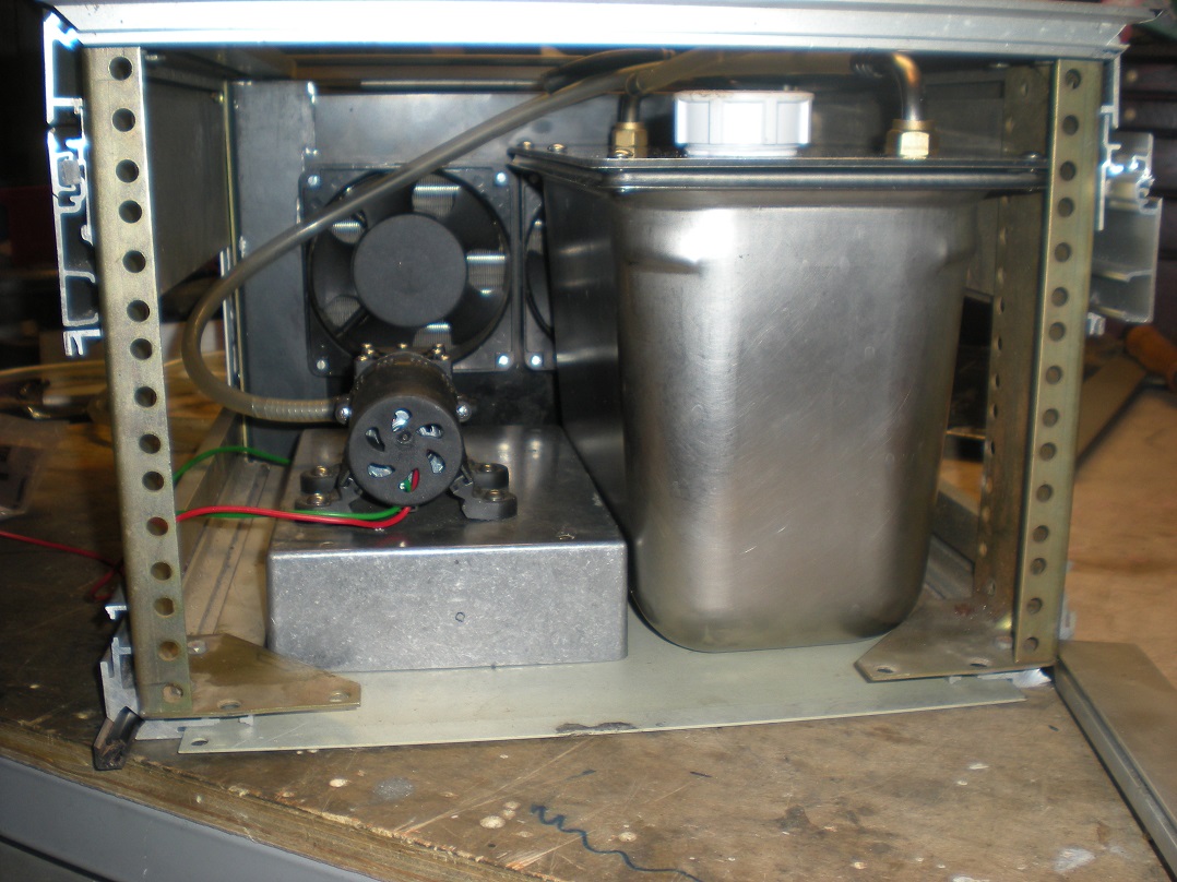

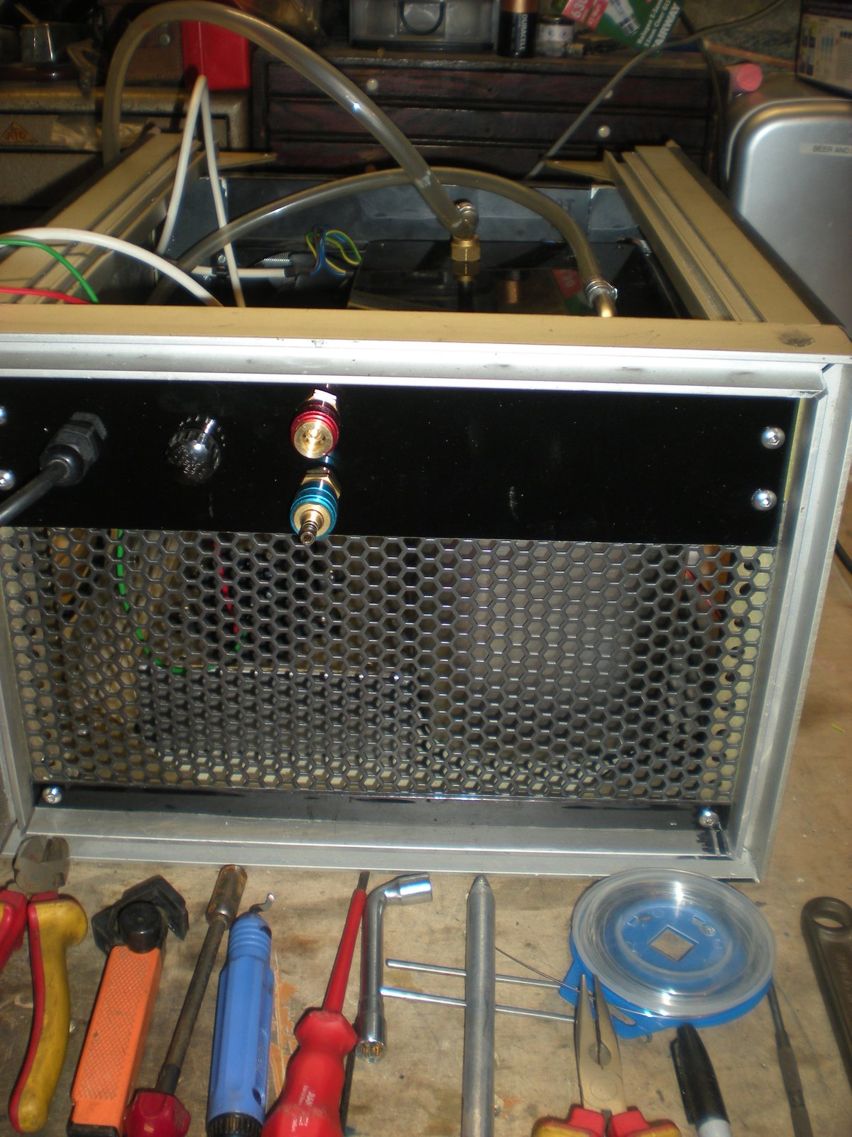

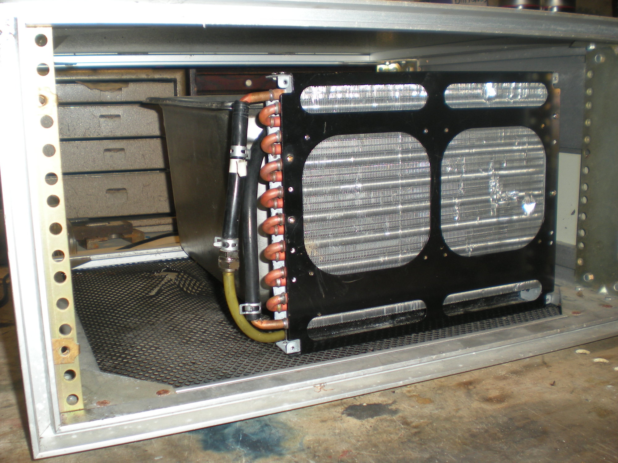

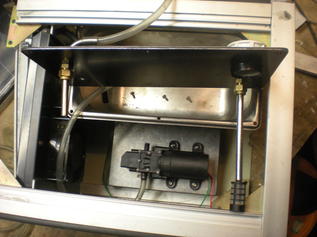

Thanks Optima, ordered along with a pressure gauge and a flow sensor, plus an adjustable voltage regulator to take a Dell laptop brick down from 19v @ 6A to what the pump will need, and a 12v VR for the flow sensor - I can cobble up a circuit to drive a flow meter and operate a low-flow alarm sounder, I think...
