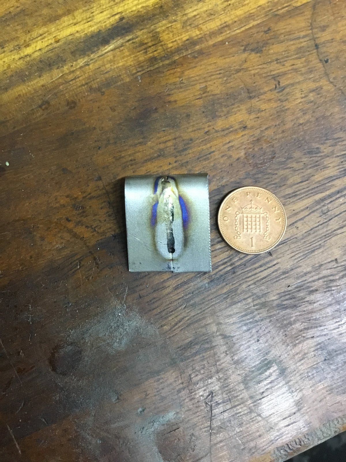

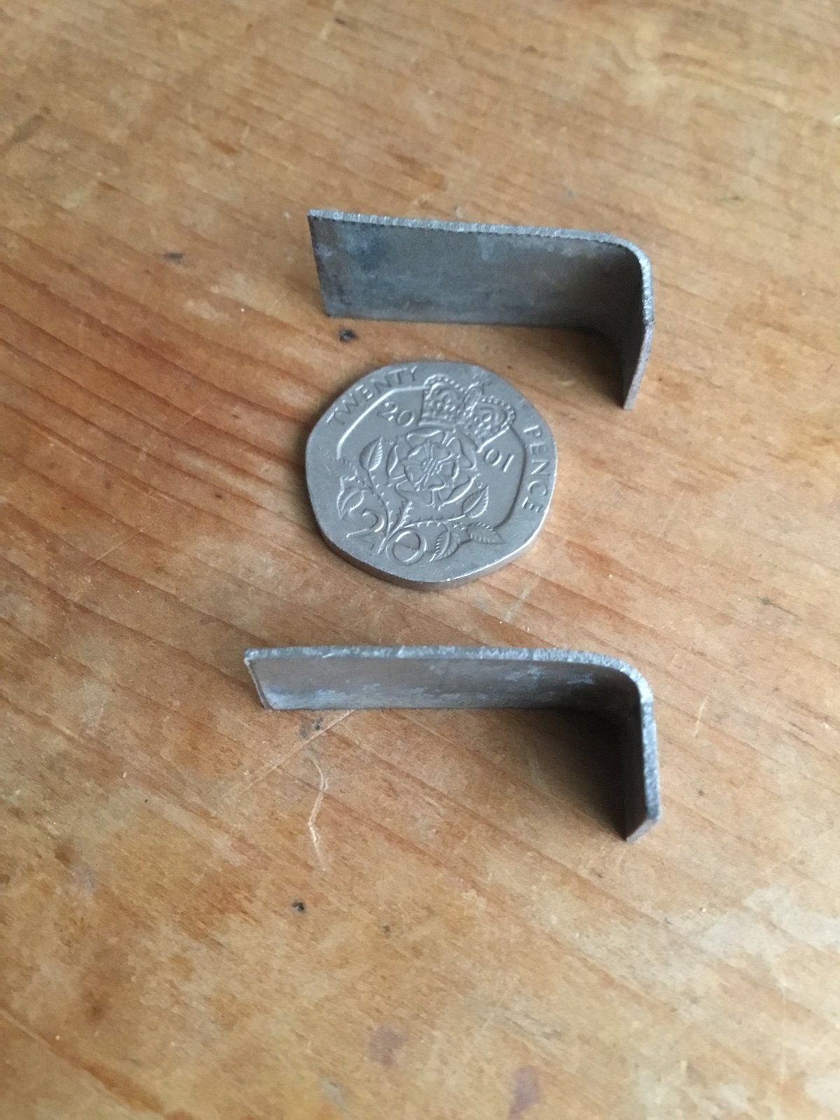

Weld Snapped like a twig
Did you back purge?
Yeah the oxides are incredibly tenacious. It has to be purged, even if not full penNo, and it wasnt full penetration 90-95%. I did expect it to break but not as easily. It has crystalline appearance

I’m not an expert on the stuff but it looks too heavy on the oxidation around the outsideMaybe not
