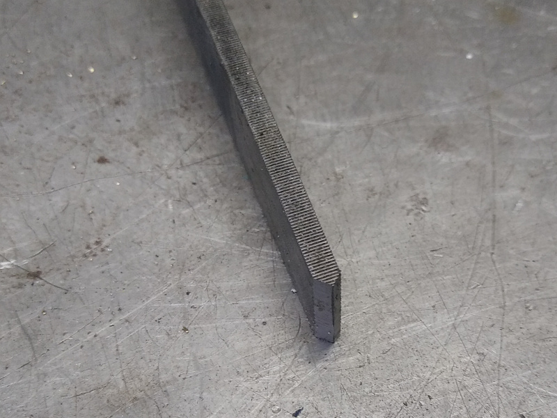

Here's my Briggs & Stratton valve clearance adjuster. You just remove the cover and wiggle this into the gap. The valve opens under spring pressure then you just file until you get the gap you want. The teeth are ground off one side so it only files the pushrod.
