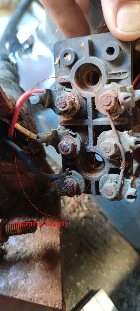

Have a look at the diagram with the yellow background about half way down this page - Static Phase Converter [Pros and Cons] - Electric Problems
I'd guess the two identical capacitors will have been permanently connected to the false phase (L1-L3 and L2-L3 in the diagram), then the odd capacitor has been connected via the contactor and time delay relay.
Determining the relative size of the capacitors does seem to produce different answers. In the diagram immediately below the one you show, they have 5, 12.5 and 80 uF. Very close to the diagram is a downloadable paper from researchgate, where they have 60, 55 and 30 uF.
What is certain is that the biggest cap. is the start cap. The only similarity between the two above is that one (L2-L3) is approx. twice the other (L1-L3).
I do not know the correct answer but I am not convinced that equal caps. on L1-L3 and L2-L3 is the correct answer.
