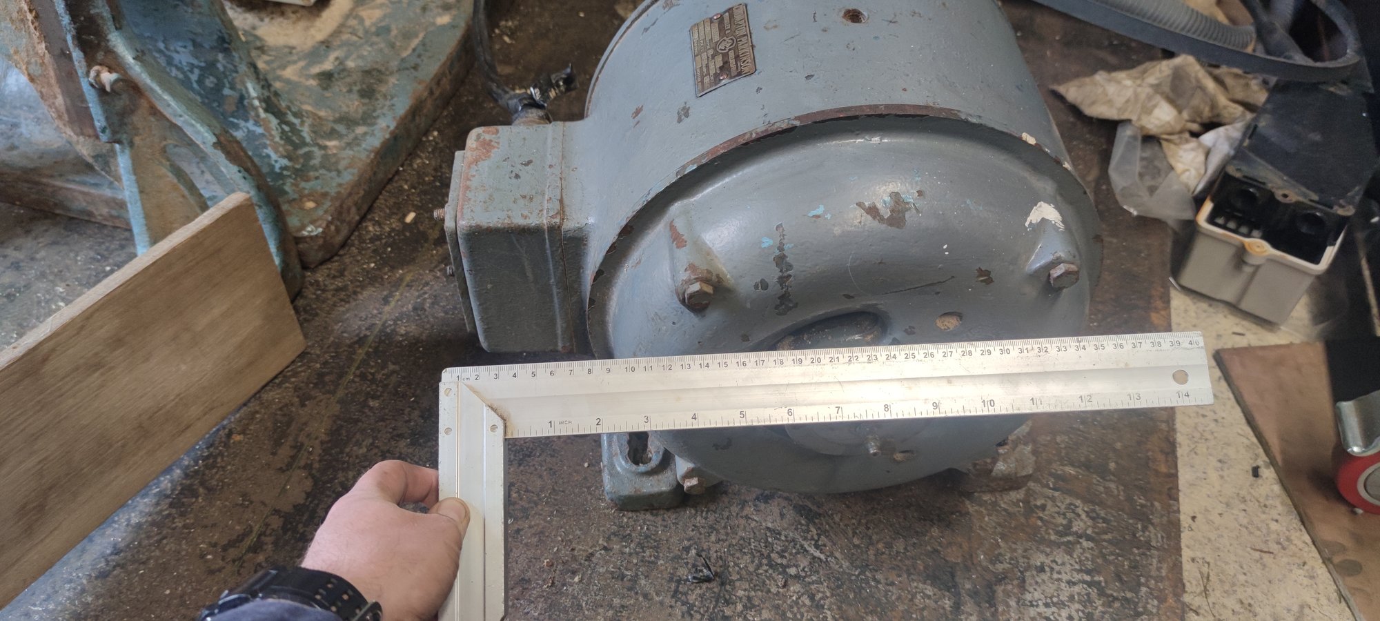

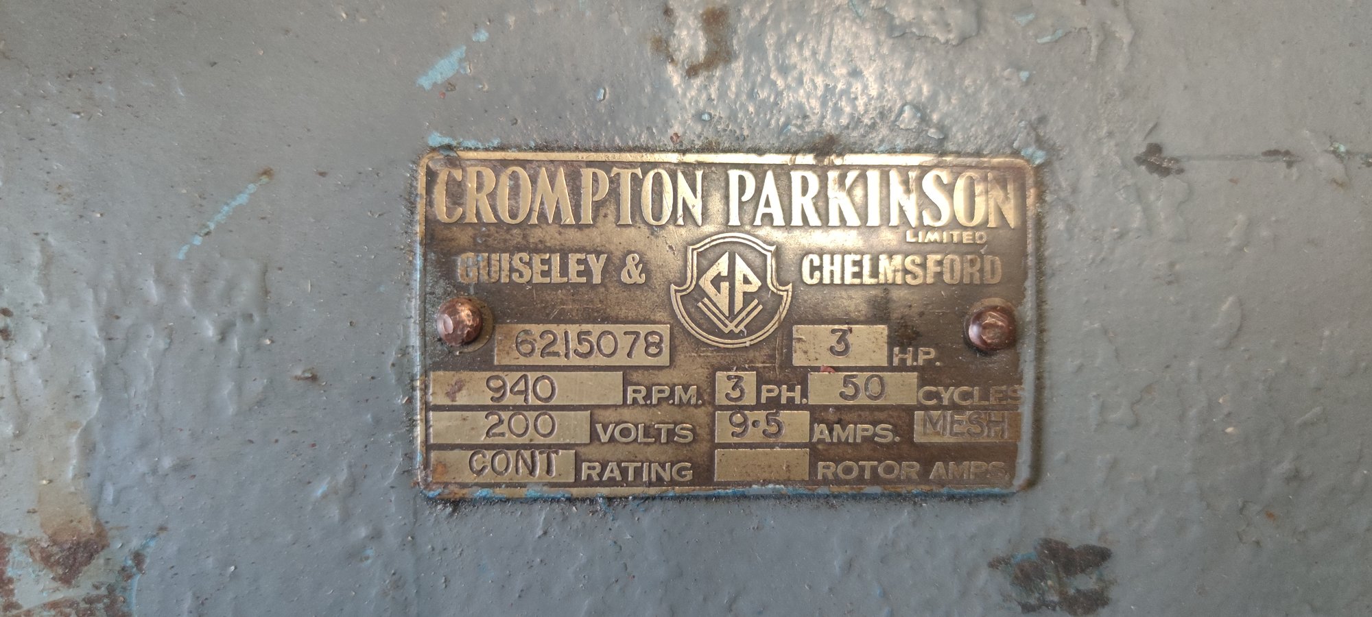

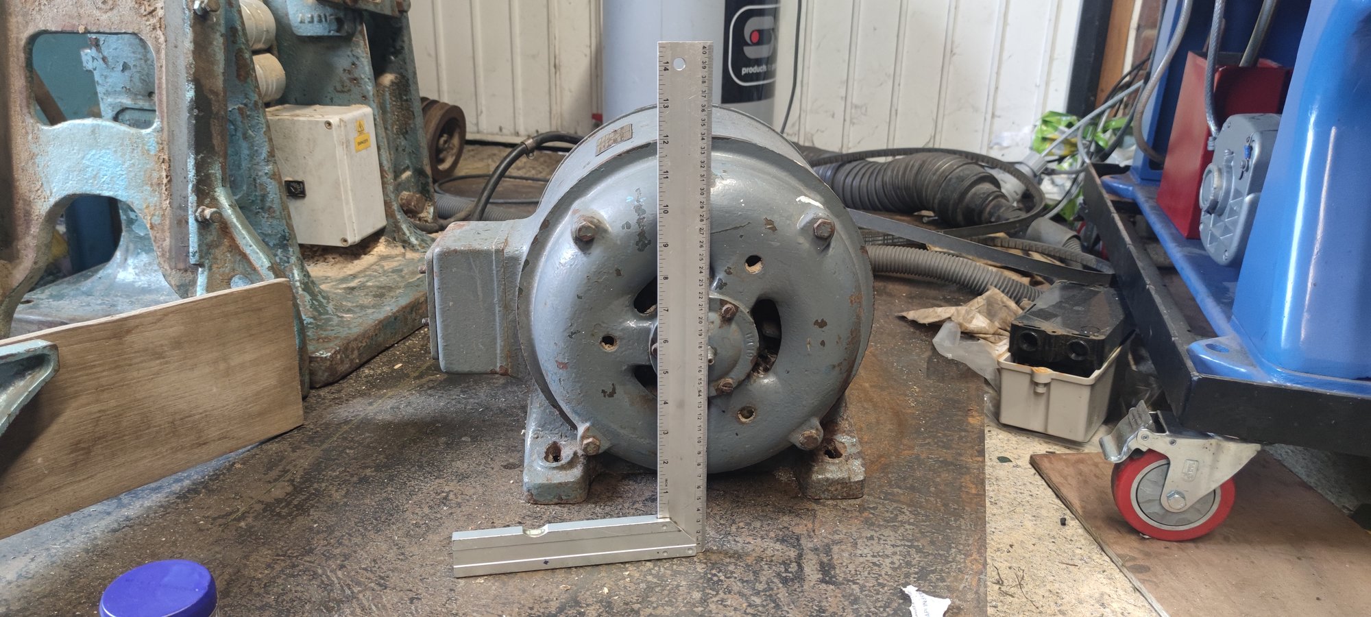

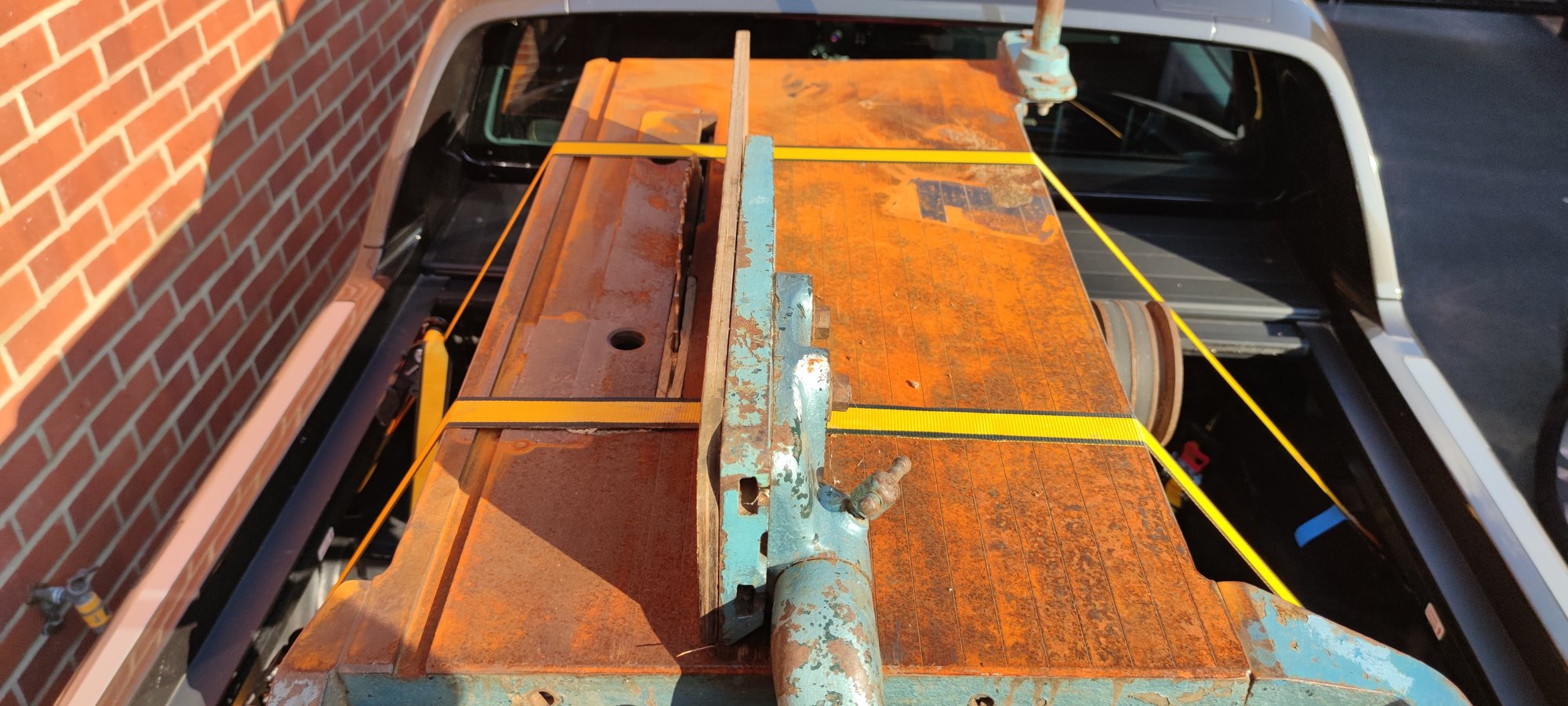

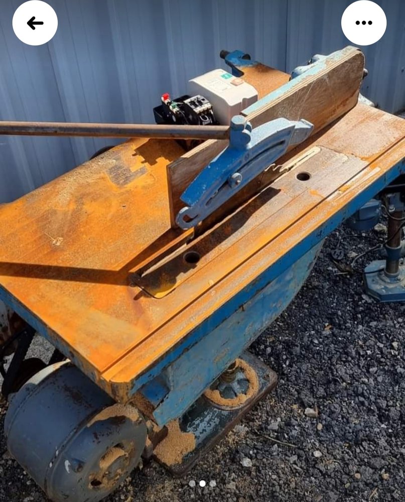

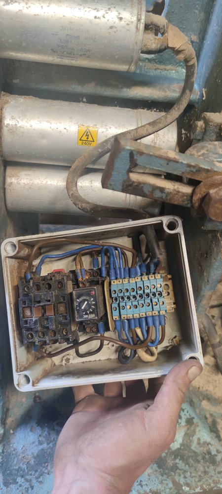

Yesterday I acquired an old Metalclad rip saw.
The motor is a BEAST!
I can just about lift it on my own but it makes my piles pop out
What I think I know
1. Three-phase motors do not require capacitors to run
2. Three-phase motors can be run on single-phase power with the help of capacitors
3. Running a three-phase motor on capacitors will never be as good as running it on three-phase power or via a VFD
The previous owner said he ran the saw on three-phase power but this saw probably had many many owners in its life.

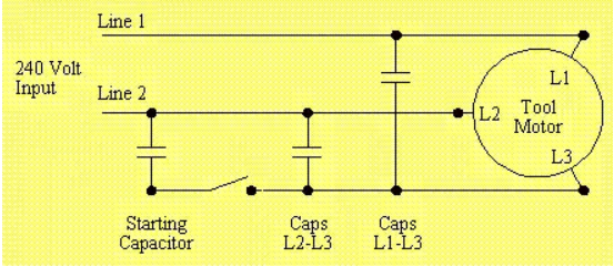

I have found three capacitors on the saw (the cable was cut and they were not in use).
Can somebody help me to wire this motor up to run on single phase with the capacitors?
The photo below shows the setup. The top capacitor has got a value of 30uf 440v and the bottom two 60uf 320v.
I assume they are for starting and running (I do not know which is which) with a timer box switching between the starting and running capacitors after a few seconds.
How do I wire this up starting from the supply?
