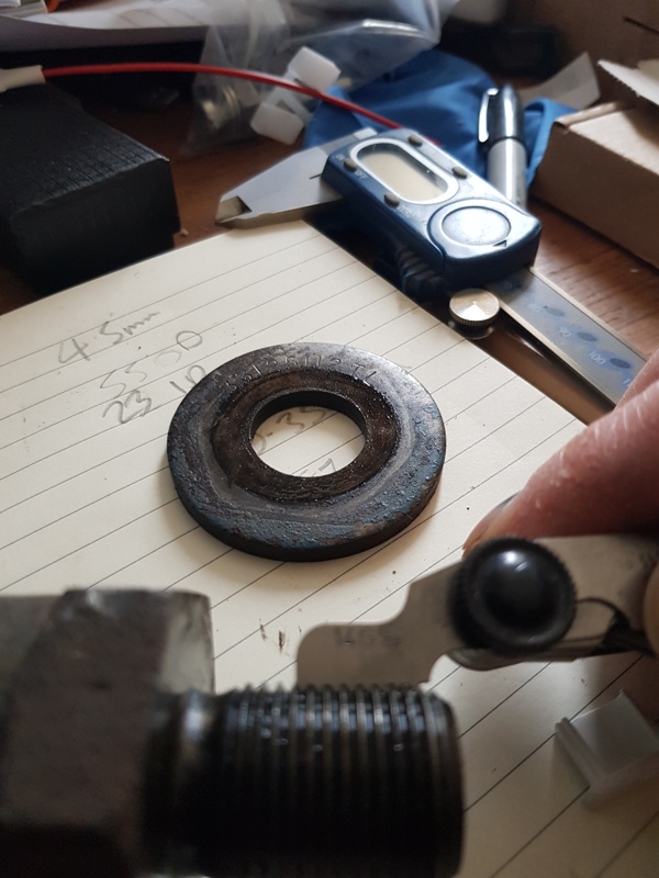

UN form is 60 degree angle. Whit. form is 55 degree angle.
The die you have bought will be UN form, 7/8"-14 UNF as discussed above.
Draper thread pitch gauges have served me well. See:
www.lawson-his.co.uk
Note that 51071 is UN only and 51072 is Whit. and metric.
If you are really keen, the only thing you need to add to those is a BA one (https://www.chronos.ltd.uk/product/ba-screw-pitch-gauge/).
Screwpitch Gauges - Thread Cutting Repair - Engineering and Precision Tools - Draper - Brand Catalogues from Lawson HIS
Lawson HIS: Makita, Bosch, Metabo, Dewalt, Power Tool Accessories, Clothing, Safety Equipment and more
