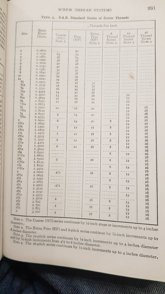

The OD of the male thread doesn't exist anymore, its been chewed off my some cackhanded spanner holder at some time in the past
There aren't 5 pitches to measure on the male thread - the last few are very flat.
There's no AF on the bolt as it just has a large head and recess to start it with a cranking handle.
The ID I have measured is unadulterated so is about the only precise thing to go off.
An OD measurement of what you have will nonetheless be useful: we can safely assume the correct one will be no less than what you measure. If, for example, it is bigger than 7/8", that would rule out the 7/8" UNF suggested above.
There are six clear and shiney (from flash reflection) thread crests in your second photo, which define five thread pitches.
ID does not tell you much, only tapping drill size and there is a range of possibilities for any particular thread.
A print of the female thread on some soft material is your best and most reliable chance of success.
