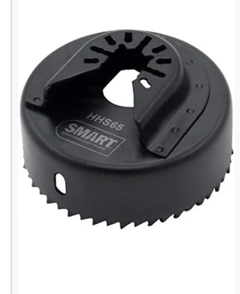

More to the point, what blade do you bolt to a multitool that produces a round opening?

Holesaw.

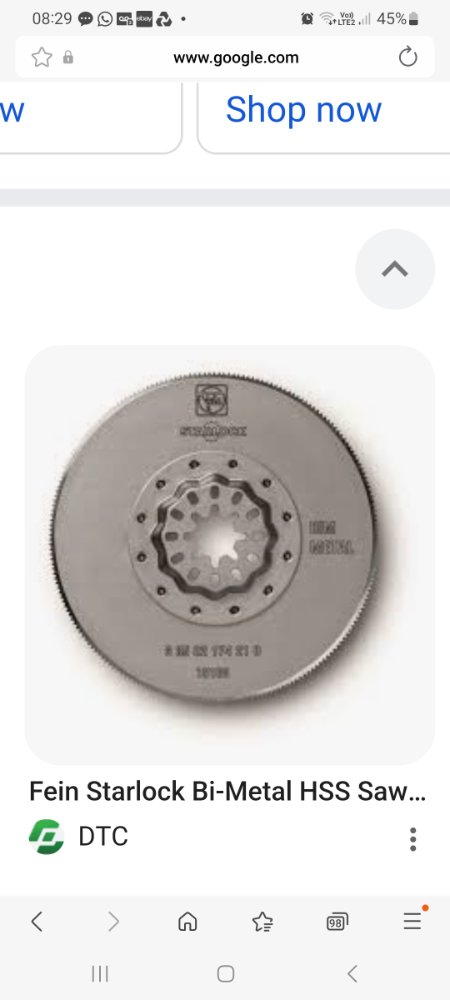

The picture attached does not look like a conventional holesaw, more a circular flat blade.
An issue with using a standard (e.g. Starrett) holesaw is that the teeth are unidirectional, so on the back oscillation, they would drag and blunt on anything decently hard.

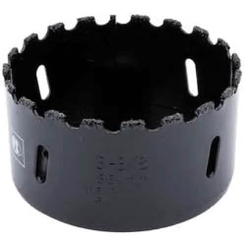

These are available, but the kerf would be quite wide, so slow cutting:
Draper Tungsten Carbide Grit Hole Saw, 86Mm Dr-34961
Draper Tungsten Carbide Grit Hole Saw, 86mm DR-34961Expert Quality, tungsten carbide grit hole saws perfect for electricians, plumbers and for general use. Ideal when drilling masonry, tiles, aerated blocks etc. Manufactured from high quality steel with a welded tungsten carbide grit rim...www.tooltime.co.uk
