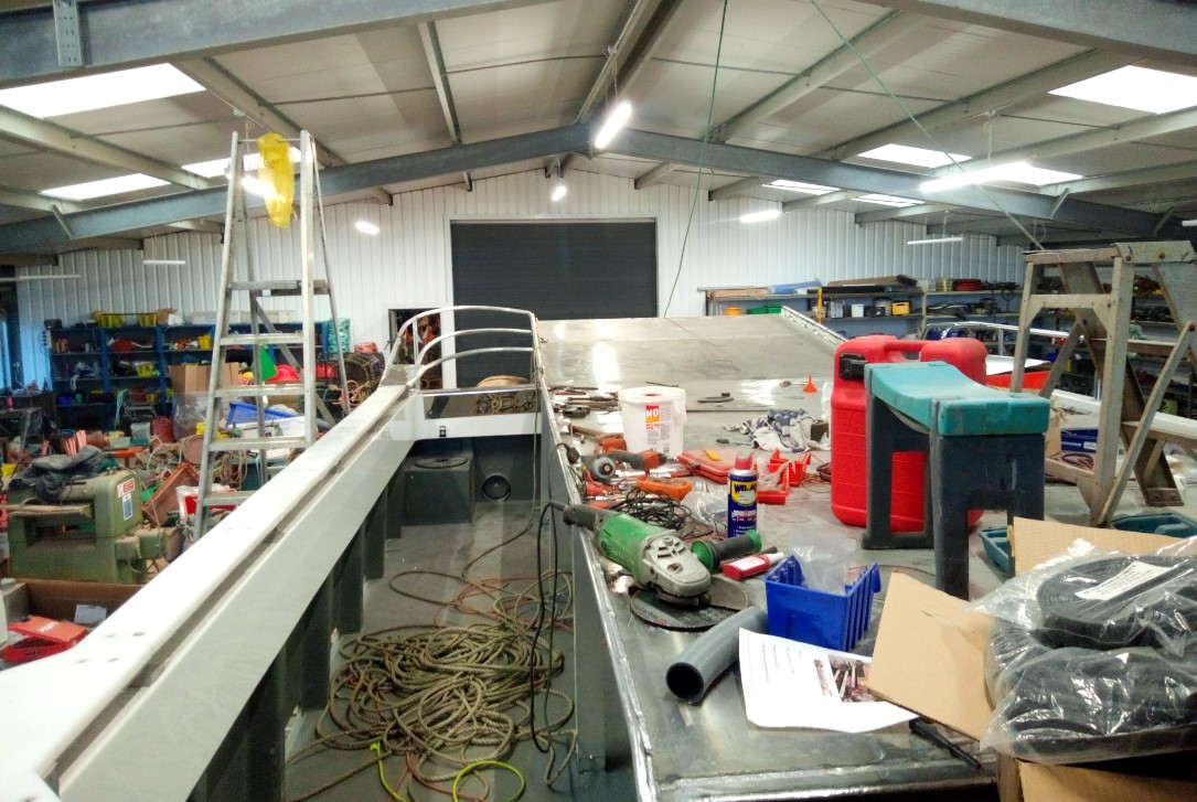

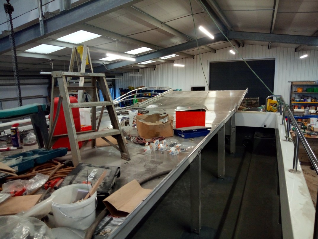

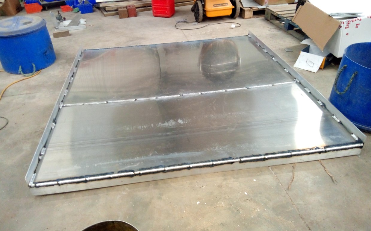

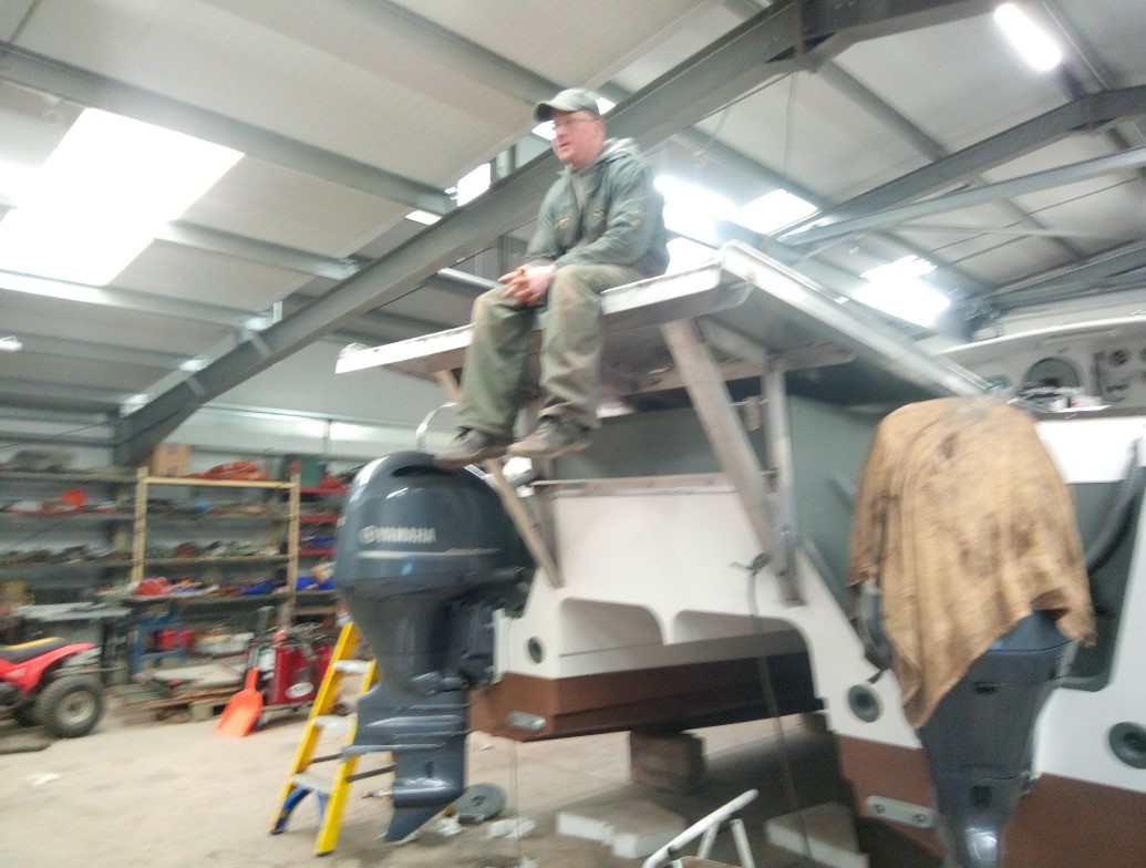

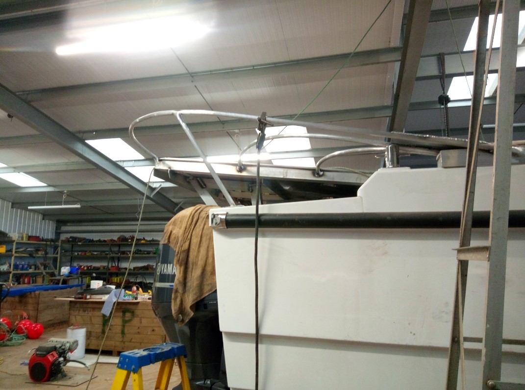

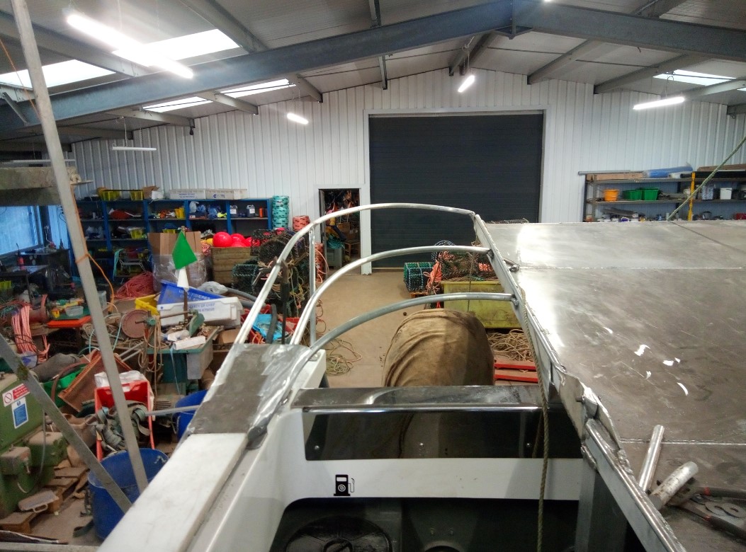

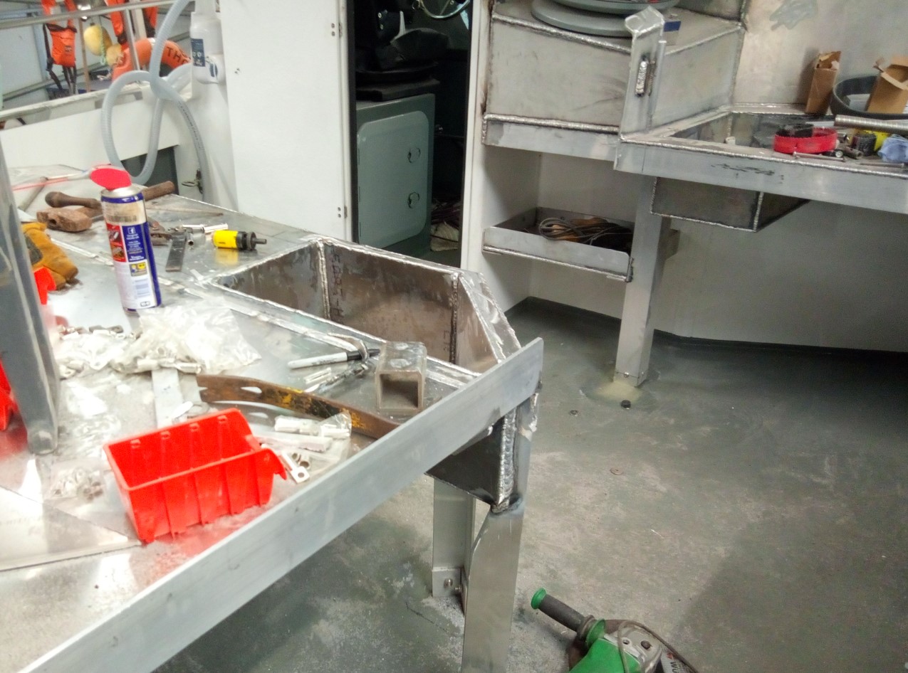

Bit more done yesterday and today. Yesterday was mainly boring holes through the stern box and working out how and measuring up for steering, today was bait box in the corner of the table. Had to cut the table legs as the skipper wanted it closer due to him having the table more aft than normal. The strength in the legs is still retained as the box is welded to them and probably actually adding strength.
Also got the rear section of the table welded up today, will weld on the hinges tomorrow and hopefully get the support frame made.
