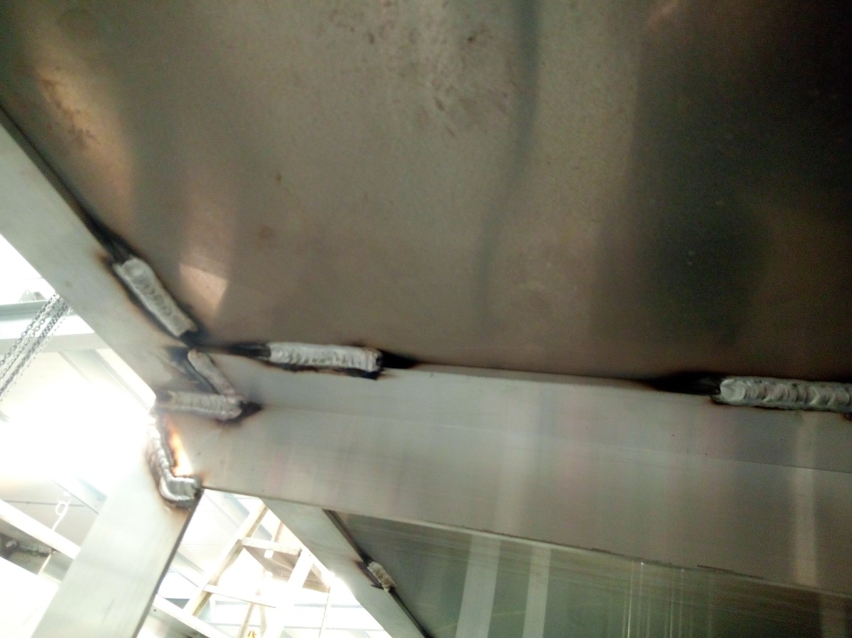

The heat affects it slightly but as there is very little oxygen it doesn't catch fire and just sort of melts it slightly before it again solidifies. If you remove the plate at a later date you see marks but no real damage.Do you weld that wheelhouse plating in sit-ups it looks? What about heat on the structure behind?

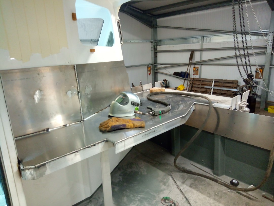

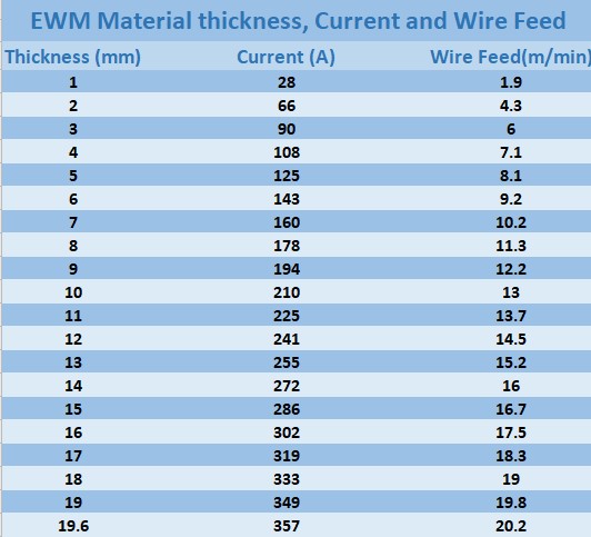

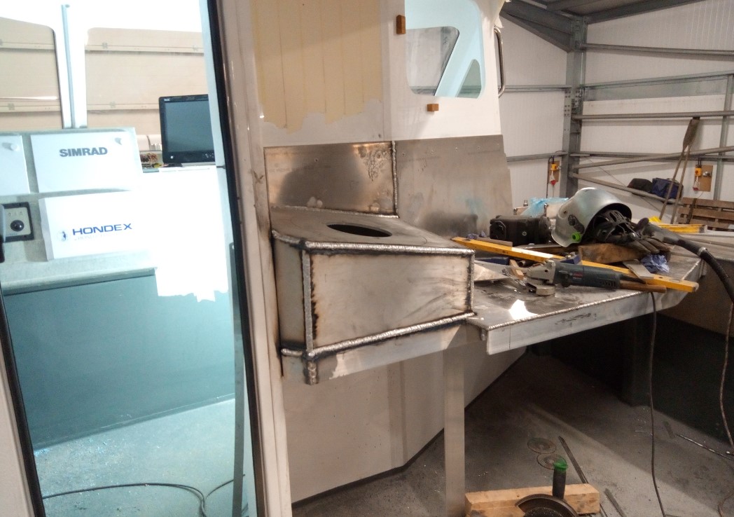

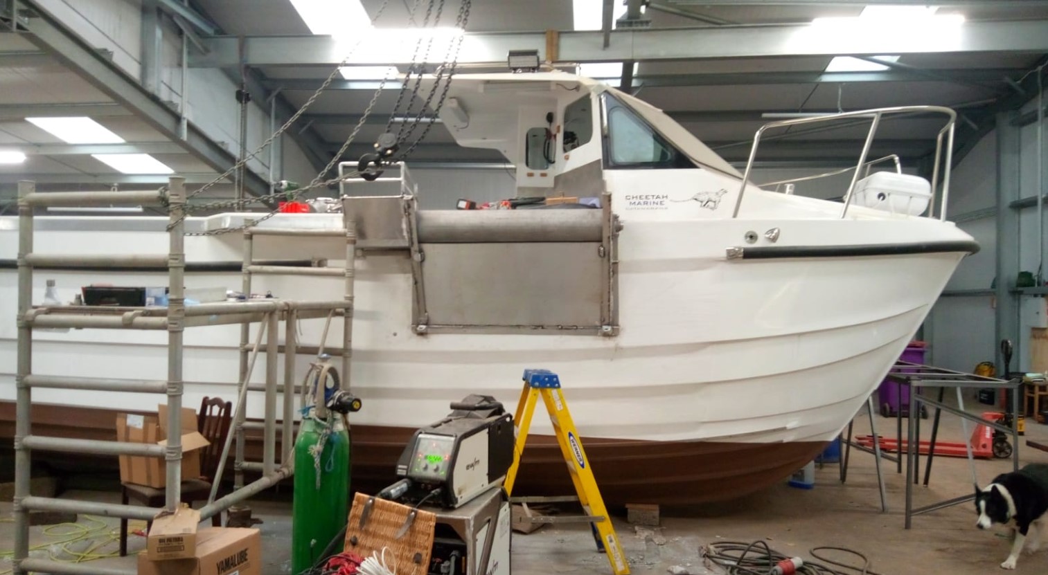

What sort of settings are you using for the mig welding? I had a play with my new hand spool tonight, I was up quite high on the mig settings, 230 plus amps I think (old Cebora transformer mig), the sound was changing from spitting to humming - I guess that's spray transfer? The problem is I have little control over wire speed, if I drop the dc volts the motor stalls, same with current. Maybe a pwm type speed controller might do it. Anyway, on 240 supply it was taking my 30A breaker out..Got the base plate for the hauler cut and two rectangular pieces as well which would be properly cut to the required angle once it was known.

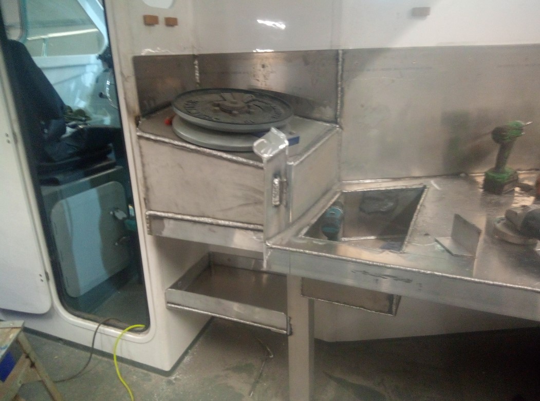

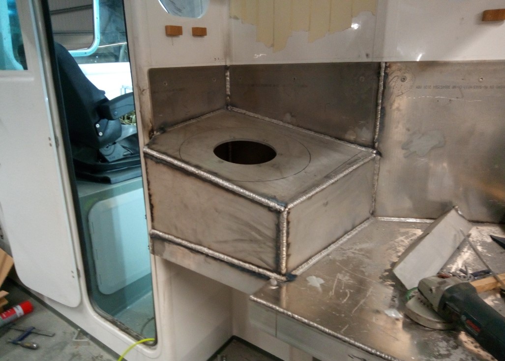

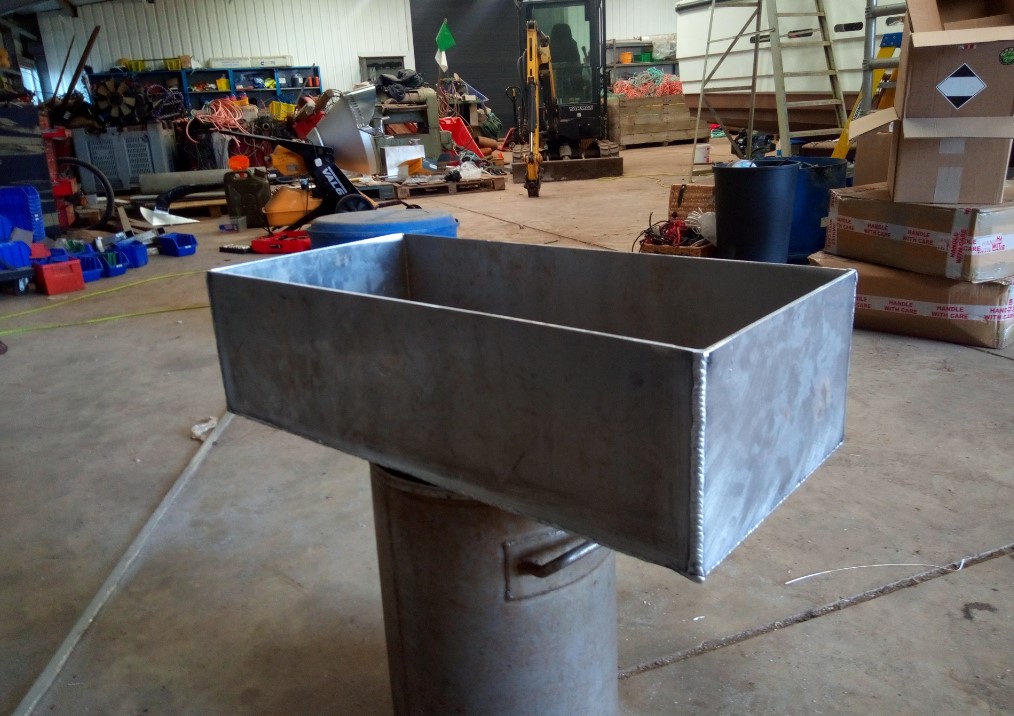

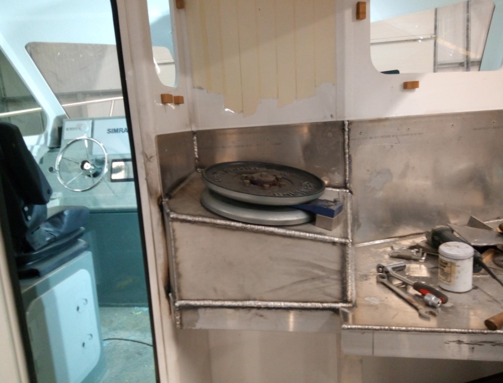

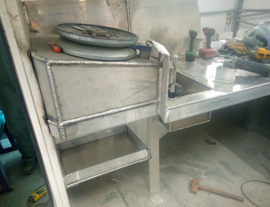

The hauler on this one is a 16" Seawinch and the design of them is not the easiest when getting the alignment of the hauler box worked out. The whole hauler has to be fully assembled and bolted to the base plate and it must weigh upwards of 40Kg and trying to balance that whilst moving and tilting to get the alignment for the rope correct is a real pain.
Eventually we got the angles right and that allowed me to remove the hauler and get the box welded up, the base plate is 600mm x 500mm x 8mm 5083 and the sides also 8mm 5083.
Box welded in.
View attachment 274339View attachment 274340

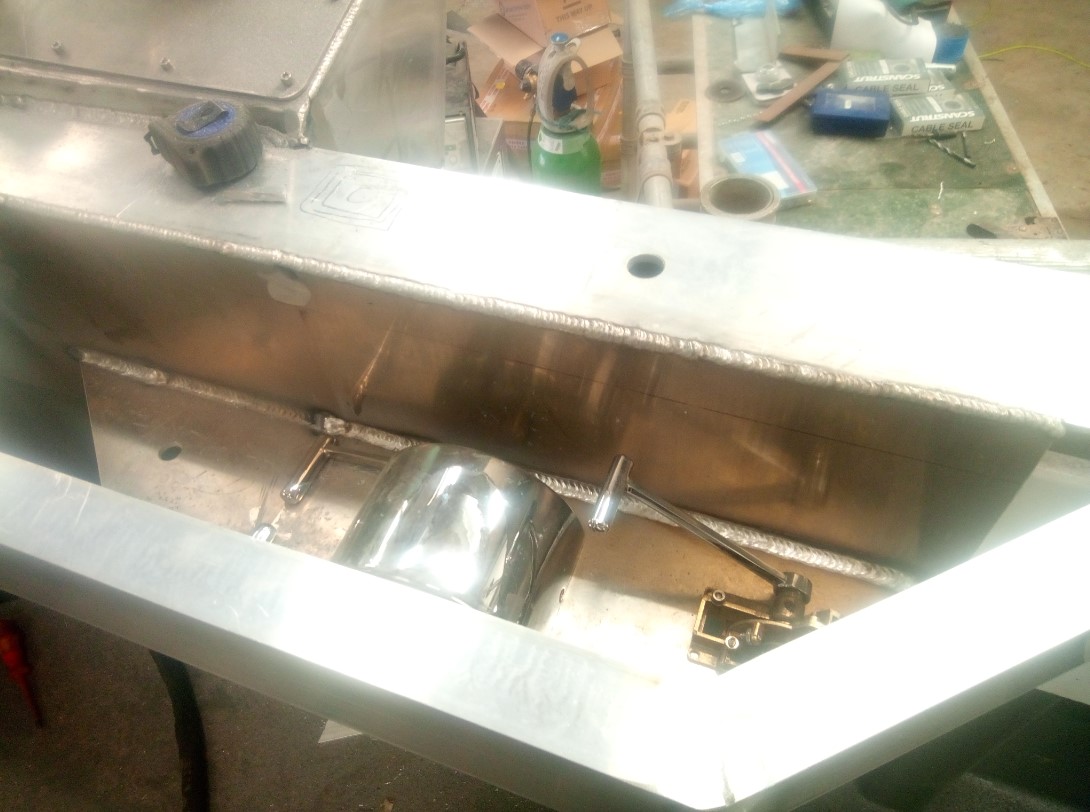

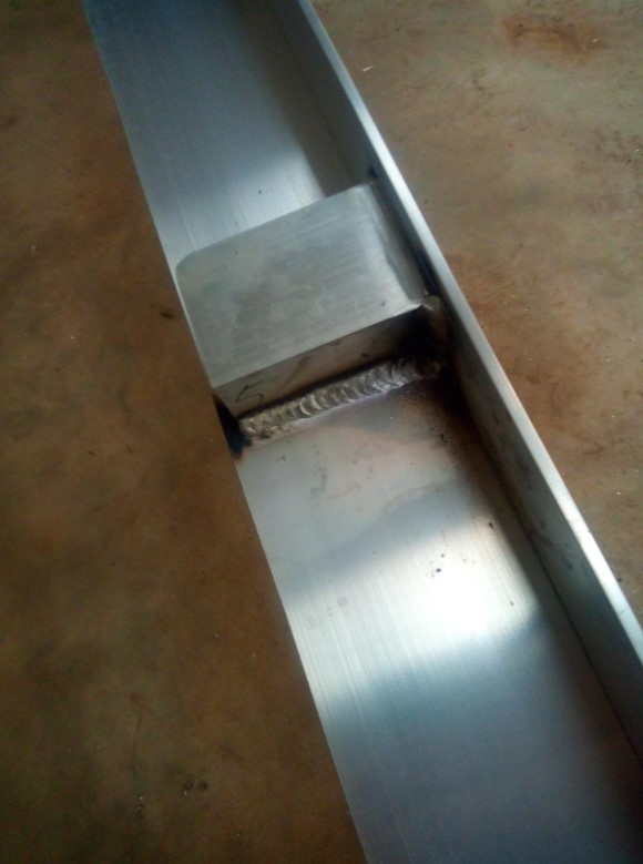

Hauler properly fitted but the ejector knife block is 2.5mm too high so I will have to skim that off before I can bolt that down.

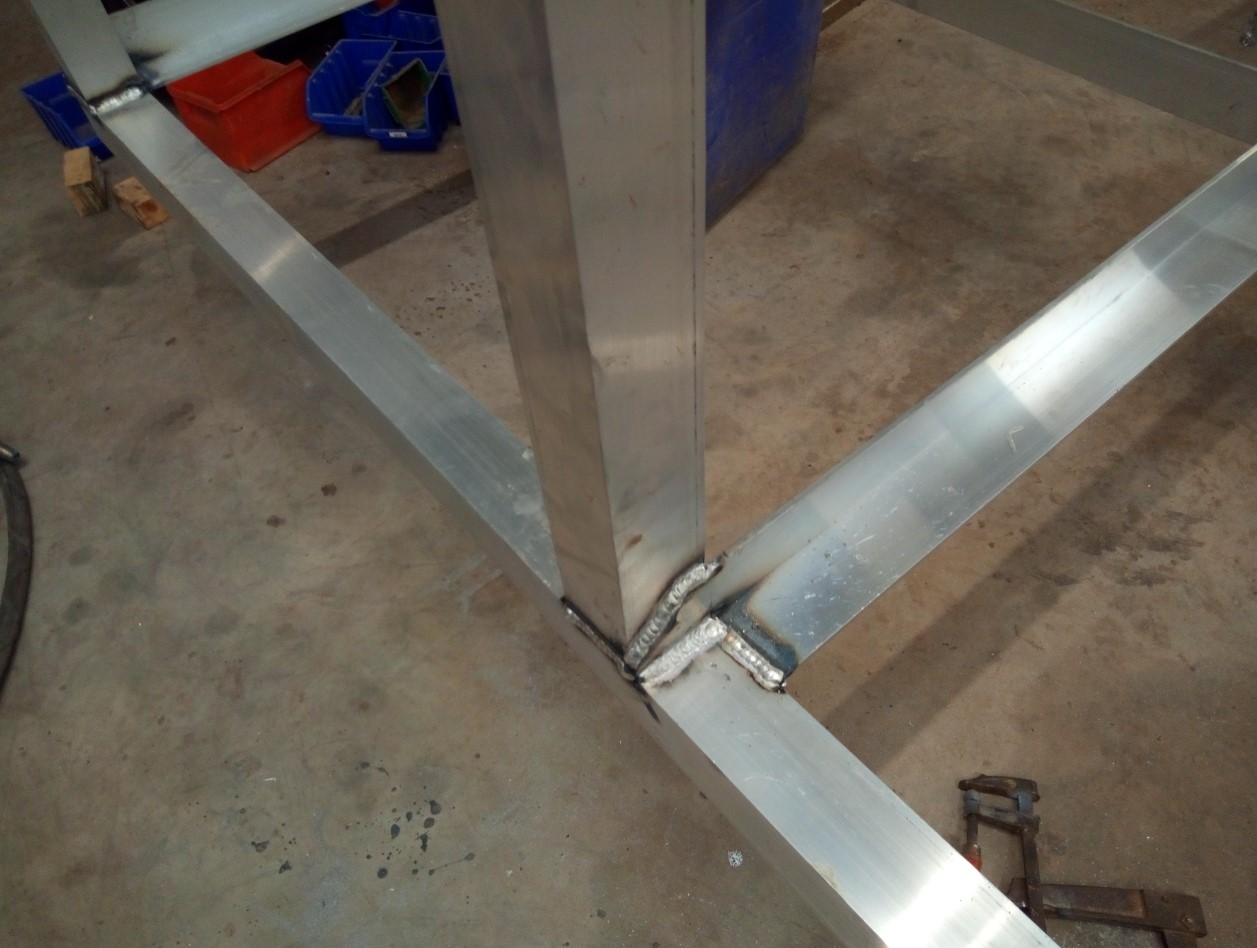

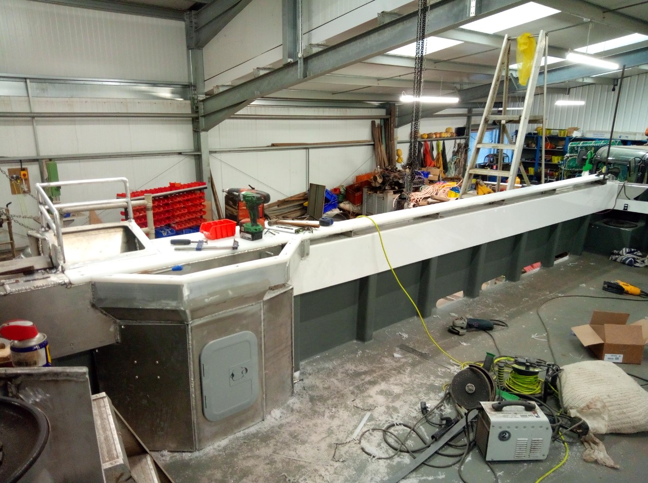

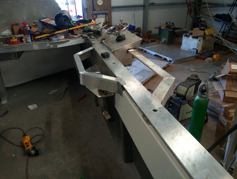

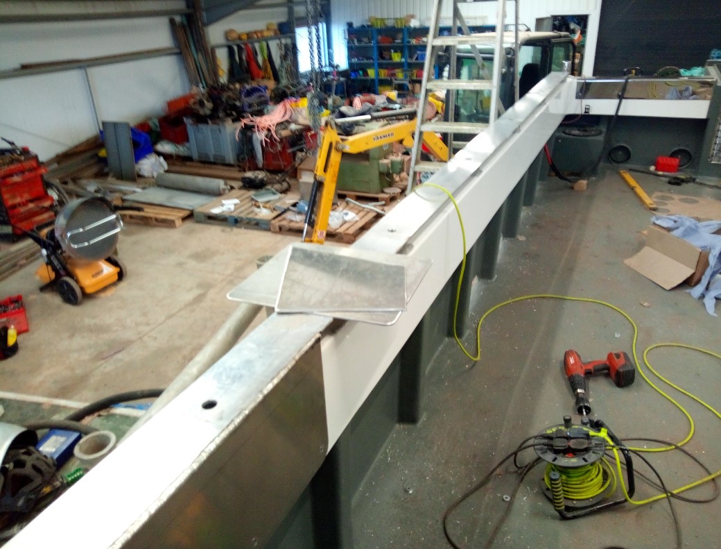

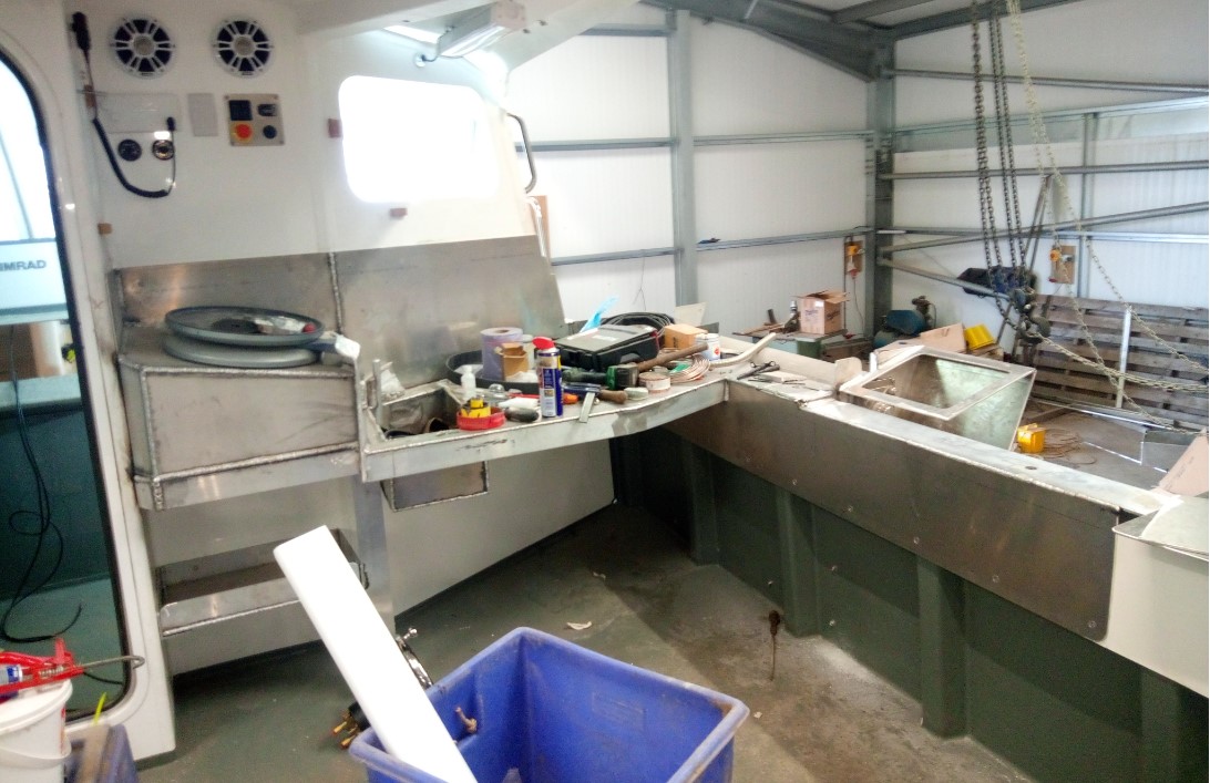

I like your lin bin cartSome more progress, vertical roller brackets welded on roller

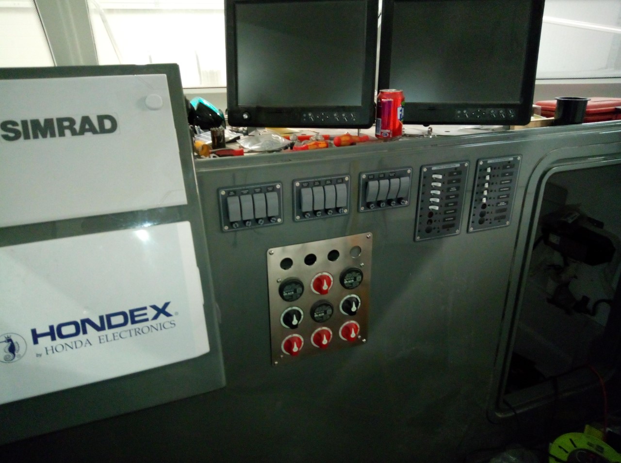

Secondary control box completed

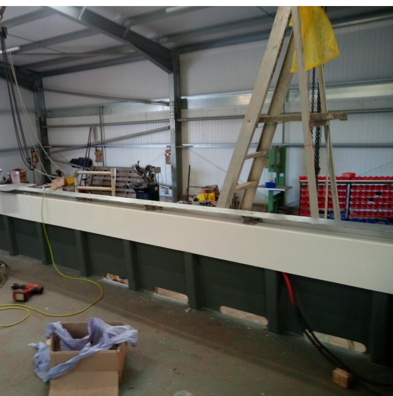

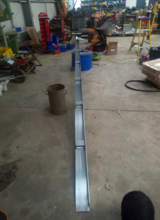

Gunwales capped in plastic
.View attachment 277511

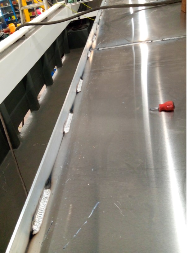

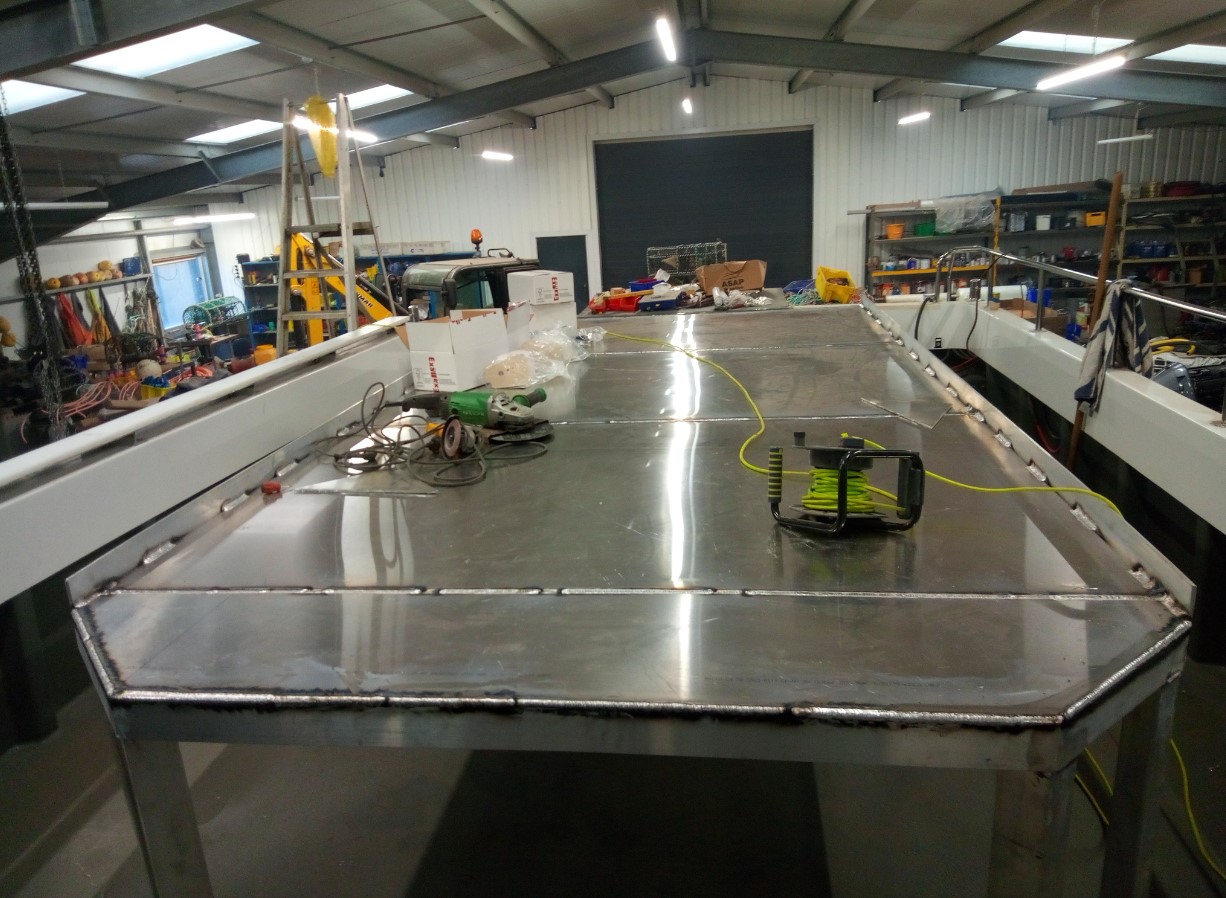

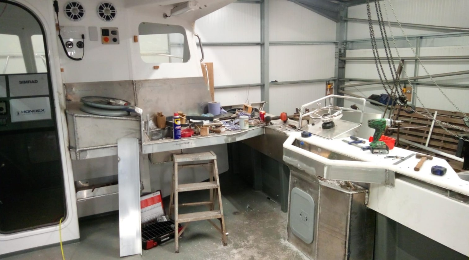

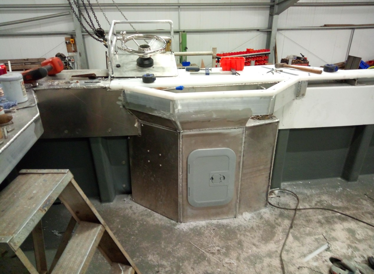

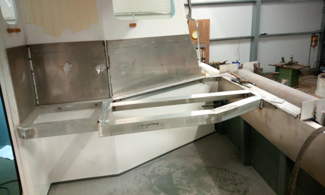

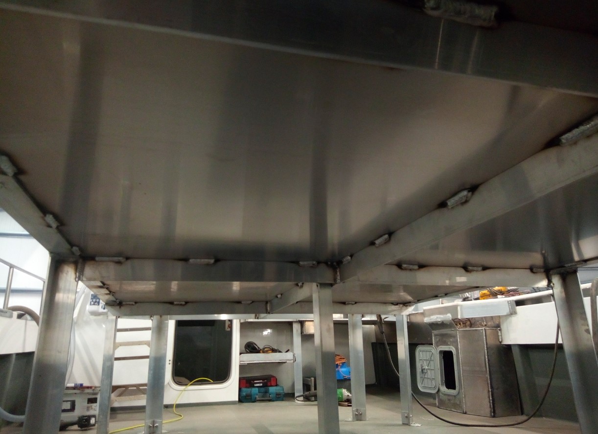

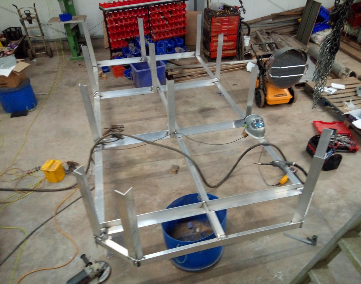

Main shooting table frame done, ready for lifting onto the boat and fixed in place.
All joints are checked into one another ta add strength and a flat surface on the opposite side for when the 5mm sheets are welded in place.

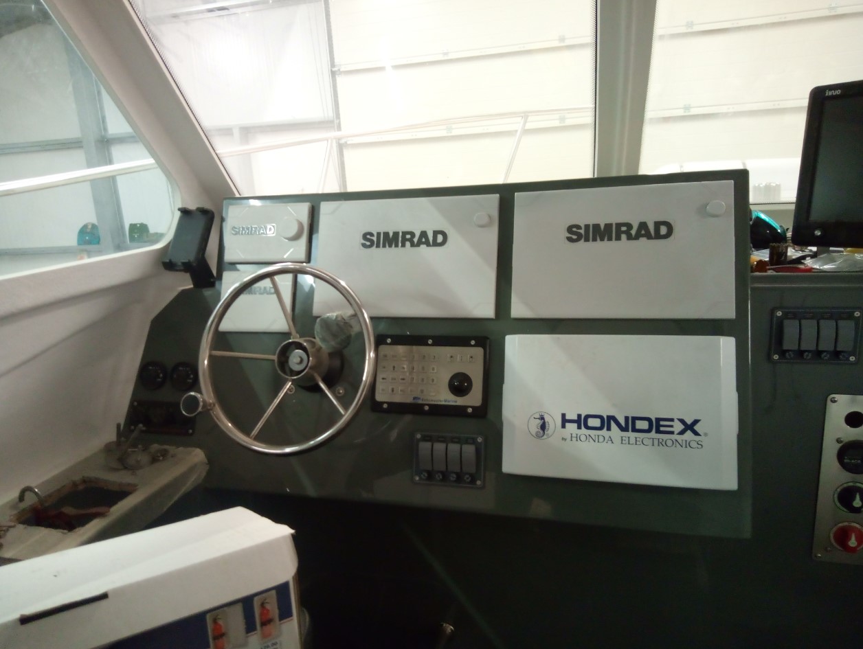

Skipper and his brother have been getting on with instruments and wiring.

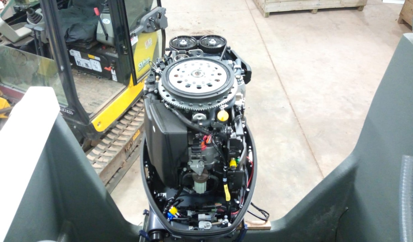

Engines will hopefully get properly fitted tomorrow so I can get on with making up the steering link rods.
View attachment 277518 View attachment 277510
Not mine, wish it was, full of stainless fastenersI like your lin bin cart
