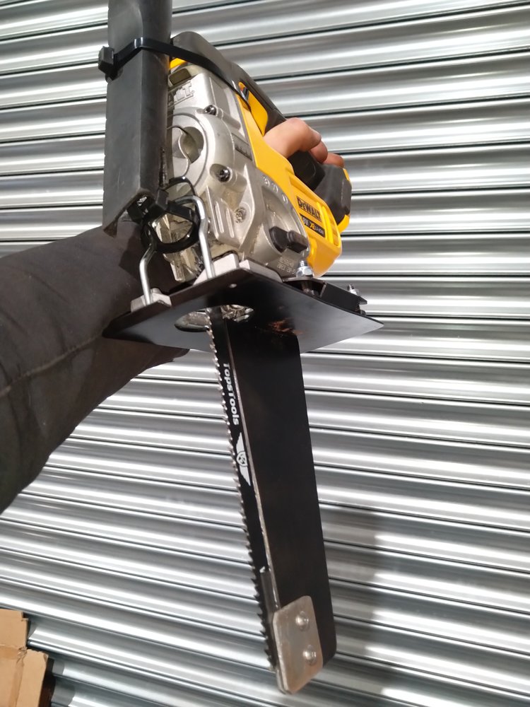

Would a more coarse blade not get a better cut!
That is about as course as you can get at 250mm.
Tbh the cut is sublime one vavummed off there no marks at all.

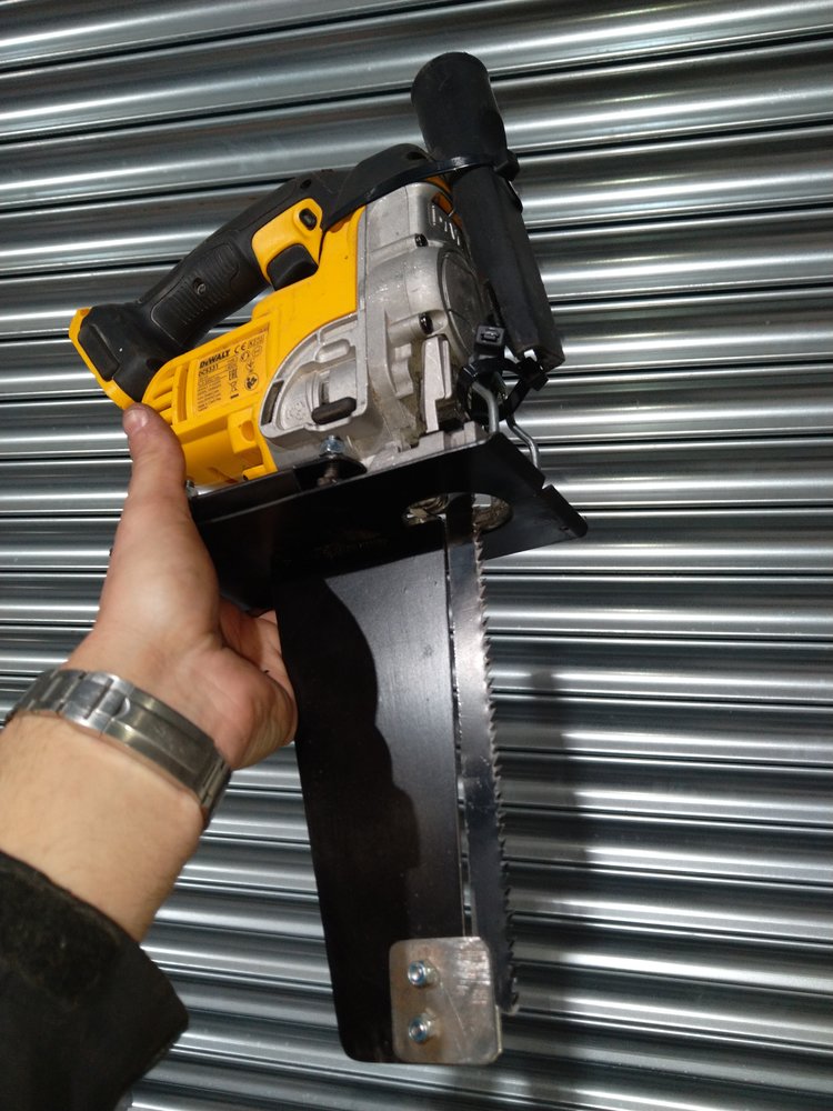

Great job mtt that’s a great bit of ingenuity. It’s very first world though!
Sorry I meant first world as in a very posh solution compared to my Stone Age bodging!Absolutely it is, I had planned to spend longer building it time didn't allow.
MK2 will be smarter.
a coarse blade gives off too much dust personally id rather use a diamond wheel and circular sawWould a more coarse blade not get a better cut!

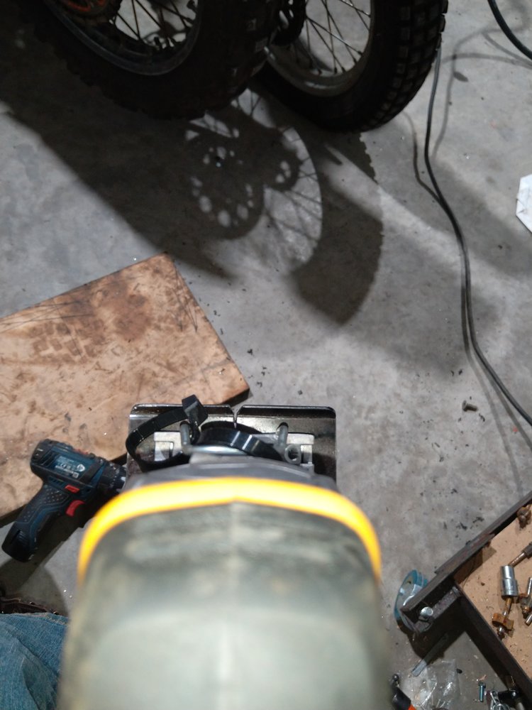

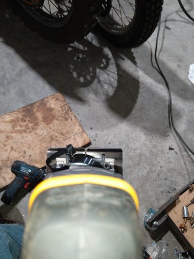

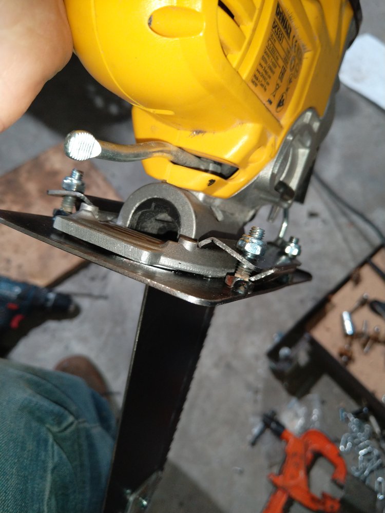

Am I correct in thinking that you have a modified sawzall blade mounted in a jigsaw, a riving knife welded to a plate screwed to to the jigsaw with a blade guide fitted at the bottom?
Depth sir deptha coarse blade gives off too much dust personally id rather use a diamond wheel and circular saw
